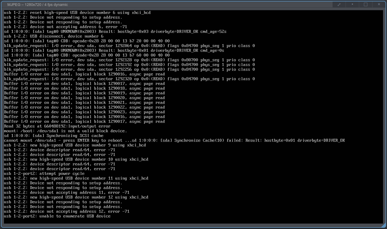

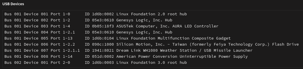

  14. Hi guys, since two weeks, I have issues with rebooting my unraid server (6.10.3). I have a pikvm connected to the server and it gives me some errors like "device descriptor read/64, error -71" "device not responding to setup address" "device not accepting address 12, error -71" "unable to enumerate USB device" (see picture) The boot process stops at the point of the first screenshot and does not proceed. The only thing I can do is a hard shutdown, plug the unraid USB drive in another USB port and boot it up. Then it boots normally. As you can see from the picture, USB device 1-2.2 is concerned, so I looked up in the GUI of unraid, what USB device relates to 1-2.2. The second picture shows, that the unraid flash drive itself seems to be the problem. From the google search for the "unable to enumerate USB device" I found, that either there is a problem with the kernel (probably less likely) or with the USB drive. The USB flash drive is a Samsung MUF-32BE4/EU BAR Plus 32 GB Typ-A USB 3.1 and is about one year old. For the motherboard I use a Asus Prime Z590-A Gaming and the case is a Fractal Design Define R6. So is my USB drive broken or is there any other explanation for this behavior? Thank you very much for your help! Maginos.

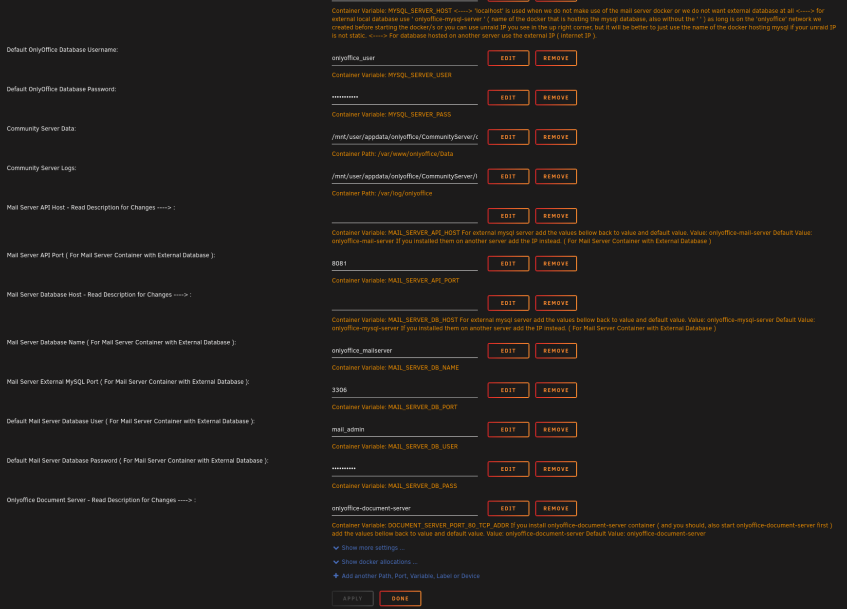

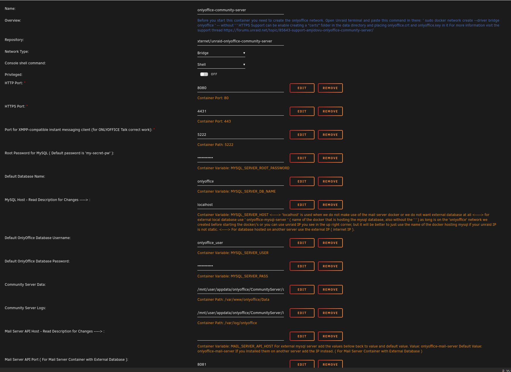

  23. Ok then, would you mind helping me with the setup of the community server (I don't need mail server)? Unfortunately, it doesn't work for me out of the box. Here's what I've done so far: - mariadb and onlyoffice document server installed and running without issues - downloaded and installed community server docker with the settings attached - on console of mariadb docker: mysql -uroot -p CREATE USER 'onlyoffice_user'@'localhost' IDENTIFIED BY 'password_from_me'; CREATE DATABASE IF NOT EXISTS onlyoffice CHARACTER SET utf8mb4 COLLATE utf8mb4_general_ci; GRANT ALL PRIVILEGES ON onlyoffice. * TO 'root'@'%' IDENTIFIED BY 'password_from_me'; GRANT ALL PRIVILEGES ON onlyoffice. * TO 'onlyoffice_user'@'%' IDENTIFIED BY 'password_from_me'; FLUSH PRIVILEGES; exit When I then start the Community Server docker, I get several Warnings and Errors in the logs, I list them here: Warning: rsyslogd: activation of module imklog failed [v8.32.0 try http://www.rsyslog.com/e/2145 ] Warning: start-stop-daemon: warning: failed to kill 96: No such process Error: /app/onlyoffice/run-community-server.sh: line 182: & 255 : syntax error: operand expected (error token is "& 255 ") Warning: mysql: [Warning] Using a password on the command line interface can be insecure. Error: ERROR 1045 (28000) at line 1: Access denied for user 'onlyoffice_user'@'localhost' (using password: YES) Warning: /etc/init.d/redis-server: 51: ulimit: error setting limit (Operation not permitted) They do not appear one after another, but they appear in this order in the log. The "mysql: [Warning] Using a password on the command line interface can be insecure." error occurs several times. After waiting for around 15 minutes, the webgui of community server still says, "please wait". Can you help me with this? Thank you very much in advance! Maginos
  24. I would like to use the Community Server with my already existing mariadb docker, which I use for a nextcloud instance. Is this possible?
