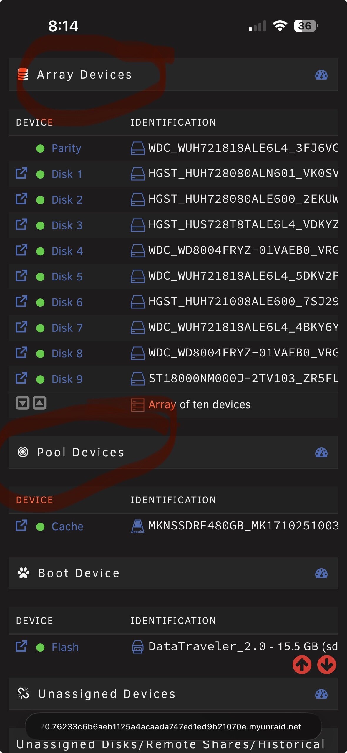

  1. At some point in the past I setup a 2 disk cache pool and then later removed one of the disks leaving a 1 disk cache pool. My OCD tells me that 1 disk doesn’t make a pool and I need to remove the pool without losing data on the cache drive. Is this possible? How? Or maybe I need to ignore my OCD.😁 brunnhilde-diagnostics-20251209-2120.zip

  3. No. The SMB network will see your shares (STORAGE, Movies, whatever you choose to name them). You can share the individual disks but it’s not recommended. Normally the only place you’ll see the disks is in the Unraid webUI and data will be spread across all disks in the array if you’re using the default settings so that you’ll wind up with a single apparent mapped location that equals the total of all the drives. Edit: single location for each share that is.
  4. Absolutely. And IMO an array is easier to work with but that’s just an opinion from someone who knows almost nothing about zfs.😁
  5. Unraid originally offered a parity protected array (a bunch of drives with parity protection). In the past couple of years it has also incorporated the ability to use zfs pools. You should see sections for both of these on the main tab. I believe either of these will work for you but you can see that I don’t use pools at all so I’m probably not the best source of info for that. A quick google search turned up this article.

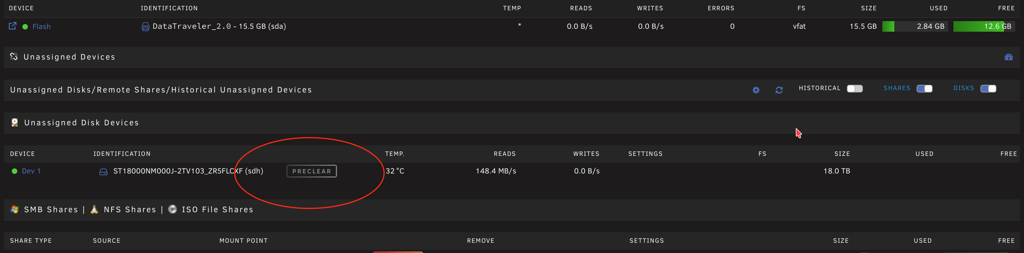

  14. There also doesn't seem to be a way to follow preclear progress. It's been a while since I last used preclear but isn't this supposed to link to a progress window? Preclear should be running but I can't open the window.
