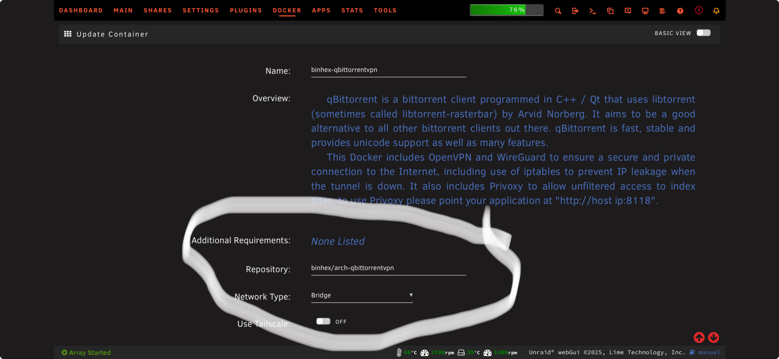

- [Support] binhex - qBittorrentVPN
You append a colon and tag number to the text already in the repository field. You can get the tag numbers here.- [Support] binhex - qBittorrentVPN
