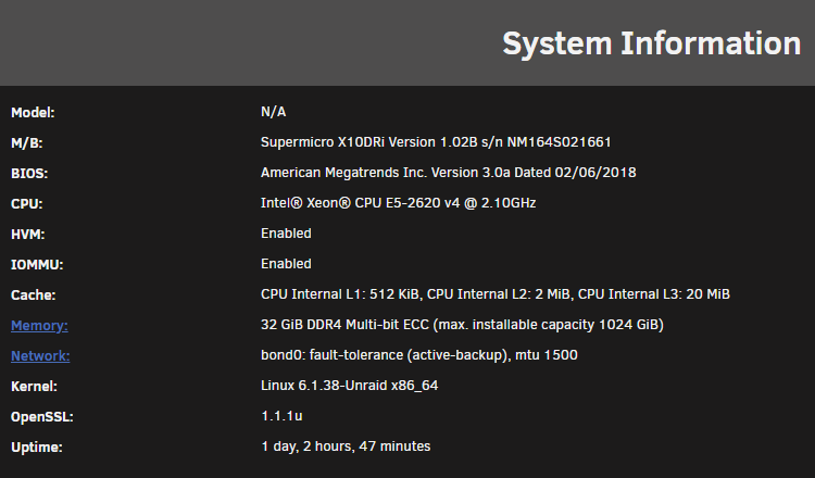

  7. I disabled bond, updated BIOS aswell and saw that SpeedStep was inactivated already, tried to activate it instead, made no difference. Wrote in V-Risings discord and they believe it might be some firewall issue, but I don't see how it would be.

  10. See attached screenshots for machine specs and a dump of install. Nope I did not pin any cores, should I do that you think? Thanks for trying, very strange this one...

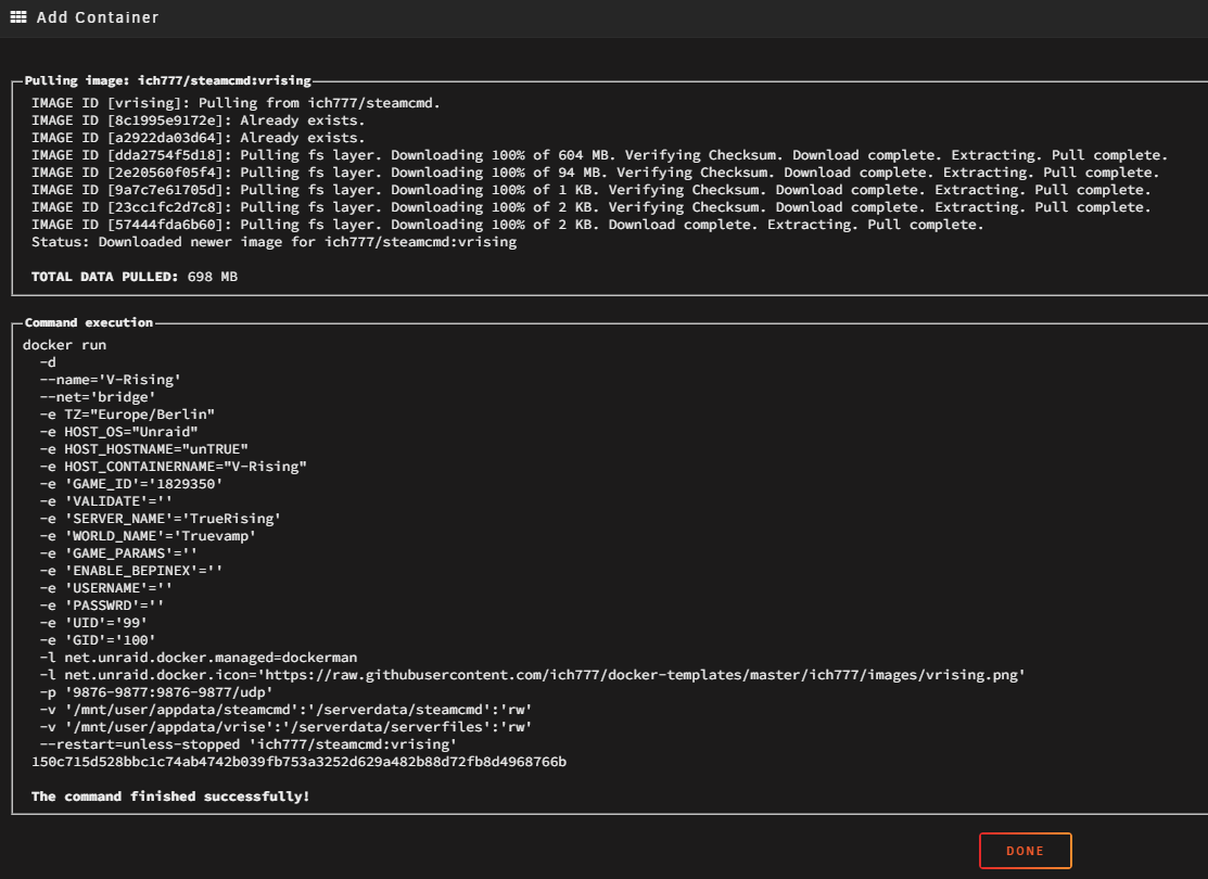

  11. I set a new name for serverdata/serverfiles and it downloaded the vrising game files yet again and I waited for it to boot up. My friend could join but only for like 1 min, he could create a character but then after 10 sec in game got disconnected and met with AuthenticationError, then everytime he tries to connect it's the same error. I post the serverlog in the attachment on this reply. Getting alot of strange SteamCMD errors such as "thread starvation" etc.. VRisingServer.log

  13. Thanks @ich777 I even tried renaming both SteamCMD folder and vrising folder so the Docker would redownload everything from scratch, but that did not solve it unfortunately. Running the V Rising Dedicated Server from Steam on my main Windows 11 PC works. So my spontaneus guess is that it has something todo with Linux SteamCMD, but I don't know. Please report back when you can, add me on Discord if you like to troubleshoot together. #truetype @ discord.

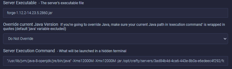

  16. If someone else had struggles with this, as I, I just got it working with the setting "Do not override" and just enter in my case: ""/usr/lib/jvm/java-8-openjdk/jre/bin/java" -Xms12000M -Xmx12000M -jar /opt/crafty/servers/3ad84b4d-4ca6-443e-8b0a-e6edeec4f292/forge-1.12.2-14.23.5.2860.jar nogui" Into the server execution command. Then it worked.
