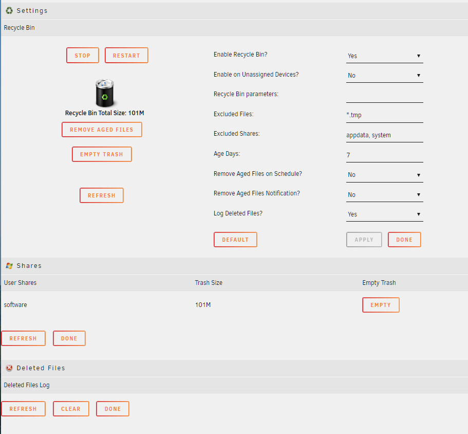

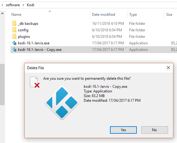

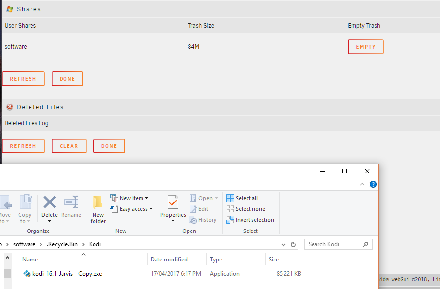

Understand. Lets start from the top, I've cleared the log and excluded the games share that was pumping the steam cache entries. Here a run through of deleting a file: Initial state Created file to delete, then deleted Share appears, no delete file log, .Recycle.Bin directory and deleted file appears Emptied recycle bin, still no deleted file logged .Recycle.Bin directory + contents and GUI reference to share disappear as expected Output of cat /var/log/samba/log.smbd [2018/11/17 08:30:23.832866, 0] ../source3/modules/vfs_extd_audit.c:159(audit_mkdir) vfs_extd_audit: mkdir /mnt/user/software/.Recycle.Bin [2018/11/17 08:30:23.833067, 0] ../source3/modules/vfs_extd_audit.c:159(audit_mkdir) vfs_extd_audit: mkdir /mnt/user/software/.Recycle.Bin/Kodi

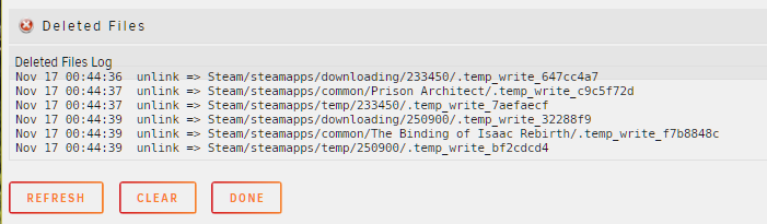

OK looking at the log (below) I found entries related to folders (of deleted files) are visible (Kodi, IrfanView) but files themselves are not. In between now and then some other recycle bin activities have occurred and some files went to recycle bin, other temp type files were deleted outright and these did show up in GUI log. It seems the samba log is including records we're less interested in logging, and excluding what we are interested in? cat /var/log/samba/log.smbd output: [2018/11/16 16:10:26.798241, 0] ../source3/modules/vfs_extd_audit.c:159(audit_mkdir) vfs_extd_audit: mkdir /mnt/user/software/.Recycle.Bin [2018/11/16 16:10:26.798478, 0] ../source3/modules/vfs_extd_audit.c:159(audit_mkdir) vfs_extd_audit: mkdir /mnt/user/software/.Recycle.Bin/Kodi [2018/11/16 16:10:30.227792, 0] ../source3/modules/vfs_extd_audit.c:159(audit_mkdir) vfs_extd_audit: mkdir Kodi/_db backups/.tmp [2018/11/16 16:10:30.230186, 0] ../source3/modules/vfs_extd_audit.c:180(audit_rmdir) vfs_extd_audit: rmdir Kodi/_db backups/.tmp [2018/11/16 16:15:22.667634, 0] ../lib/util/become_daemon.c:138(daemon_ready) daemon_ready: STATUS=daemon 'smbd' finished starting up and ready to serve connections [2018/11/16 16:15:52.150000, 0] ../source3/modules/vfs_extd_audit.c:159(audit_mkdir) vfs_extd_audit: mkdir /mnt/user/software/.Recycle.Bin/IrfanView [2018/11/16 16:20:38.684070, 0] ../lib/util/become_daemon.c:138(daemon_ready) daemon_ready: STATUS=daemon 'smbd' finished starting up and ready to serve connections [2018/11/17 00:44:27.116724, 0] ../source3/modules/vfs_extd_audit.c:159(audit_mkdir) vfs_extd_audit: mkdir /mnt/user/tjb/.Recycle.Bin [2018/11/17 00:44:27.116957, 0] ../source3/modules/vfs_extd_audit.c:159(audit_mkdir) vfs_extd_audit: mkdir /mnt/user/tjb/.Recycle.Bin/documents [2018/11/17 00:44:27.117170, 0] ../source3/modules/vfs_extd_audit.c:159(audit_mkdir) vfs_extd_audit: mkdir /mnt/user/tjb/.Recycle.Bin/documents/home [2018/11/17 00:44:27.117358, 0] ../source3/modules/vfs_extd_audit.c:159(audit_mkdir) vfs_extd_audit: mkdir /mnt/user/tjb/.Recycle.Bin/documents/home/iTunes [2018/11/17 00:44:36.969299, 0] ../source3/modules/vfs_extd_audit.c:159(audit_mkdir) vfs_extd_audit: mkdir Steam/steamapps/downloading/233450 [2018/11/17 00:44:36.988766, 0] ../source3/modules/vfs_extd_audit.c:268(audit_unlink) vfs_extd_audit: unlink Steam/steamapps/downloading/233450/.temp_write_647cc4a7 [2018/11/17 00:44:37.543853, 0] ../source3/modules/vfs_extd_audit.c:268(audit_unlink) vfs_extd_audit: unlink Steam/steamapps/common/Prison Architect/.temp_write_c9c5f72d [2018/11/17 00:44:37.549194, 0] ../source3/modules/vfs_extd_audit.c:159(audit_mkdir) vfs_extd_audit: mkdir Steam/steamapps/temp/233450 [2018/11/17 00:44:37.566873, 0] ../source3/modules/vfs_extd_audit.c:268(audit_unlink) vfs_extd_audit: unlink Steam/steamapps/temp/233450/.temp_write_7aefaecf [2018/11/17 00:44:39.626607, 0] ../source3/modules/vfs_extd_audit.c:159(audit_mkdir) vfs_extd_audit: mkdir Steam/steamapps/downloading/233450/steam_shader_cache [2018/11/17 00:44:39.755794, 0] ../source3/modules/vfs_extd_audit.c:159(audit_mkdir) vfs_extd_audit: mkdir Steam/steamapps/temp/233450/steam_shader_cache [2018/11/17 00:44:39.821349, 0] ../source3/modules/vfs_extd_audit.c:159(audit_mkdir) vfs_extd_audit: mkdir /mnt/user/games/.Recycle.Bin [2018/11/17 00:44:39.821560, 0] ../source3/modules/vfs_extd_audit.c:159(audit_mkdir) vfs_extd_audit: mkdir /mnt/user/games/.Recycle.Bin/Steam [2018/11/17 00:44:39.821740, 0] ../source3/modules/vfs_extd_audit.c:159(audit_mkdir) vfs_extd_audit: mkdir /mnt/user/games/.Recycle.Bin/Steam/steamapps [2018/11/17 00:44:39.821929, 0] ../source3/modules/vfs_extd_audit.c:159(audit_mkdir) vfs_extd_audit: mkdir /mnt/user/games/.Recycle.Bin/Steam/steamapps/temp [2018/11/17 00:44:39.822136, 0] ../source3/modules/vfs_extd_audit.c:159(audit_mkdir) vfs_extd_audit: mkdir /mnt/user/games/.Recycle.Bin/Steam/steamapps/temp/233450 [2018/11/17 00:44:39.822328, 0] ../source3/modules/vfs_extd_audit.c:159(audit_mkdir) vfs_extd_audit: mkdir /mnt/user/games/.Recycle.Bin/Steam/steamapps/temp/233450/steam_shader_cache [2018/11/17 00:44:39.825014, 0] ../source3/modules/vfs_extd_audit.c:180(audit_rmdir) vfs_extd_audit: rmdir Steam/steamapps/temp/233450/steam_shader_cache [2018/11/17 00:44:39.827131, 0] ../source3/modules/vfs_extd_audit.c:180(audit_rmdir) vfs_extd_audit: rmdir Steam/steamapps/temp/233450 [2018/11/17 00:44:39.833493, 0] ../source3/modules/vfs_extd_audit.c:180(audit_rmdir) vfs_extd_audit: rmdir Steam/steamapps/downloading/233450/steam_shader_cache [2018/11/17 00:44:39.839589, 0] ../source3/modules/vfs_extd_audit.c:180(audit_rmdir) vfs_extd_audit: rmdir Steam/steamapps/downloading/233450 [2018/11/17 00:44:39.848790, 0] ../source3/modules/vfs_extd_audit.c:159(audit_mkdir) vfs_extd_audit: mkdir /mnt/user/games/.Recycle.Bin/Steam/steamapps/downloading [2018/11/17 00:44:39.914053, 0] ../source3/modules/vfs_extd_audit.c:159(audit_mkdir) vfs_extd_audit: mkdir Steam/steamapps/downloading/250900 [2018/11/17 00:44:39.925227, 0] ../source3/modules/vfs_extd_audit.c:268(audit_unlink) vfs_extd_audit: unlink Steam/steamapps/downloading/250900/.temp_write_32288f9 [2018/11/17 00:44:39.938174, 0] ../source3/modules/vfs_extd_audit.c:268(audit_unlink) vfs_extd_audit: unlink Steam/steamapps/common/The Binding of Isaac Rebirth/.temp_write_f7b8848c [2018/11/17 00:44:39.940705, 0] ../source3/modules/vfs_extd_audit.c:159(audit_mkdir) vfs_extd_audit: mkdir Steam/steamapps/temp/250900 [2018/11/17 00:44:39.954151, 0] ../source3/modules/vfs_extd_audit.c:268(audit_unlink) vfs_extd_audit: unlink Steam/steamapps/temp/250900/.temp_write_bf2cdcd4 [2018/11/17 00:44:41.248923, 0] ../source3/modules/vfs_extd_audit.c:159(audit_mkdir) vfs_extd_audit: mkdir Steam/steamapps/downloading/250900/steam_shader_cache [2018/11/17 00:44:41.375309, 0] ../source3/modules/vfs_extd_audit.c:159(audit_mkdir) vfs_extd_audit: mkdir Steam/steamapps/temp/250900/steam_shader_cache [2018/11/17 00:44:41.433327, 0] ../source3/modules/vfs_extd_audit.c:159(audit_mkdir) vfs_extd_audit: mkdir /mnt/user/games/.Recycle.Bin/Steam/steamapps/temp/250900 [2018/11/17 00:44:41.433567, 0] ../source3/modules/vfs_extd_audit.c:159(audit_mkdir) vfs_extd_audit: mkdir /mnt/user/games/.Recycle.Bin/Steam/steamapps/temp/250900/steam_shader_cache [2018/11/17 00:44:41.436687, 0] ../source3/modules/vfs_extd_audit.c:180(audit_rmdir) vfs_extd_audit: rmdir Steam/steamapps/temp/250900/steam_shader_cache [2018/11/17 00:44:41.439915, 0] ../source3/modules/vfs_extd_audit.c:180(audit_rmdir) vfs_extd_audit: rmdir Steam/steamapps/temp/250900 [2018/11/17 00:44:41.445601, 0] ../source3/modules/vfs_extd_audit.c:180(audit_rmdir) vfs_extd_audit: rmdir Steam/steamapps/downloading/250900/steam_shader_cache [2018/11/17 00:44:41.448777, 0] ../source3/modules/vfs_extd_audit.c:180(audit_rmdir) vfs_extd_audit: rmdir Steam/steamapps/downloading/250900

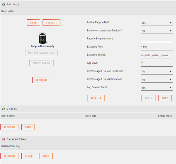

Virgin install on 6.6.5, recycle bin functionality works perfect as far as I can tell after running a few delete + empty tests, but the deleted file logging isn't coming up (yes it's enabled). Screenshot of settings below, let me know if it's anything I've missed? Thanks
