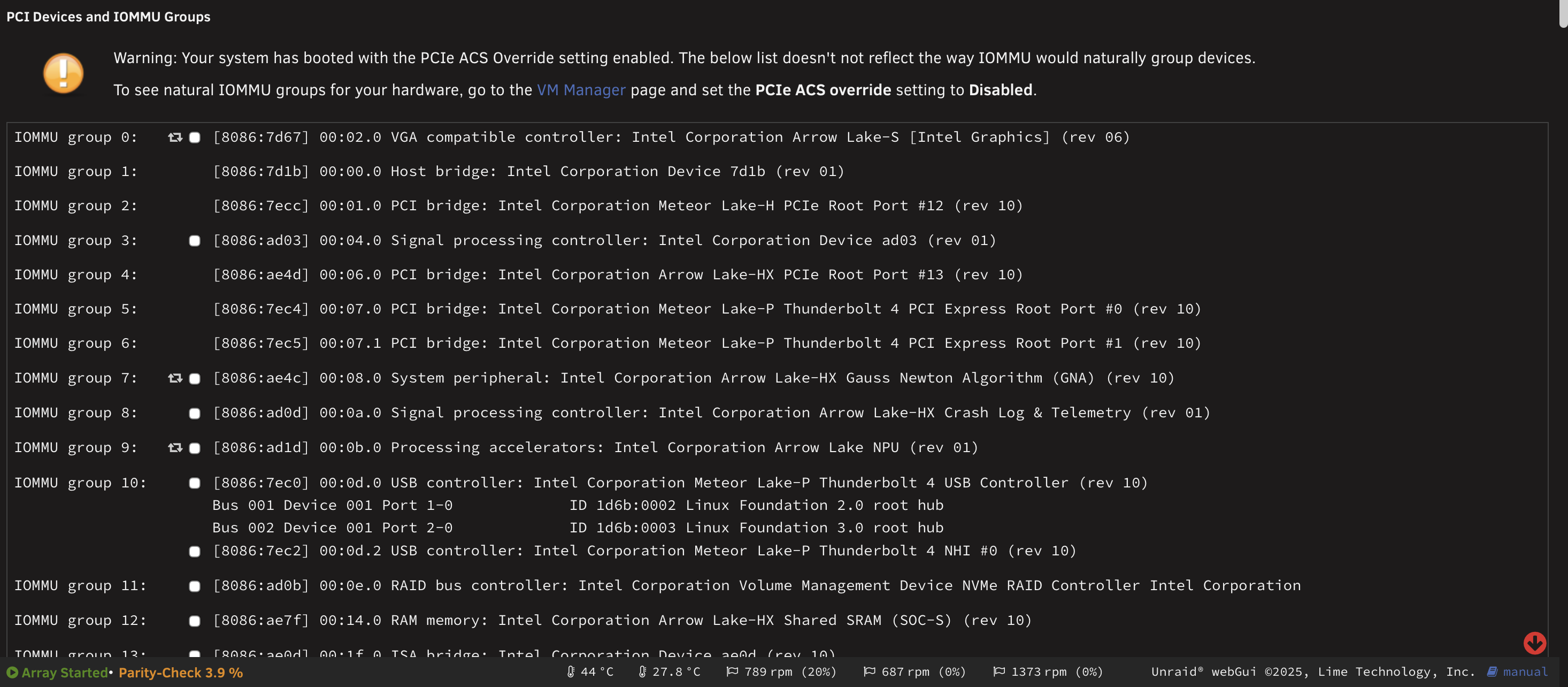

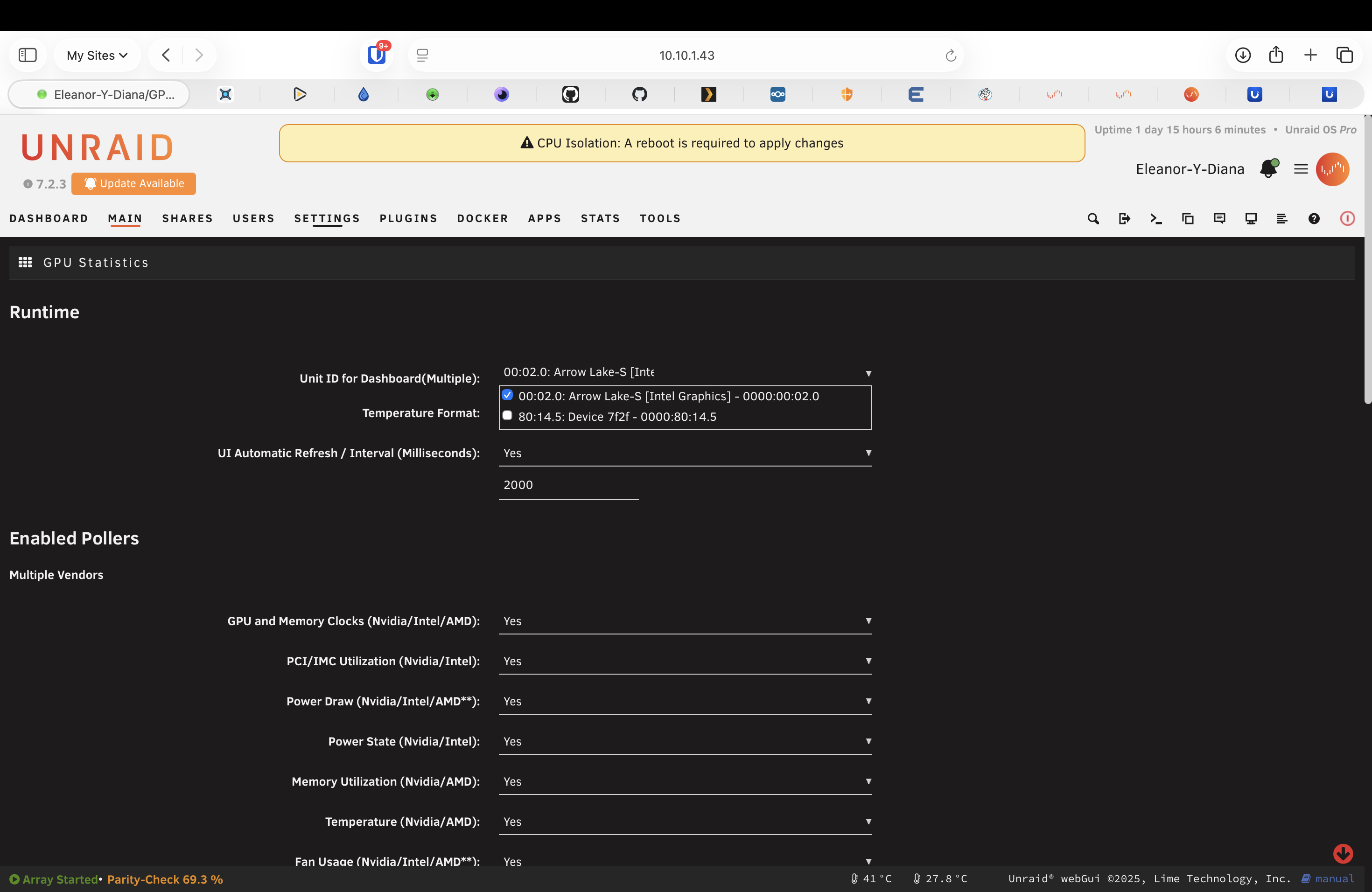

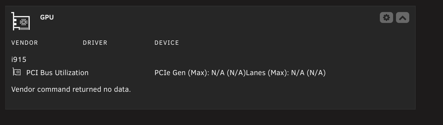

  3. Good morning Folks, I got a new Intel 7 265K iGPU and I cannot get it to work on plex or even show up in the dashboard. I have installed "Intel Graphics SR-IOV", "GPU Statistics", and "Intel GPU TOP". I had a Nvidia plugin and an AMD card but I have removed both of them and also removed the plugin for Nvidia. However, I can get the iGPU to work and show up correctly in GOU statistics, see screenshot below. Can someone please help me figure out why /dev/dvi/ does not exist and how to get it to work with other containers like Plex. I know I have to use Extra Parameters in the container but I can't as the container does not starts and fails. Any help is greatly appreciated. " eleanor-y-diana-diagnostics-20260310-0836.zip

  10. I just did that. Thank you. Does this matter? Maybe intel is not loaded because of the blacklist? I don't know, I don't remember ever placing that there. cat /boot/config/modprobe.d/i915.conf blacklist i915

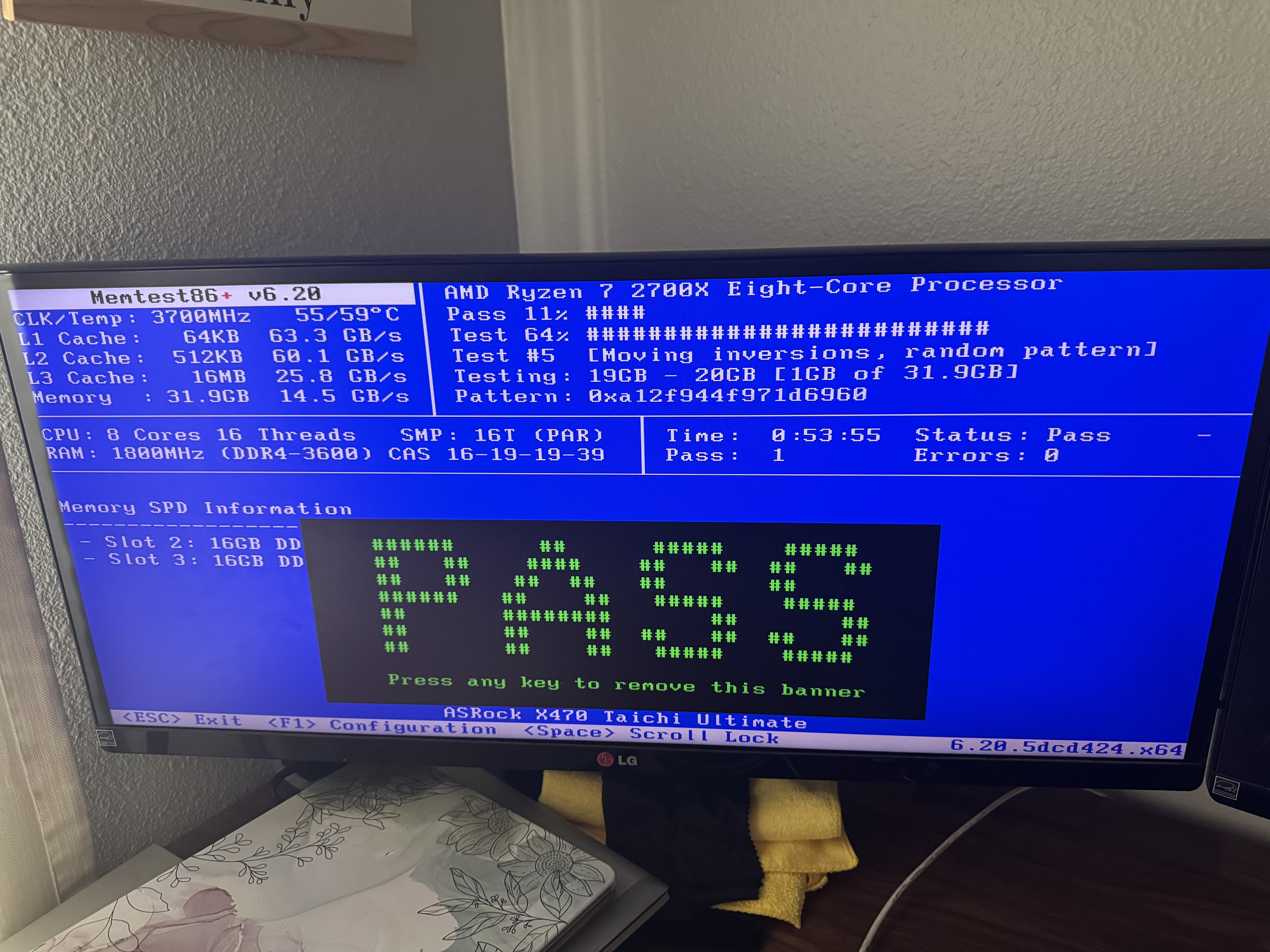

  16. I just finished testing all 4 RAM sticks and the server keeps crashing. I bought an intel 7 265x and hopefully it stops happening. A little upgrade from my current setup. Since I am switching from one platform to another, do I need to do anything in unraid since I am going to a different platform?

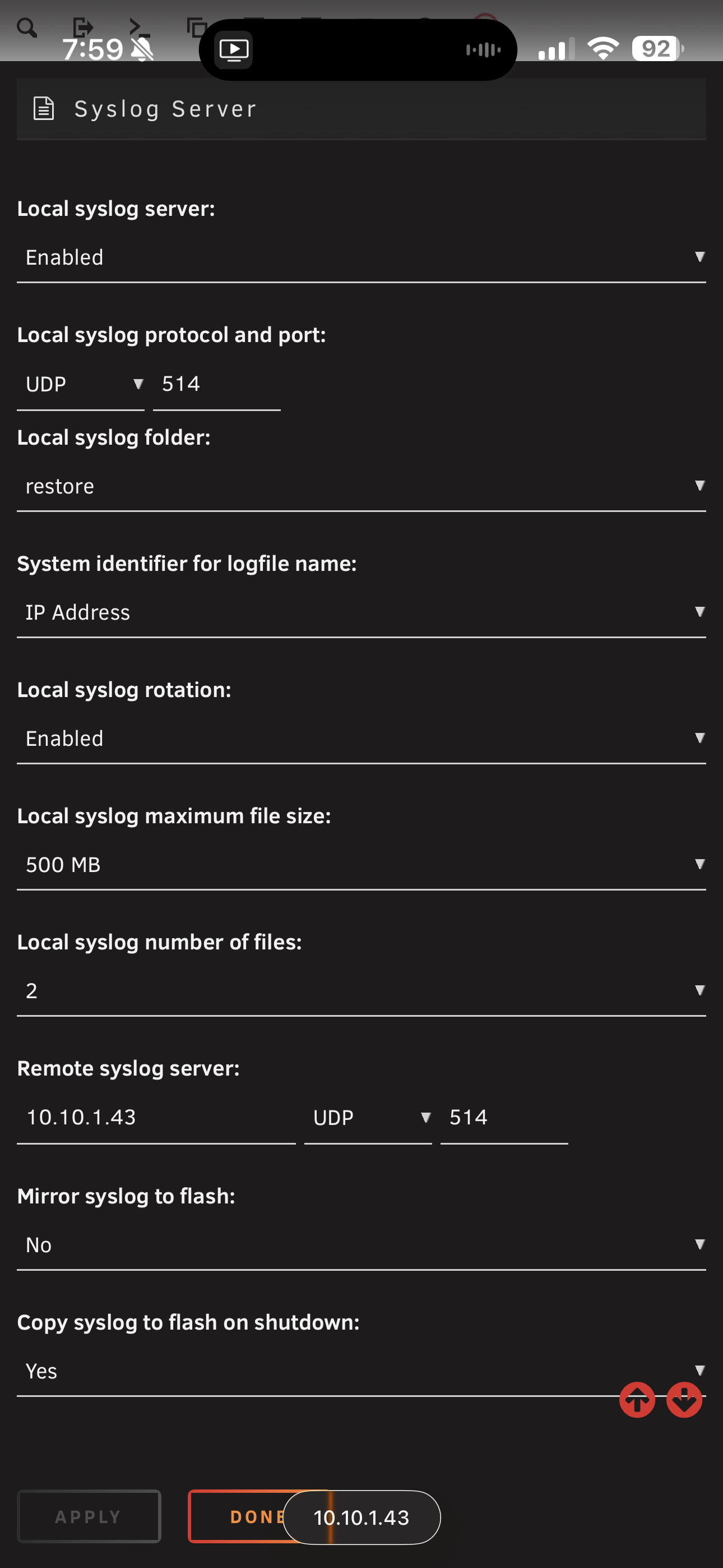

  19. It just crashed again. Here is the before downgrading to 7.2.3. I also included the syslog that is on the share. I took off mirroring to the flash drive so it does not kill the USB and add it to a share. tower-diagnostics-20260226-1110.zip syslog-share.zip
  20. I had already enabled syslog to go to the USB flash drive. Here is the new support file. The old one did not have the syslog server enabled. I did do it and should be on this support file. tower-diagnostics-20260226-0723.zip

  23. I am doing an Memtest86+ see if I get anything.
