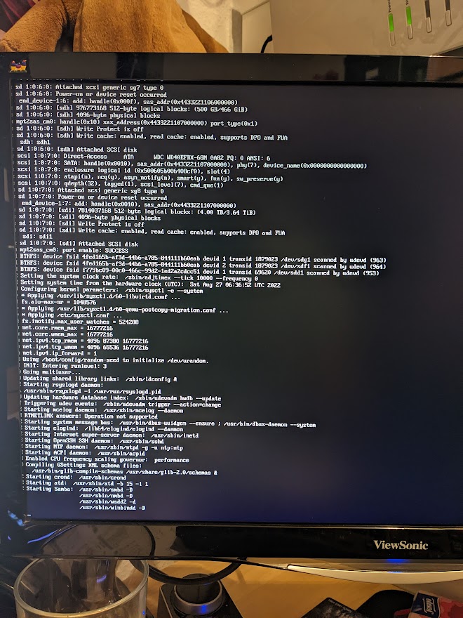

Doesnt look like. i removed and added plugins the last 4 hours... @ich777 gived me a hint deleting the vfio.conf all plugin added with vfio.conf -> crash removed all plugins with vfio.conf -> run ... BUT if i open the "system device" page -> crash all plugins added without vfio.conf -> run when i create i new vfio binding and reboot, the system will crash with plugins, or if i removed plugins before it will crash, when i open the "system device" page. will that help you?

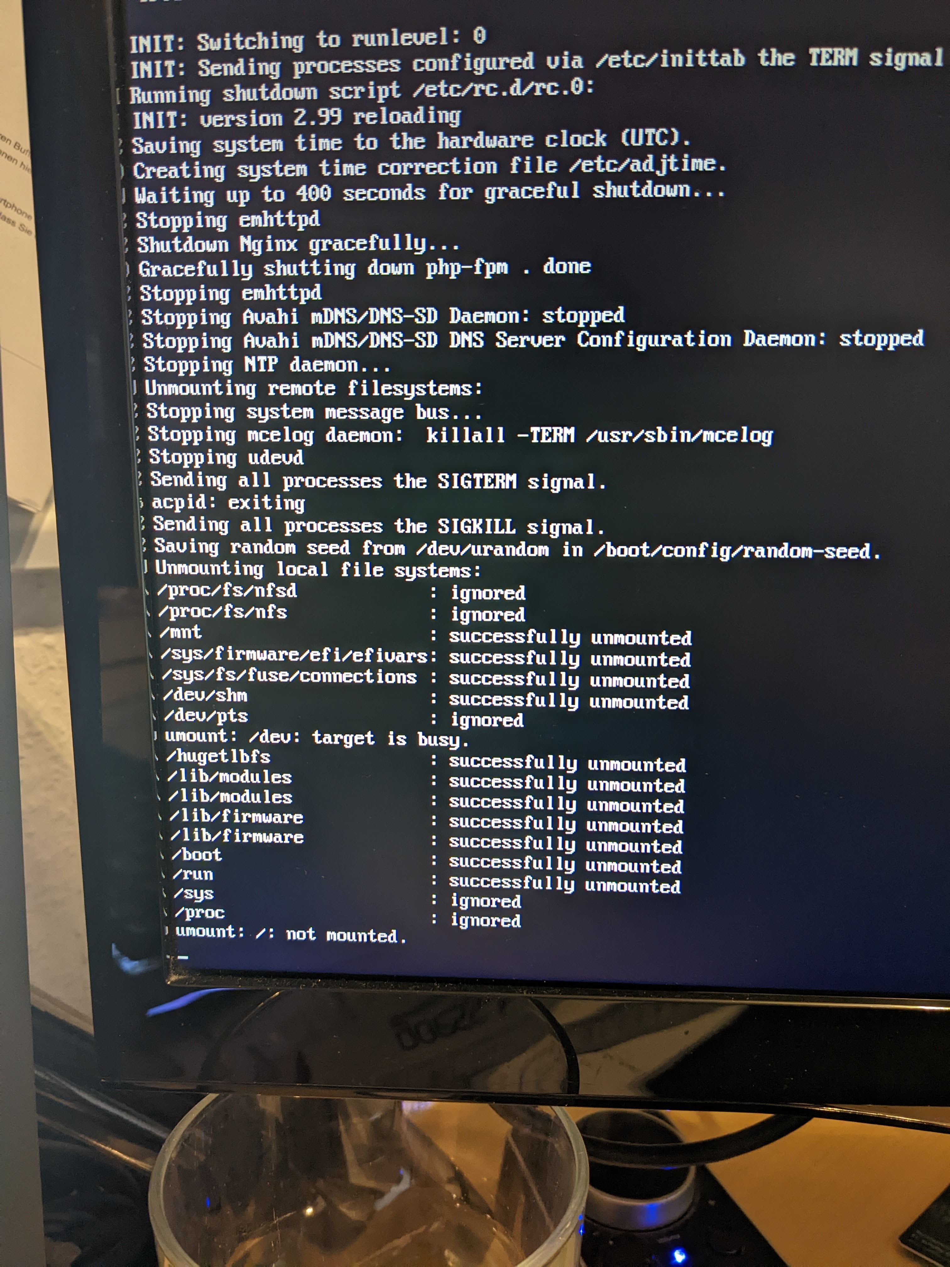

Hi, today i updated from RC3 to RC4 and my Server won't boot. It crashes at this point: When i reach "/user/sbin/winblindd -D" the Cursor stops flashing and i cant ping my Server immediately. So i think the Server crashes and i can't download a diagnostic. Booting into Safemode works and i attaced a Diagnostic (1_unraid-1-diagnostics-20220827-0916.zip). But even shutdowns/reboots makes problems at this point: Again the Cursor stops flashing here. I tried another USB Drive with a Unraid Test Version with RC4 and it boots and shutdown without problems. Diagnostic is 2_tower-test-diagnostics-20220827-1011.zip Also a Diagnostic ( 3_unraid-1-diagnostics-20220827-1051.zip ) from my running RC3.

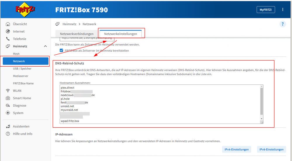

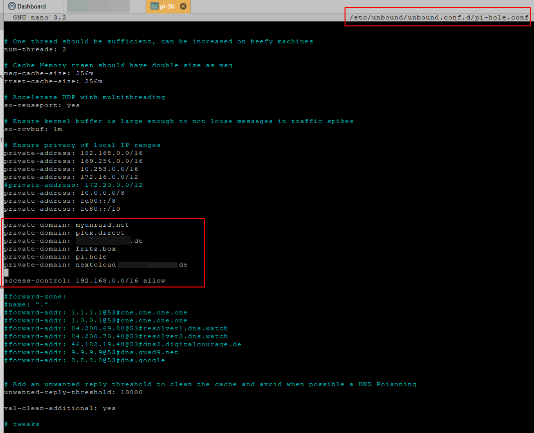

da müsste fritz.box rein, das wird aber nicht der Grund sein, warum es nicht läuft. Hast du den dns-rebind Schutz für deine Domains in der der Fritzbox und am Unbound deaktivert? Besonders der vom Unbound wird gerne mal vergessen.
