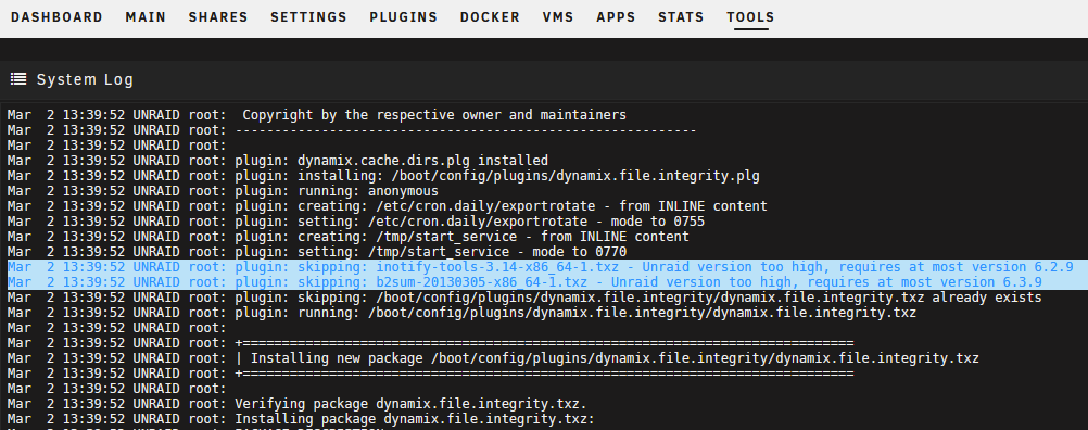

But a small thing I noticed. Syslog isn't starting with the normal boot process entries. The first entries for me are from some plugin checks/updates
Is this normal behaviour? Tried it with Firefox (main Browser) and Brave (never used for my server before). Same result. Is there a max line limit now for showing the logs and I can't find the settings?

10 minutes ago, bastl said:
Update from 6.8.3 went smooth as always. Temp sensors on TRX40 are working now. 😘
Switching from old pci-vfio in syslinux config to the new method also went without any issues.
I believe this is due to the size of the syslog buffer provided to the WebUI and it was mentioned in one of the beta or RC threads. The full syslog should still be available on the filesystem itself.
EDIT: Bug report already opened for it:
Edited by weirdcrap
Thx for the info. Is there any settings to show again the full syslog inside the WebUI?
Edit:
I was to quick. Noticed your edit to late. Thanks for the link
Edited by bastl
Not that I'm aware of at this time. I assume it would be rather trivial to increase the buffer size but I'm not sure where in UnRAID this is handled without digging through code.
If you follow that bug report @John_Mopened I bet LimeTech will come up with a workaround pretty quick for those who want it.
Edit:
sed -i 's/1000/3000/' /usr/local/emhttp/plugins/dynamix/include/Syslog.php
run this in terminal to fix.
Thanks. Does this survive a server reboot?
I imagine not as those files are unpacked fresh from the flash each boot. you would need to add it to your GO file.
Edited by weirdcrap
Yes need to put in go file.
