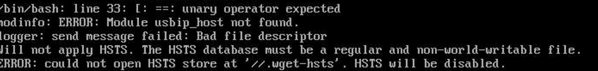

7 minutes ago, ich777 said:
I hear about this the first time I think?
Where did you notice the '/bin/bash: line 33 [: ==: unary operator expected' what Plugins have you installed?
What process is stuck at 100%?
Process @ 100% is an unrelated, existing issue.
Of yours, I have NVIDIA, Mellanox, DVB & iSCSI (both actually).  Had not see the error in 6.9-rc2 previously.
The Plugins are now all built and it's save to upgrade to 6.9.0 without loosing a Plugin because the packages wasn't built. :)
@ich777, I think this is my plugin, will review. It appears on the console, Looks like I also need to suppress modinfo message in USBIP one also.
Fixed /bin/bash line 33 error.
Edited by SimonF
What was the error? The package was built successful because I checked the contents and everything is in there...
Nothing wrong with packages, its was a check in my .plg script against a variable that didn't exist, and didnt need to be there Copy and paste moment 😉
