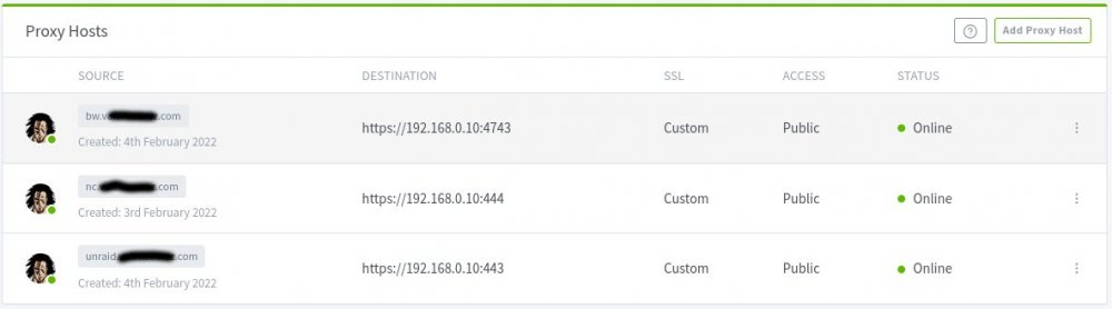

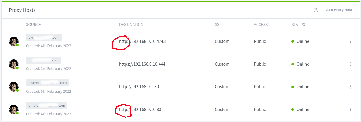

Well, I have to apologize once again, because as it happens, the problem was not Cloudflare, or any of the dockers, or certificates or anything related to technology at all.
It was, as it is 90% of the times, a user error, because the user (me) was ignorant, and chose to remain ignorant.
Since I had never used NPM, I basically added everything just like I added Nextcloud, which accessible over HTTPS, not even giving it any mind.
As you see in my first post asking for help, I have ALL of the instances on HTTPS:
So, I started thinking "maybe these dockers and services don't work over HTTPS, and the tunnel and NPM are what's going to secure them over HTTPS". Lo and behold, now all of them work (with the exception of my PFSense, I haven't figured that one out yet, but I know I'm keeping it on HTTP until I figure it out).
The solution?, here it is:
Having said that, as I mentioned at the start of my post, I want to apologize to everyone in this thread, in special to @LeoRX and @aeleos for making you waste your time.
