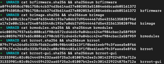

Having the same issue after upgrading to 6.10.0-rc2. Server won't boot due to a checksum error. Pulled the USB out of the Server and calculated the checksums myself. Can't find any issues so I wonder why this is happening on while booting the server.

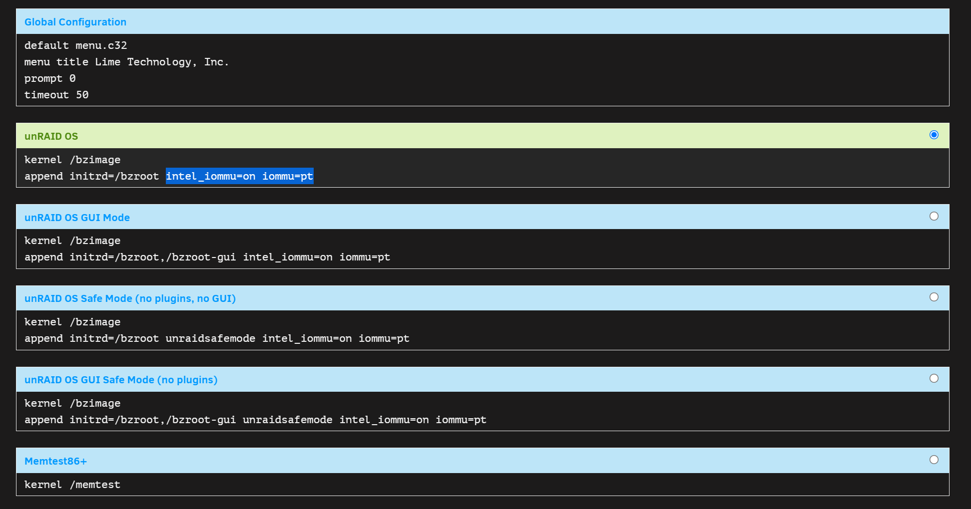

I think you are onto something here. I was having the same problem when i needed to replace my usb. I turned off virtualization support and was able to boot.
I went further, the kernel panic was about iommu. So I tried adding this to the boot args:
intel_iommu=on iommu=pt
I can now boot with virtualization on.
Hope this helps.
Edited by antpk
Adding screenshot of boot
