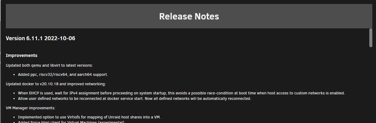

On 9/26/2022 at 10:47 AM, bigbangus said:
upgraded my backup server to 6.11 so far no operational issues.
I do get a blank release notes when I click on the infographic icon?
Works fine now in 6.11.1. Not sure if that's a coincidence or an expected change.
That issue should be fixed on v6.11.1
