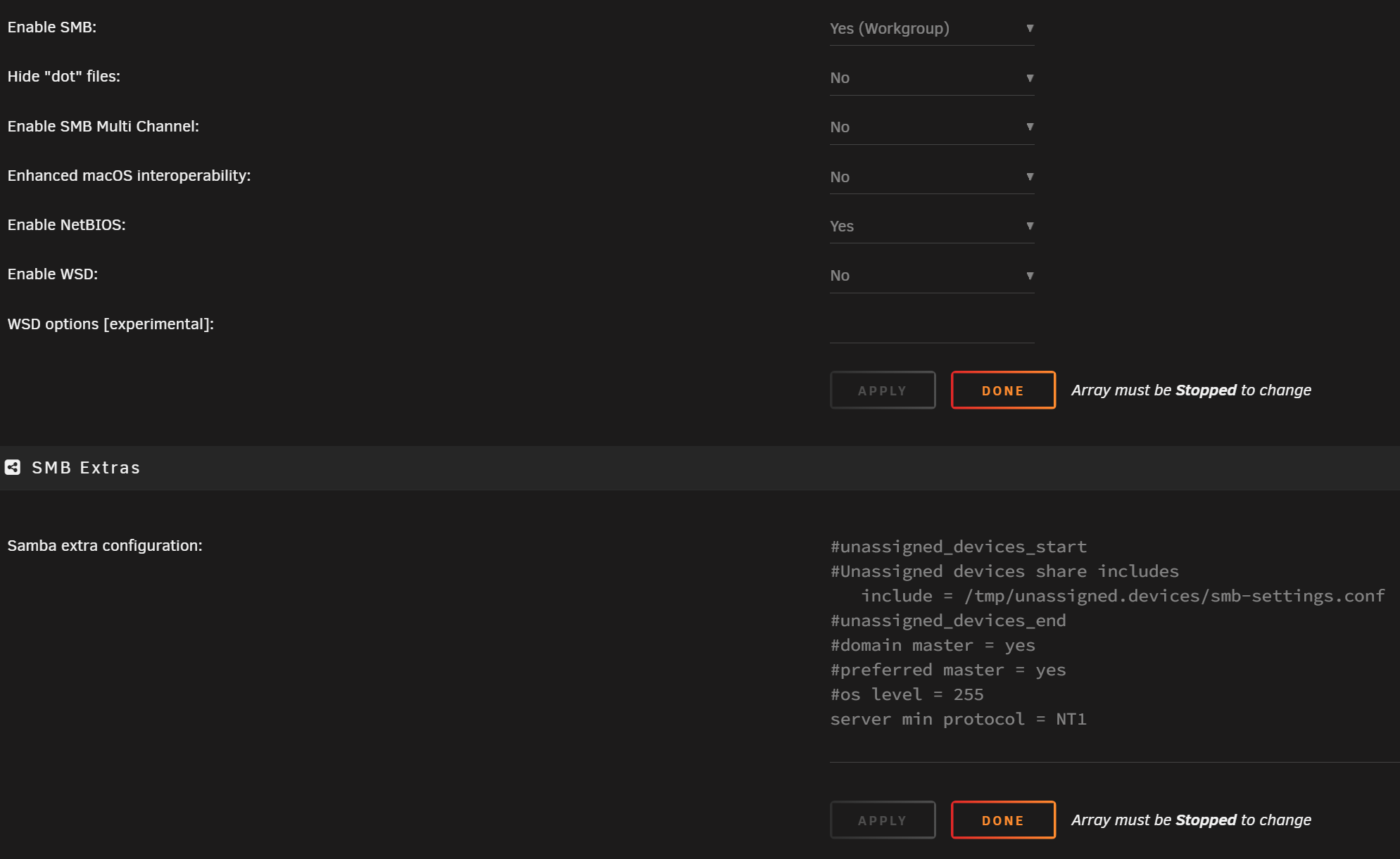

Well, my devices that use SMB 1.0 are no longer able to connect.  I'm currently setup like this which had been working:
#unassigned_devices_start
#Unassigned devices share includes
   include = /tmp/unassigned.devices/smb-settings.conf
#unassigned_devices_end
#domain master = yes
#preferred master = yes
#os level = 255
server min protocol = NT1
Any help getting it back up would be great.
Also, I have NetBIOS is enabled.  I never disabled WSD before, but tried that with no change.
Reverted back to 6.10.3 and all works fine again.
From the release notes:
SMB: remove NTLMv1 support since removed from Linux kernel
@craigr,  you might want to consider using NFS but I am not sure if devices that old have a version of NFS that still works  today (due to security issues) but it would be worth a try.
I can feel your pain.   I had three Netgear NTV-550 media players (only support SMBv1) that I retired earlier this year. (The removal of SMBv1 was an forgone given...)  I went with mini/micro PC's running KODI.   The prices for these boxes that will work start at about $150US.  I added to that a mini wireless keyboard (~$22US) to use as a remote.
Why are you using the "server min protocol = NT1" in smb-extras.conf limiting SMB to a very old protocol?  Unraid will connect with SMB1 with NetBIOS enabled.  If your device wants to connect and use the ntlmv1 protocol if will fail because the ntlmv1 protocol has been removed from the Linux kernel.  If your device insists on the ntlmv1 protocol, you'll have no choice but to find an alternative.

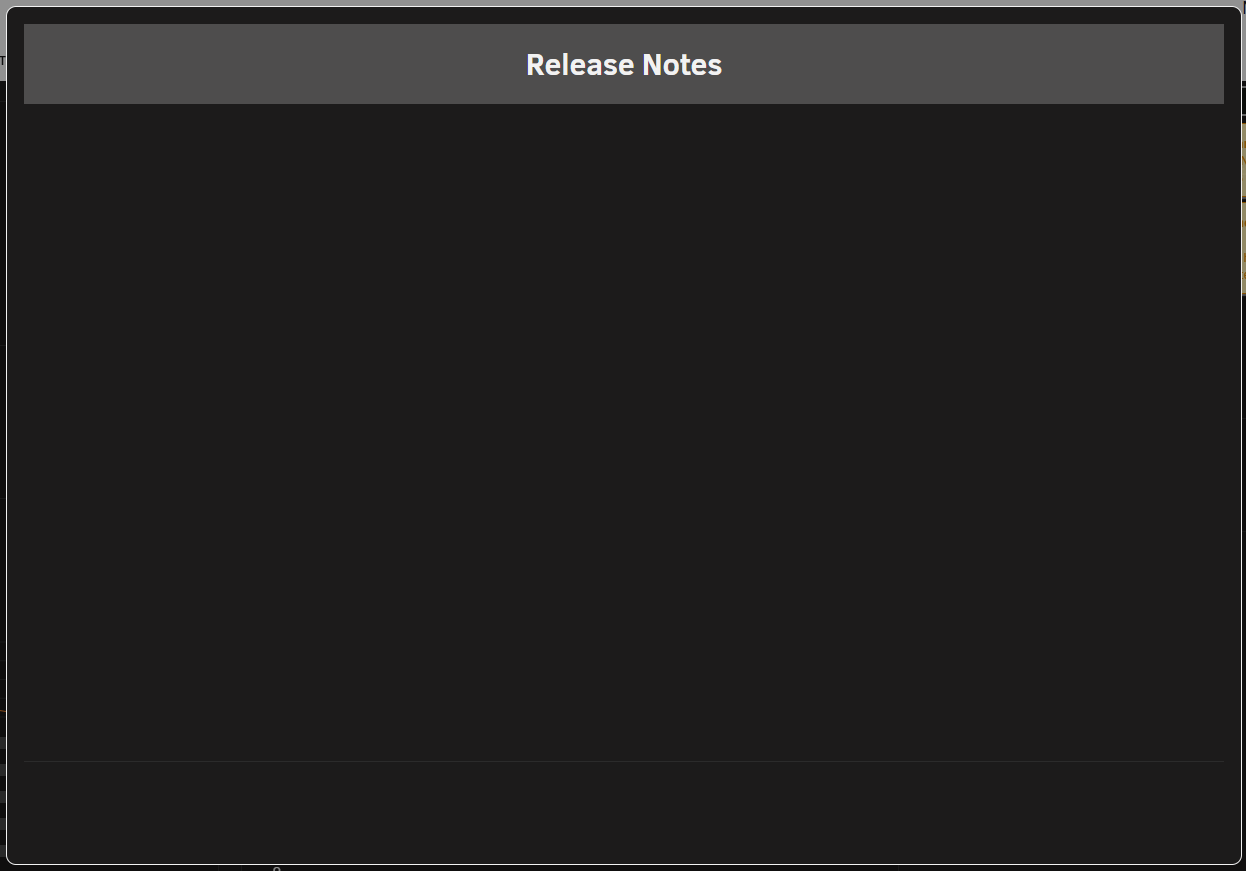

I do get a blank release notes when I click on the infographic icon?
Might you be confusing this parameter to "server max protocol"   I believe the current default for "server min protocol" is "SMB2_02".

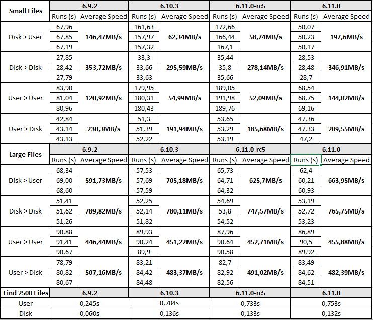

Anyone having SMB performance issues with Unraid, especially with user shares should update to v6.11.0, as mentioned in the release notes it includes Samba 4.17, and from the Samba release notes:
The security improvements in recent releases (4.13, 4.14, 4.15, 4.16), mainly as protection against symlink races, caused performance regressions for meta data heavy workloads.
With 4.17 the situation improved a lot again
I did some tests (see below for more details of how I do the testing) and SMB performance improved a lot when writing small files to a user share, which is where I've been noticing the biggest performance loss with each new Unraid release, I believe that the biggest part of that loss was from the Samba security related changes, without the new Samba v6.11 was on track to be again much slower than the previous release, -rc5 still uses Samba 4.16:

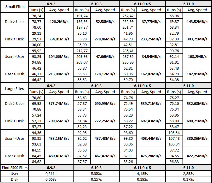

Another thing that looks responsible for a considerable performance loss are the Spectre/meltdown mitigations, especially on later kernels, though this can vary with the hardware used, mostly CPU/board/BIOS, it's my understanding that for home users, and unless you are renting VM space, it's extremely low risk running the server with mitigation disabled, and you can do that by adding mitigations=off to syslinux.cfg, or use the existing plugin, note the performance difference with both small and large files especially with both v6.11 releases, likely because the kernel now also has mitigations for Retbleed, also note the difference in the find test, where it's just the time it takes to list 2500 files over SMB.
With the new Samba release and mitigations disabled performance is a good as I've seen for many years, though v6.7 and v6.8 are still faster in some cases, likely from other Samba/kernel changes over the years, looks like any performance loss is inflated by FUSE, so what might have been a small loss turns into a much bigger one when using user shares.
Tests are done using two Unraid servers running the same release for each test, small files test uses around 10K small files of various sizes that total around 10GB, large files test uses 9 large media files totaling about 40GB, each test is run 3 times by doing a timed cp command where I take the time in seconds it takes (the "runs" column) and from that the average speed is calculated, 500GB Samsung 980 NVMe devices assigned to a pool are used as the source and destination devices, find test is just how long it takes (average of 3 runs also) to list the contents from a folder with 2500 files over SMB using a disk share and a user share.
My printer (Brother MFC-L2750DW) wouldn't scan to network folder in 6.10 and now it works.
limetech himself had me set it there the first time unRAID stopped working with SMB 1.0.
FWIW I noticed it on my DUNE players, but my (well everyone's) OPPO 203 and 205 players are on SMB 1.0 as well.  There may be heavy pushback from the group that primarily uses them.  I'm not thrilled either as I use these for ISO playback of audio and some video discs.  Not sure you can do anything if Linux has dropped support though.
craigr
Thanks.  Yeah, the primary playback in the theater and living room for some time has been Nvidia Shield running Kodi.  I switched for UHD playback way back when.  Kodi is great in the theater because there is also 2.40 skins available and I have a 2.40 screen.
Bedroom has just hung back with a DUNE player though, and when I went to watch my bedtime stories 😇 it couldn't find the server.  Had to get out of bed and try to figure it out.
Support for SMBv1 is still in unraid.  What is not there is the ntlmv1 protocol as it has been removed from Linux.  It would have been better if it was left in Linux and disabled as the default so it could be enabled as necessary, but LT has no coltrol over that.
If a legacy device insists on ntlmv1, it won't be able to connect to Unraid, if it doesn't, it should still connect.
Yes, I was thinking about it in the reverse fashion like UD would connect to a remote server.
