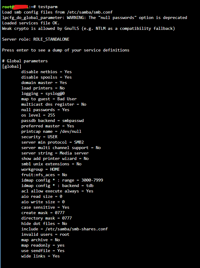

With all discussion of SMB, it might be useful to provide one tool to have a look at what parameters are actually being used by the Unraid SMB server.  You can find these listed by typing the following command:
testparm
The following is a screen capture of the result of the gobal section:
Following this section are the results of all of your shares.
