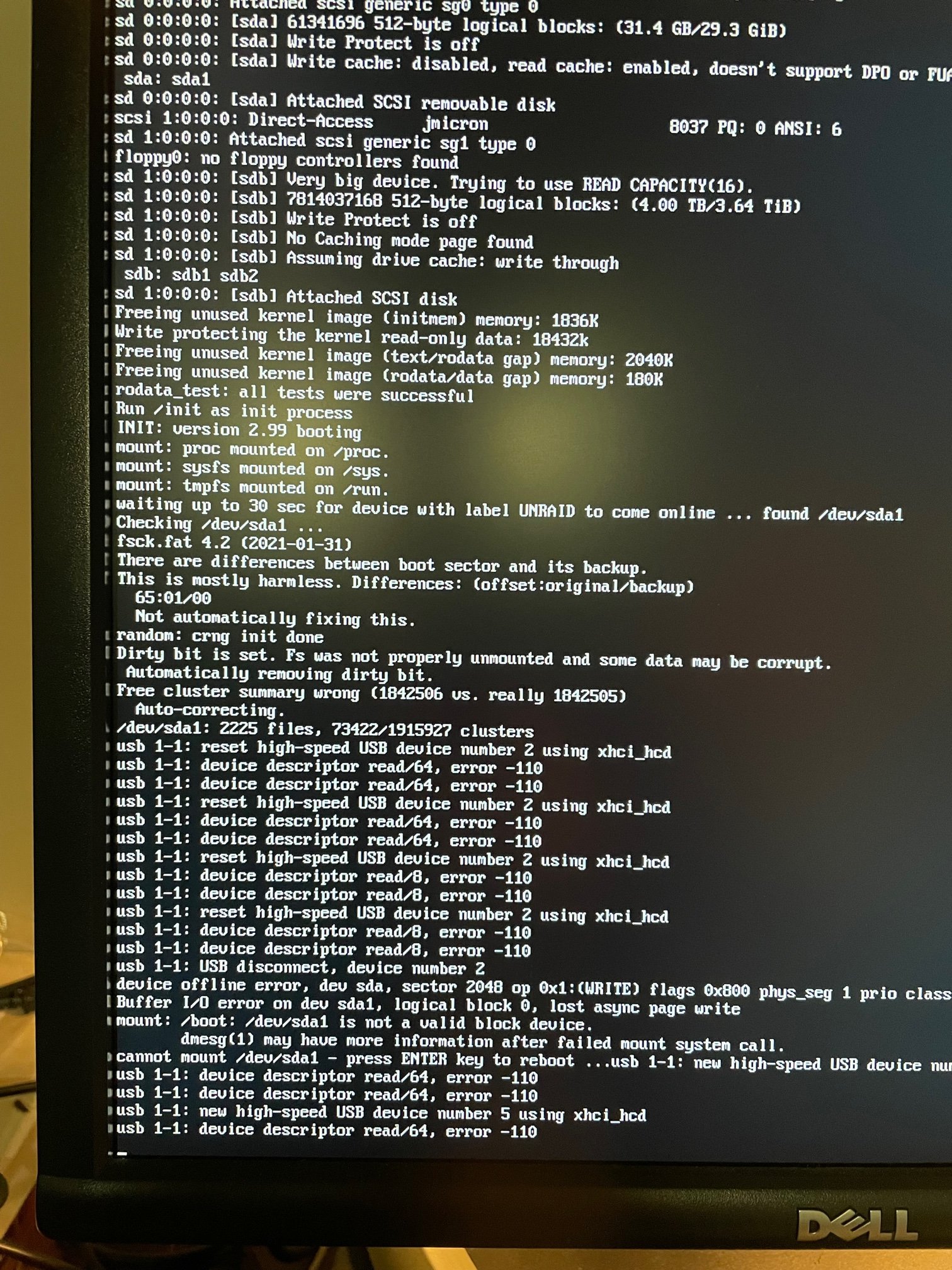

Updated 6.11.4 to 6.11.5 no longer can boot, any suggestions please?
Where is the boot stopping?
I am getting a device descriptor read/64 error 110
and then
cannot mount /dev/sda1 - press enter to reboot,
I can not boot into safe mode either,  same errors
any one have any suggestions i can try ?
image of  booting log attached
Backup current flash drive, recreate using the USB tool or manually, restore the config folder from the backup.
and then
How did you reboot the server following download/install of new Unraid OS version?  Console messages imply an unclean reboot...
Think you are correct,   the update appeared to be complete, but still showed prior version, so I manually did a reboot from the Gui,  and it never booted after that,
I took out the USB Flash and tried to read it in and tried to read in a Linux Machine and had read errors there also,
I had a previous flash backup and restored on a new flash and pulled down a new key,  everything is now update and appears to be working fine!
