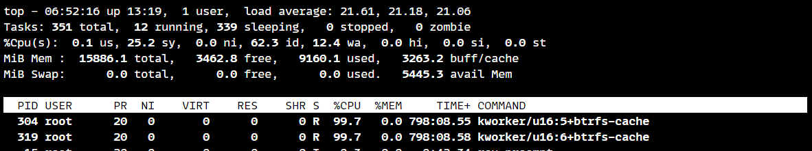

So. The btrfs check commands did not help, I still see the same Kernel crash in the syslog when booting normally. The only way I can start the array since the 6.11.5 upgrade is to boot in safe mode. :(

4 hours ago, JorgeB said:
That suggests a plugin issue, uninstall all plugins (or rename all *.plg files) to see if you can find the culprit.
Before rebooting again I noticed that some of the CPUs were always pinned to 100% while stuck waiting for the array to start, and looking at the running processes again pointed to a btrfs issue.
It turns out I had a second btrfs drive, an NVMe SSD which was mounted via Unassigned Devices that I had missed. Booting again in safe mode and clearing the btrfs free space tree in the terminal (as you initially suggested), and rebooting again normally fixed the problem I saw with 6.11.5. The Kernel crash is also gone from the syslog. This also explains why downgrading did not fix the issue...
Looks like I was indeed just that unlucky! :)
Thanks!
In case it's important, the problematic drive still had a v1 free space cache, it was created long ago. I looked into converting it to a v2 space cache but that requires recreating the filesystem or tweaking the mount command, so I probably won't bother doing it. My other btrfs drive used for the pool cache was already on v2.
If you assign it to an Unraid pool it will start using v2, then it's a good idea to delete v1 cache again.

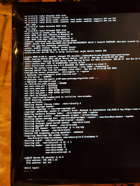

I upgraded from .3 to .5 today.
my server has rebooted, but i cannot access GUI from any PC (chrome & firefox)
hooking up a  monitor booting into non-GUI mode can see the following.
correct IP.
i could boot into GUI mode, but dont know what i would do.
also, some USB on the back of the mother board stopped working.
flash is obviously working.  computer beeped with no-keyboard error on startup.
had to move the keyboard USB to a different USB controller for it to light up with power again.
4 USB with no power.
correct IP.
Log in to the Console and type:
diagnostics
That should write the diagnostics file to the flash drive.  Then type:
powerdown
That should power down the server.  (If it doesn't, a quick push of the server power button should.)   The upload the diagnostics file.
diagnostics
powerdown
got help on discord.
deleted network config.
rebooted.  set static IP
rebooted.
working

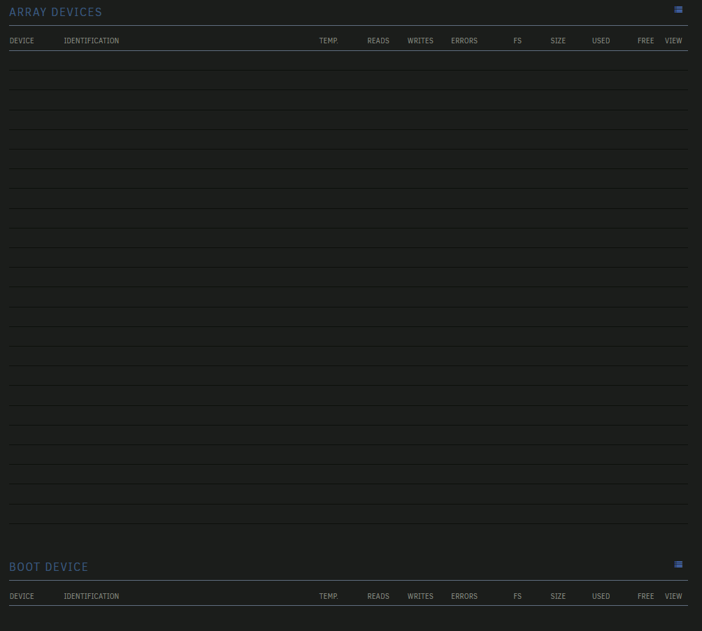

Just updated to 6.11.5 from 6.9.2 thinking it might help fix some plugin issues I was having and now my UI under the Main tab is completely wonky. Has anyone else had this happen and know what the fix is?image.thumb.png.700fef3f73a5808acd6a8fa287aaead6.png
Try booting in safe mode
I tried this but nothing of note happened.
I was able to SSH into the system while it's presumably in safe mode, but the GUI isn't available and the OS rebooted to normal after ~6 minutes.
I'm also noticing that none of the new window or in window popups (terminal pop out, updating dialogues, etc.) display any information anymore. They just open up and hang until forcibly closed or the page refreshed.
Try with a new flash drive with a stock Unraid install, no key needed, if the issue persists it's likely browser related, if not it's config related so recreate the flash drive and restore only the minimum config files.
