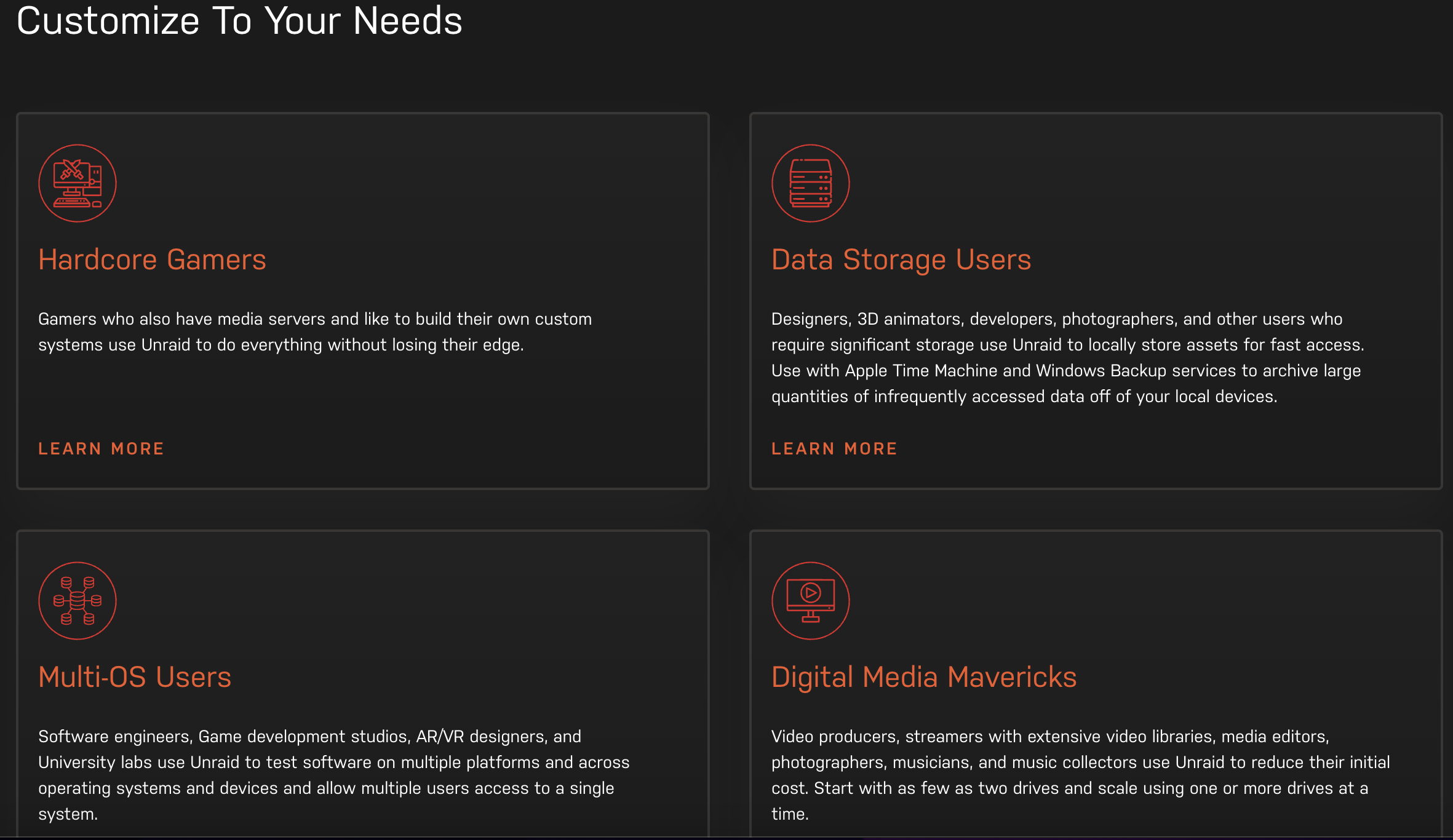

On 1/23/2023 at 2:39 PM, Interstellar said:
Firstly, you're posting on a UnRAID forum. UnRAID is, at the core, a NAS. Hence you'd forgive the people who know it as NAS software assuming that you'd use it... as a NAS. It'd be interesting if anyone uses it as a non-NAS but I've not come across anyone doing so, I'm sure there are a few, but I'd guess less than a few %.
Unraid.net front page. Find the word NAS.... I'll wait.
