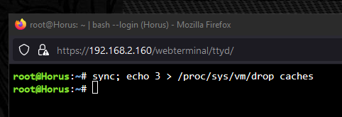

A strange thing on v6.12.0:
When i type an underscore, it shows a "space" 👍🤣
(drop_caches)
Edited by Zonediver
I believe that's a Firefox issue, try a different browser.
Well... you are right...
but i didnt ever see this under 6.11.5 with FF...
Never mind 👍
Edited by Zonediver
