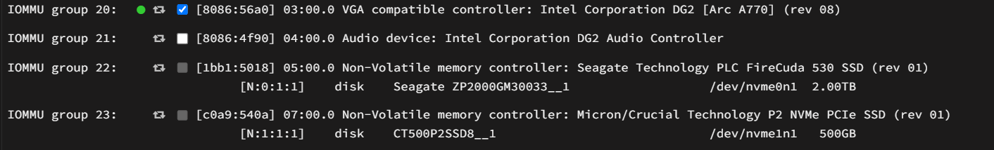

In this file has the PCI devices to be bound to vfio.
root@computenode:~# cat /boot/config/vfio-pci.cfg
BIND=0000:03:00.0|8086:56a0 0000:05:00.0|8086:56a 0000:05:01.0|8086:56a0
root@computenode:~#
On my system 05:01.0 does not exist so my VMs do not auto start. So I would need to remove this. Also the vendor:product is in correct.
Take a note of your devices in tools->system devices.
Make a change to the checked devices save and then set how you want this will update the file in /boot.
So I unchecked group 20 saved, added in group 20 and now my file looks like this
BIND=0000:03:00.0|8086:56a0root@computenode:~#
Changes do not take effect until a reboot.

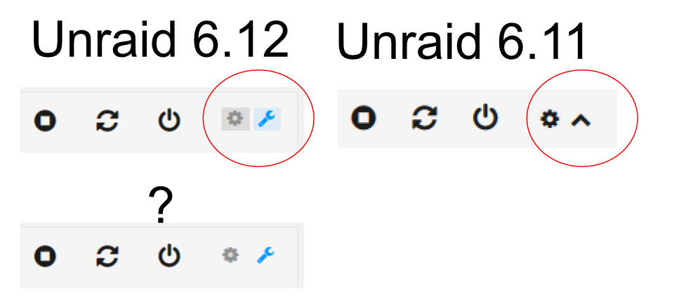

I would have a question regarding GUI in Dasboard view. There are new icons for cog, wrench and info. Is it intention to have that squares background? In my opinion it somehow does not fit in general view. For me it is every login little bit eye catching. Maybe it is matter of taste or time? I do not know. What do you guys think? I know that it is just stupid thing but...
Please see attached example.

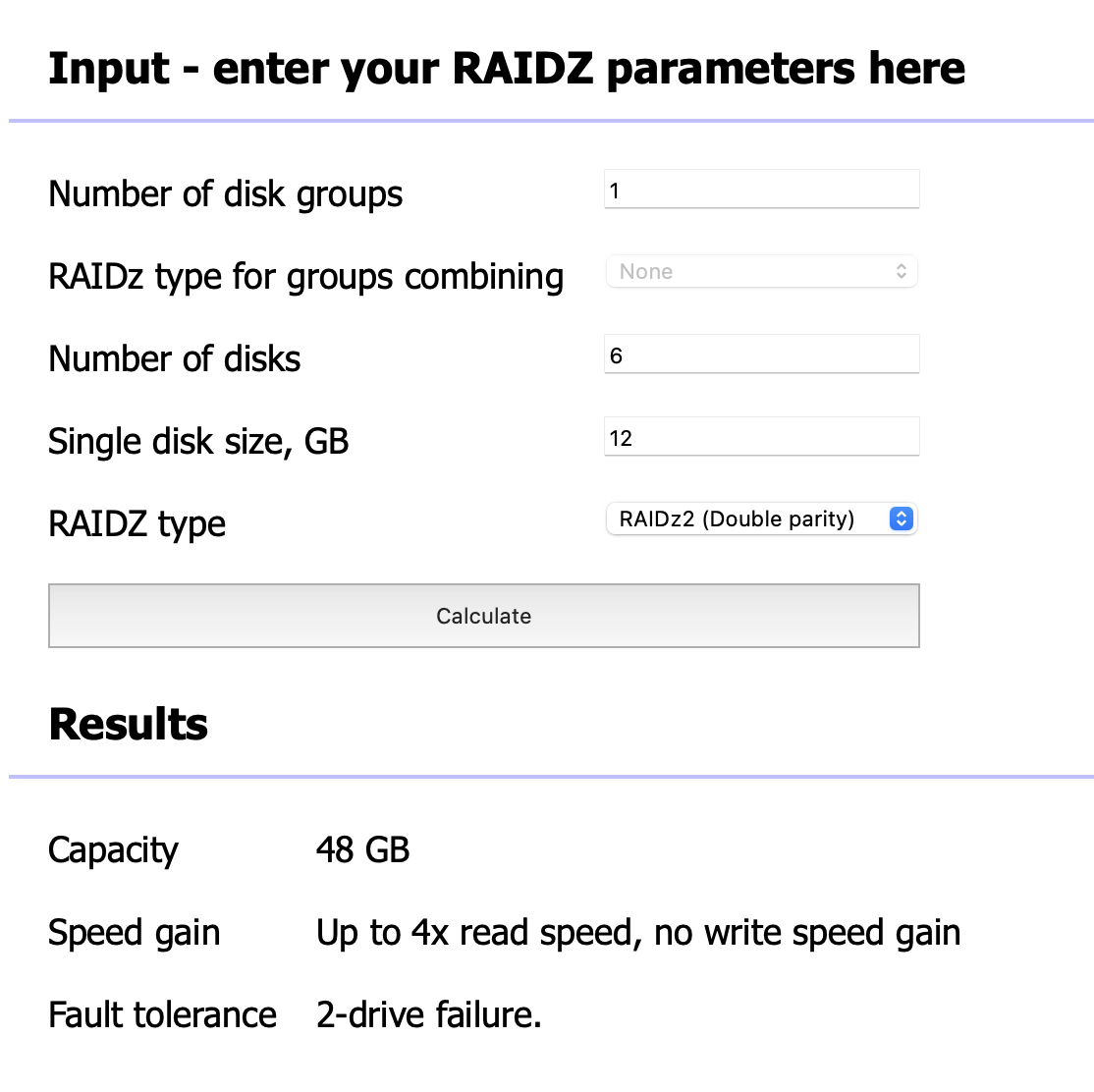

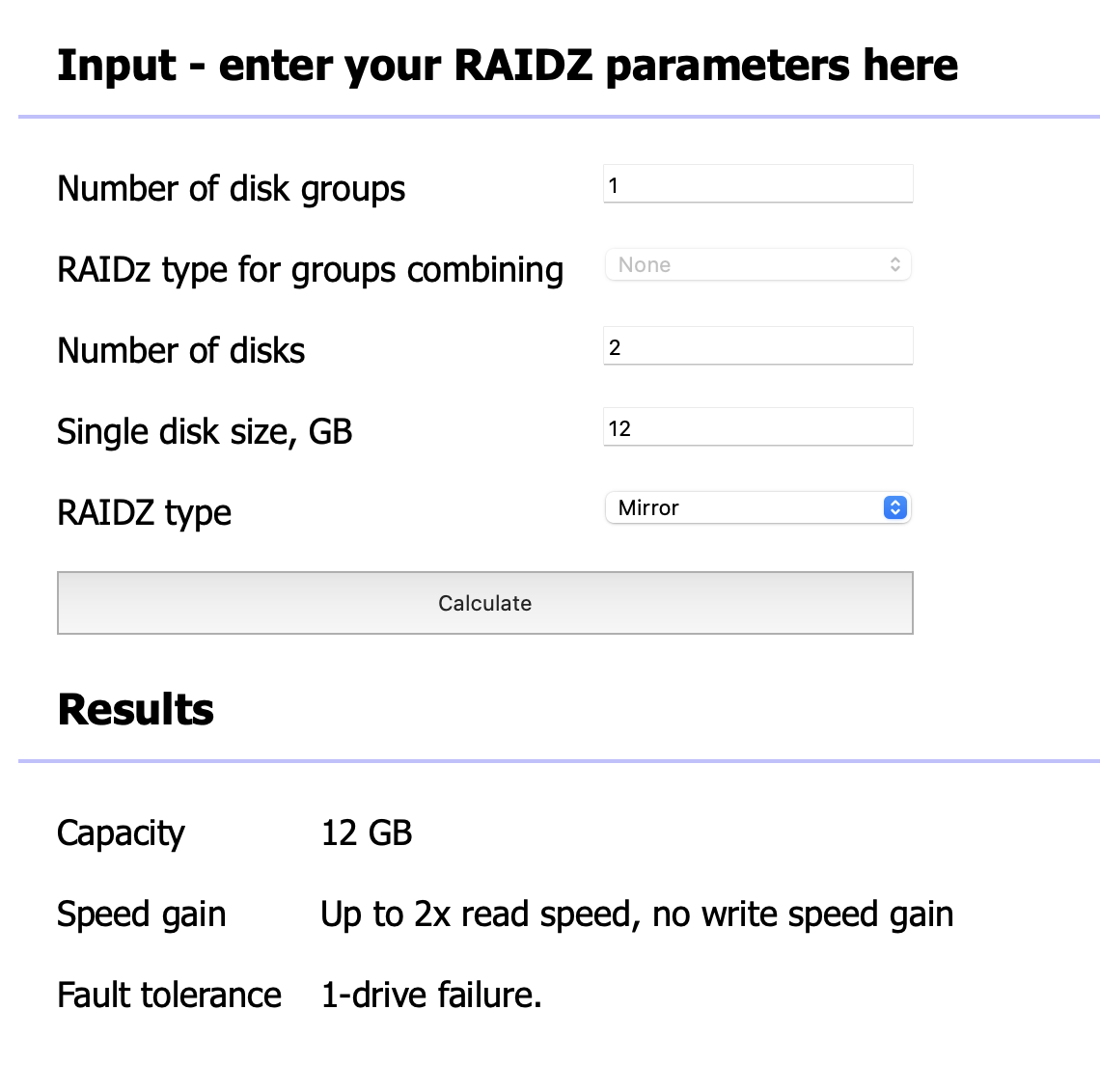

https://www.raidz-calculator.com/default.aspx
Eventually i will migrate some of my array disks to a 6disk ZFS array of video files so can be quickly edited.
533890619_Screenshot2023-06-16at14_44_41.thumb.png.f28bafbce52d69a67b0317aaa8c19dab.png
root@computenode:~#
Thanks, i'll review and report back if i have issues
