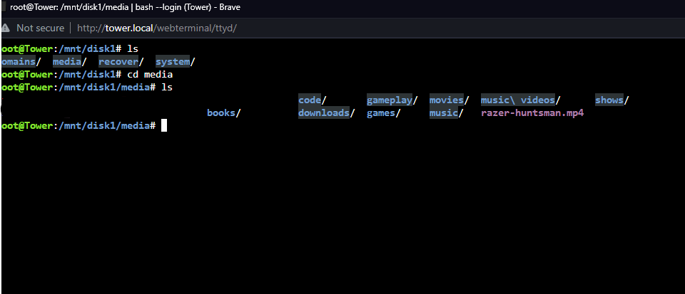

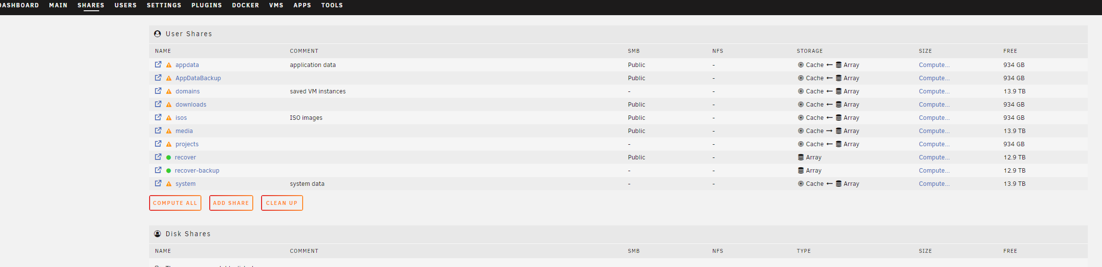

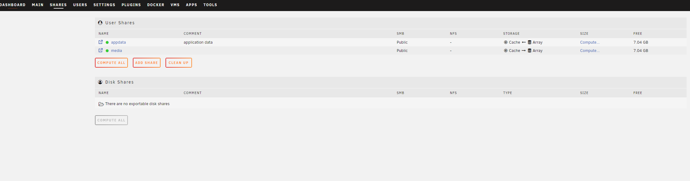

Just updated, can not see files in shares
Also no files visible in the cache as well as appdata so docker images can not find their data.
Did I do something before the update to cause this (files still in disk1)  removed a directory in (cache/media/data)
How can I setup the shares and get the files from disk1 to appear in the cache shares?

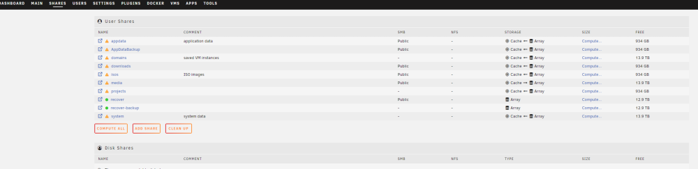

Edit (if it happens to anyone else):
I'm not sure what caused this, after seeing all files still there in disk1. I ended up rebooting once more and everything reappeared.
Don’t quite understand what your problem is :(  Not sure why you expect the files on disk1 to appear on cache?  Perhaps you need to explain the exact problem in more detail?
You are likely to get better informed feedback if you attach your system’s diagnostics zip file to your next post in this thread.
Sorry I should have explained better.
The share tab was showing 2 shares appdata and media for with 7.04tb free which is disk1 (in the first shares screenshot 8tb drive).
Since then I've rebooted and all the shares have reappeared and on the new screenshot added to the previous post the right shares and drives are being shown. I'm not sure why this happened upon the first reboot after the update. So no problem now.

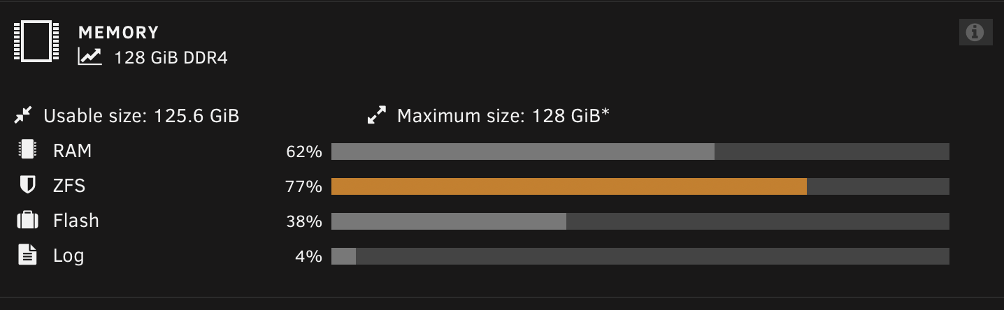

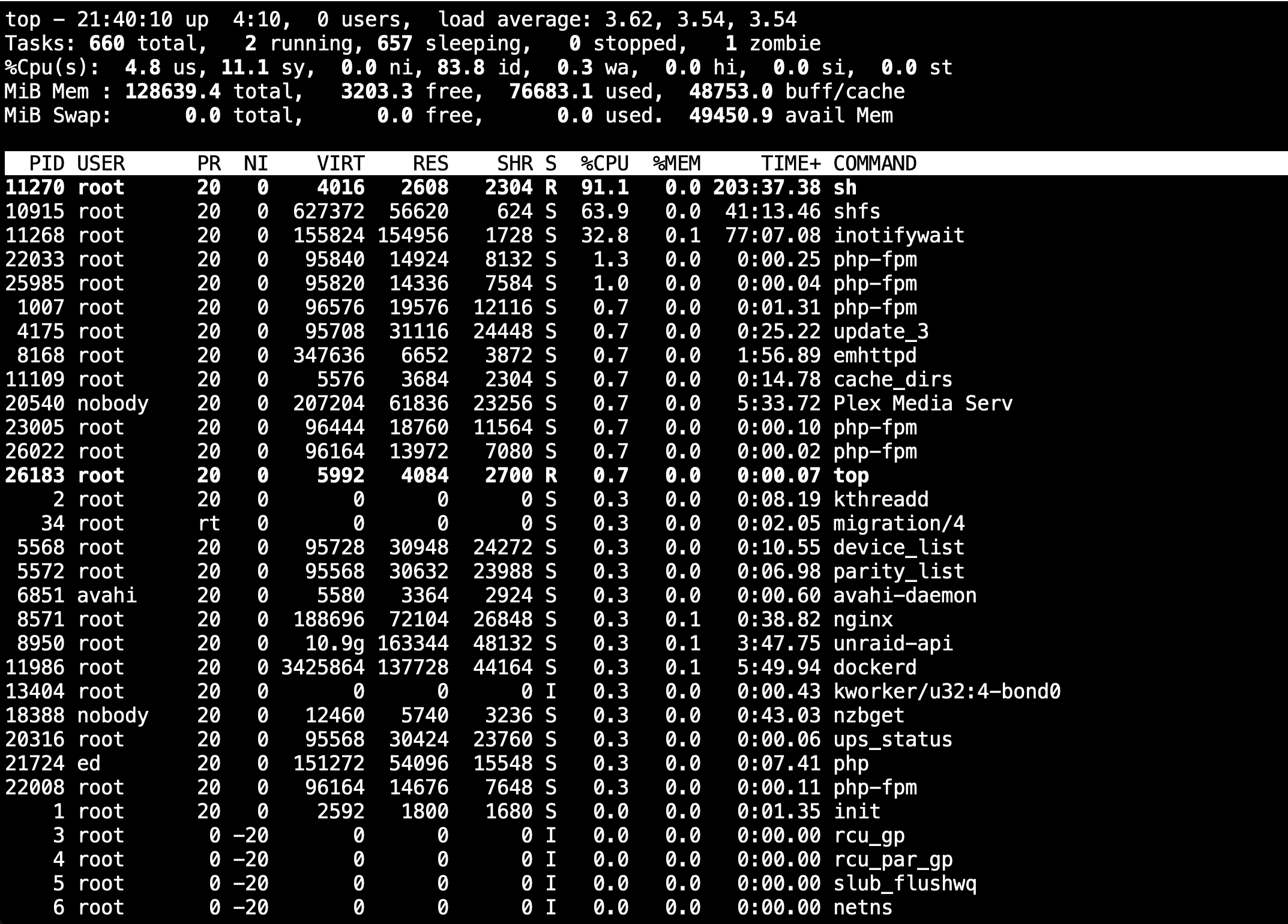

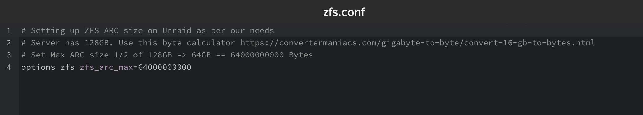

Not an issue more an observation as I have the extra ram deliberately for ZFS to use.
I think at present the ZFS arc is adding the default 1/8 ram amount to any custom arc setting or something else is going on.. I have given it a max of 64GB (128GB/2 => 64GB == 64000000000 Bytes)  via zfs.config
Is it's saying ZFS is currently using 60GiB and showing it has 33% left.
At the moment the total ram usage is 76GiB and the system and docker use about 3GB so presume it is extra ZFS ram usage?

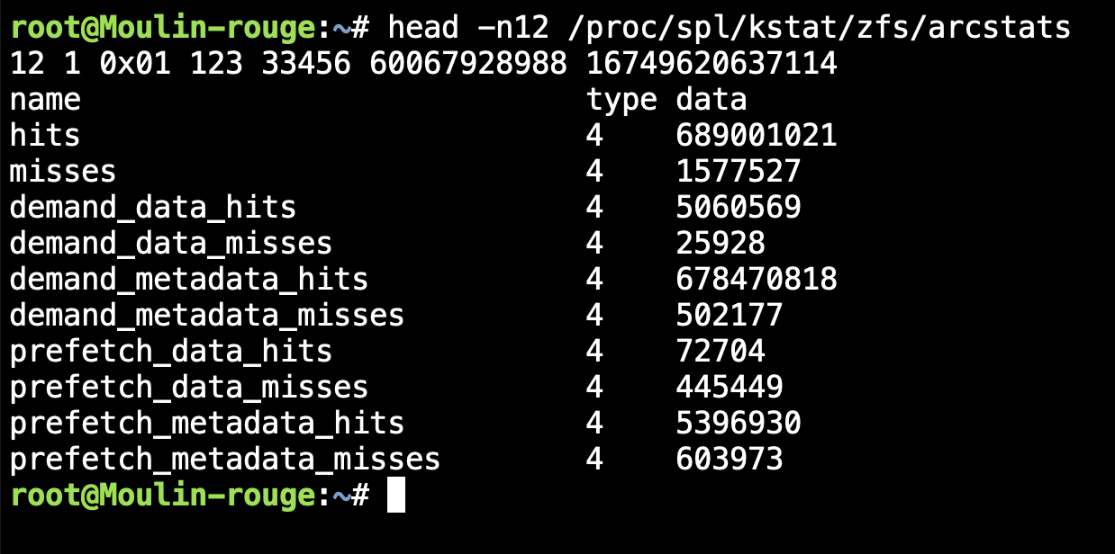

Zfs arc stats
head -n12 /proc/spl/kstat/zfs/arcstats
The unused 23% mean that 23% of the currently used RAM are not being used by ZFS, not how much more zfs can use, you can check ARC max size with:
cat /proc/spl/kstat/zfs/arcstats | grep c_max

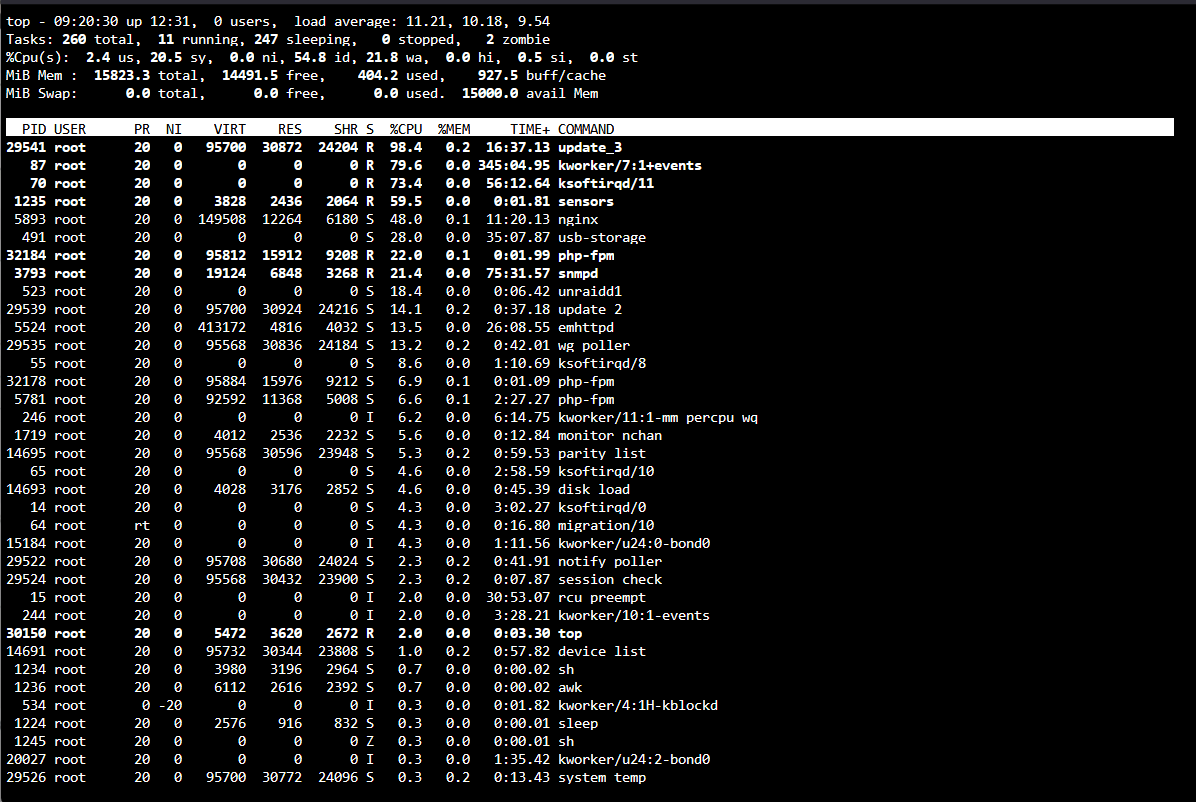

Hi all, since updating my system performance has gone insanely bad, to the point the web interface is not usable if I perform a simple task like erasing a drive... I've been talking about this loosely in the Unraid discord but seems no one is able to really concentrate on the one issue to help, and I get that, there's a lot of people asking questions that overlap, it is what it is. I'm happy to separate this out to an entirely new thread if needed...
So I updated from a working system, no pre-existing issues. I then noticed my server seemed dead on first boot, no screen output, no ping etc, but I had to go for lunch, when I came back it was up and working. Logged in and then went to set up my cache from btrfs to ZFS and this is when I noticed these huge pauses.  To cut a long story short, I have no VMs, no docker containers etc running. System is an 11400 Intel so not old nor underpowered for the task and hand! This is the CPU usage when just asking it to format a drive, being the first peak (set to 5M) and then after startng the array with also the TOP output from console. Diagnostics also attached.
EDIT: To add I just downgraded back to 6.11.5 and all my problems disappeared to this seems to be an issue specific to 6.12 for me
atlas-diagnostics-20230619-0928.zip
