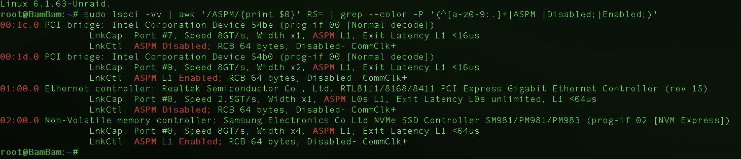

On 12/3/2023 at 6:28 PM, MPC561 said:
Asrock N100DC-ITX.
Realtek 8111H Network
No deep C-Pkg States more possible, I stuck at C3. Reached with 6.12.4 as Pkg-State C8. With 6.12.5 and .6 I see that ASPM is disabled:
1000669460_Bildschirmfoto2023-11-29um16_28_12.thumb.png.e9c4279039a1cd2b6c9bd5def34acaa0.png
Installation of the RTL8xxx App Package is useless. Also with them only C3 can reached (although ASPM is shown as active, but the Github Pages states, that ASPM is not active with this driver package). Power consumption increased by more than 25%.
Needed to revert to 6.12.4.
Hope for a fix.
With kind regards,
Joerg
I support this statement. It's a pitty that N100DC-ITX increase its idle power by 25%, because from my point of view, this board is the best or one of the best prize-powerConsumption-transcodingCapabilities performance solutions.  In addition , there is no fan or noise with SSDs.

The problem is not only with this board. It hits nearly every board with Realtek Network Chip (8111, 8168, 8125, 8152). So the problem is much bigger than an N100 Board.
I know already the argumentation will be: It´s the Kernel. We are not developing the kernel. But I paid my license from Limetech after this special board was tested by me and running. Now the state is worse as it consumes more power.
It´s like I would by an iPhone with a new linux based OS and with a big bug and Apple would send me to the Linux Kernel developer that me demands they fix it instead of doing it itself with them...
Taking all this into account, could this be fixed? @unraid

5 hours ago, MPC561 said:
@vmasip
Your Apple analogy is flawed becuase Apple DOES control the entire chain and do not rely on open source piece for its things.
A better analogy would be your web browser gets an update and stops working on your laptop so you call Dell to fix it cause they sold you the machine.
The Kernel is more complex then your web browser but at the end of the day... hopefully you get my point.  I am sure that this bug has hit more than just the unRAID community and the Kernel devs will be looking at it.  I am also pretty sure Limetech are not Kernel devs so this issue is not within there wheelhouse.
