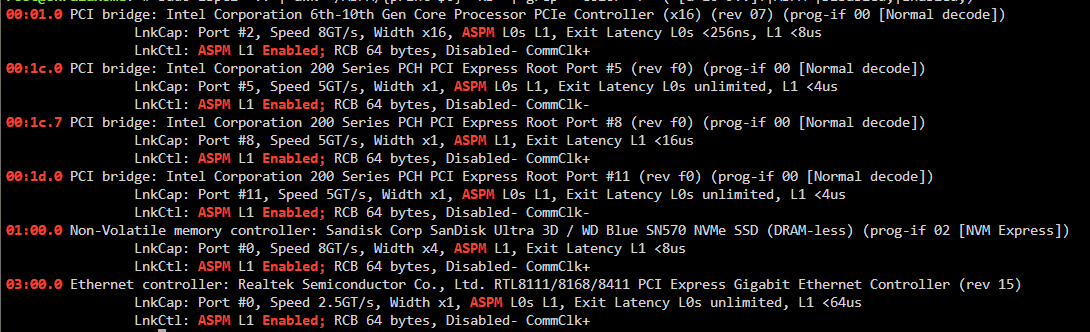

Same issue for me. No C-State below C3 after the Update.
I got APSM working again after i installed the Realtek-Plugin, but no luck with the Powerconsumption.
Idle now C3 ~21W , idle with 6.11.5 and C6 ~ 17W.
