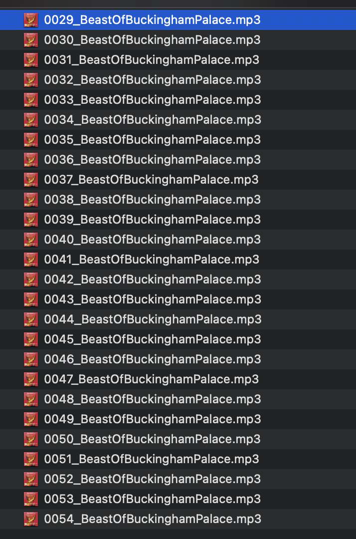

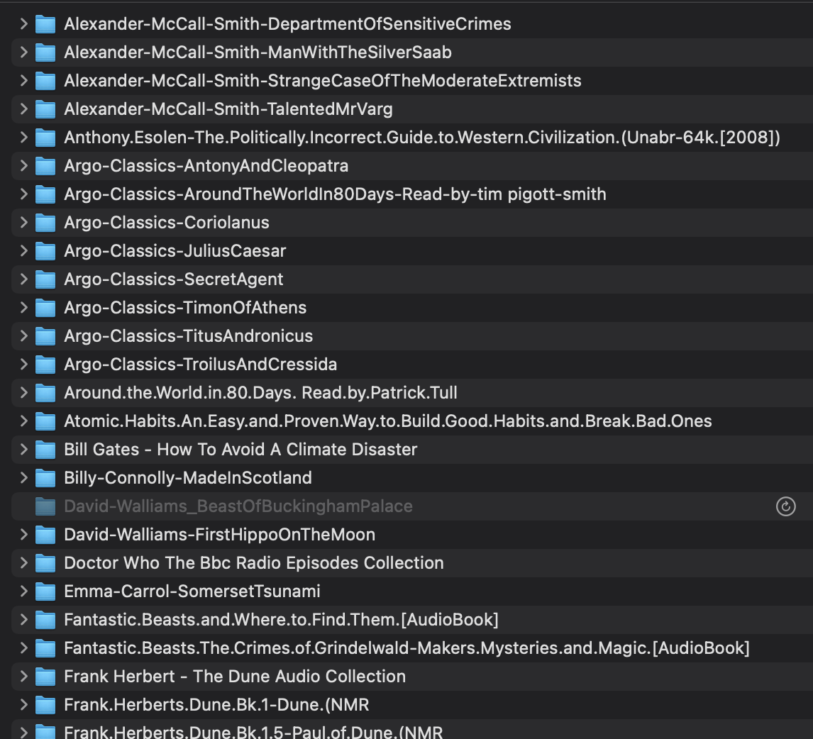

I am also getting some whinging about files names being too long so it stops an smb transfer.
It wouldn't transfer file 41 out of 54. As you can see from the folder list on the server there are many longer names already existing..
No need for support. Diagnostics are included incase anyone wants to explore.
