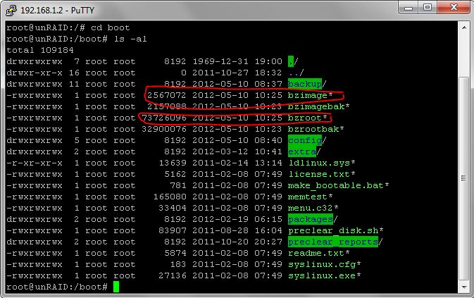

OK...I am having an issue that I have never experienced with previous builds...
I just upgraded from b14...stopped array, replaced bzroot and bzimage and rebooted.  Waited about 5 minutes and tried to acces the GUI and was not able to reach it.  Tried to access the Flash share...not reachable.  System continues to be pingable.
I was able to telnet in and I issued a "reboot" command (I wasn't sure if the first reboot actually happened).  This time I pinged the box and saw it go offline.  After a few minutes it came back online.  I am still unable to access the GUI or the Flash share!
HELP!!!!  :(
Since I am able to telnet in what should I look for?
HELP!!!!  :(
HELP!!!!  :(

By any chance using simple features plugin ?
i had similar issue .... upgraded to latest simple features and issue was resolved ...
I am indeed.  :S
Can someone tell me how to edit the GO script via telnet?
John
I think (hope) I fixed it.
I always make a backup copy of bzroot and bzimage in a backup dir on my flash drive.  I just copied teh b14 files back to /boot and I am rebooting now.
Fingers crossed!!!
John
No joy.
In the pic below, the files circled in red are b14 versions.  bzrootbak and bzimagebak are the rc3 files.
Box pingable but no GUI and no Flash share.  The verison of SimpleFeatures I have running was working fine for me on b14.
John
To reiterate what has been said - can people posting problems in here only do so with no plugins running? They're muddying the waters tremendously.
johnodon - make sure you have simple features removed / uninstalled / not running. Then see if you have a problem. If you don't the the problem is with simplefeatures and you can ask in that forum thread. And if I understand correctly you've now seen the same problem with your old b14 and RC installs. So it's probably not a problem with this RC.
