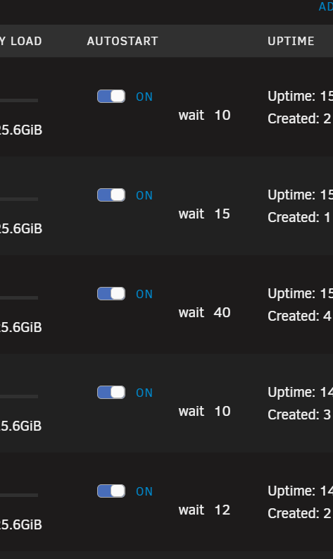

Updated from RC2 to 7.2.0. No issues. However, docker start times have been adjusted this release but are truncated still:
The bottom two Dockers are 100 seconds and 120 seconds respectively. If I highlight them as if to change their value, I can scroll and see the who number. But even highlighted, it only shows two digits at a time.

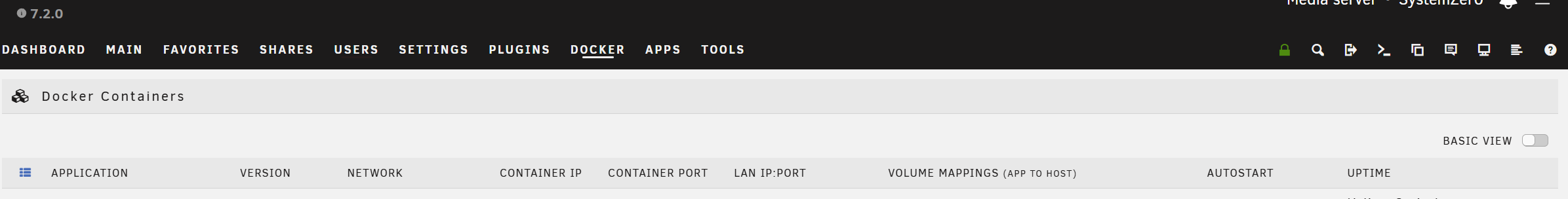

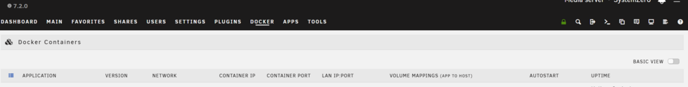

On 10/30/2025 at 2:31 PM, SystemZer0 said:
i think there's a visual bug in the desktop docker page. the "basic view toggle button" on the top menu is taking up a whole row leaving a big empty gap. i don't remember having this gap in the previous version
By design. Changes needed to be made for responsive, and that slider button was always hacked into the title bar there, and became a very big problem to put back in, especially if docker compose plugin was installed

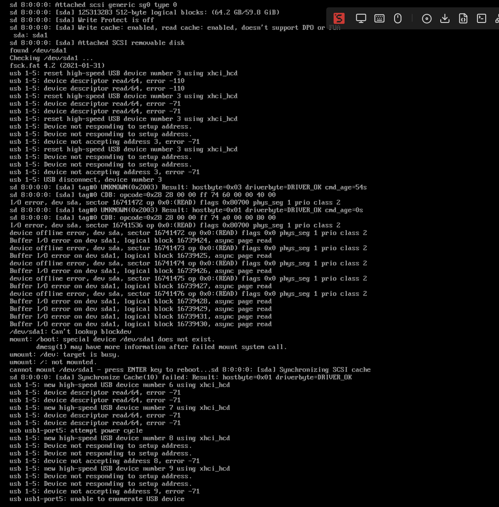

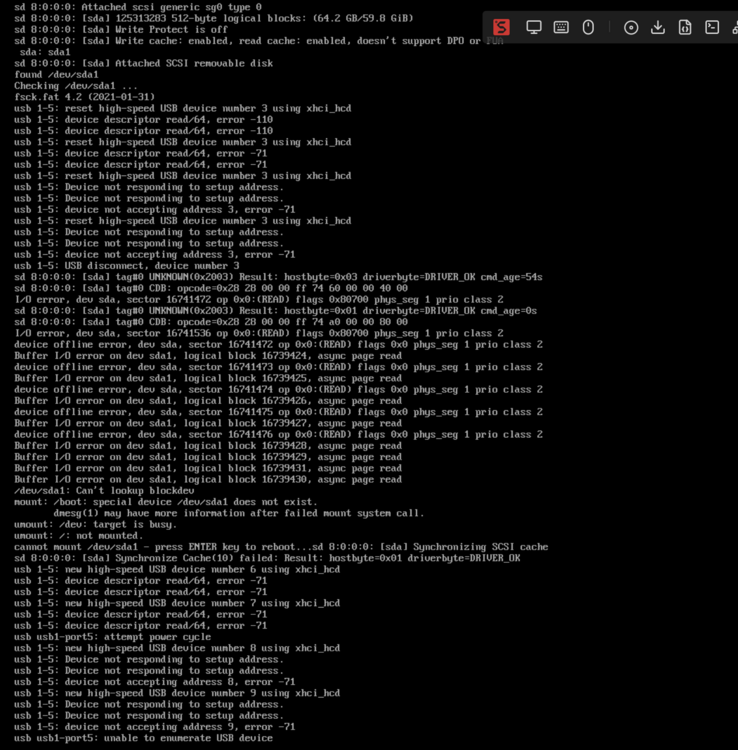

Need help.
Created flash backup and start update from 7.1.4 to 7.2.0
In gui got usb flash drive error and system hanged.
Replaced usb flash drive and wrote backup and system hanges up on boot with... see picture.
Try recreating the flash drive, first backup the current one, then recreate it using the USB tool, confirm the flash drive boots with the stock install, and if yes, restore only the /config folder from the backup overwriting any existing files.
If that doesn't help and you need more help, please start a new thread in the general support forum, this annouce post is not the right place for support.
The problem with usb flash drive did the problem with the backup, load previous backup solve the problem. Unraid starts.
Thanks.

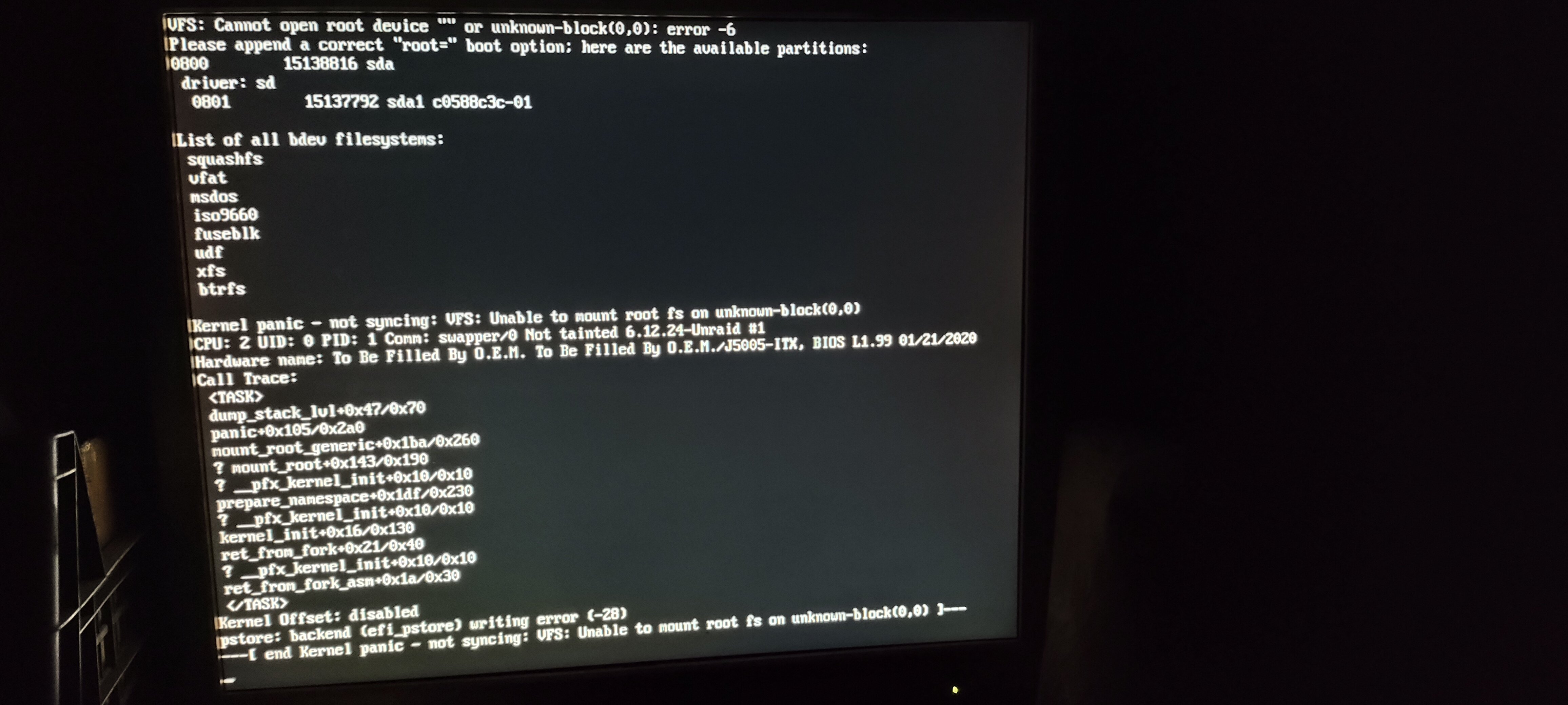

I was running 7.2 RC1 and then upgraded to RC2 with no issues. I just upgraded to stable 7.2 and it boots but the web service isn't working. I can ping fine from the console and can ssh in. Google helped me to get a login screen via the following but as soon as I login and it tries to load /main, I get a 500 error. > /etc/rc.d/rc.docker stop
  1. /etc/rc.d/rc.php-fpm start
  2. /etc/rc.d/rc.nginx start
I have removed the .cfg files in /boot/config/ for docker, domain, disk, and share but nothing seems to be working. /usr/local/sbin/emhttpd does not exist - should it and it just was a failed upgrade?
This is very strange. I would recommend first recreating the flash drive, first backup the current one, then recreate it using the USB tool with 7.2.0, confirm the flash drive boots with the stock install, and if yes, restore only the /config folder from the backup overwriting any existing files.
If that doesn't resolve the issue, please create a new post/bug report and post the diagnostics or just the syslog if the diags don't download.
