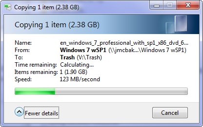

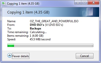

Copy speeds to the array are EXCELLENT ... notably improved.  Here's a copy in progress in each direction:

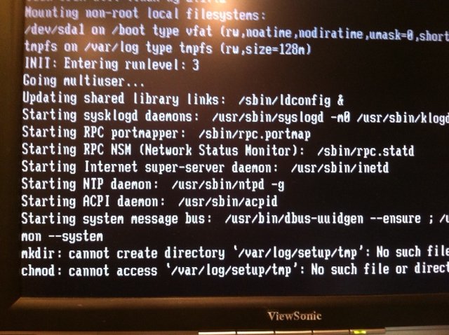

Just tried to update my test server from rc12a, replacing bzimage, bzroot and syslinux.cfg but it gets stuck on reboot stating:
chmod: cannot access 'var/log/setup/tmp': no such file or directory.
see attachment.
I ran a disk checker on the usb stick and that came back ok
edit: i have no idea why it's preview is upside down!?, but downloaded it's the right way!
Second Edit: Just put 12a back on by overwriting those 3 files and it's working on 12a.
Any ideas?

try to redownload the rc15 release and install it again.

I think it's a side effect of mounting tmpfs on /var/log.
/var/log should probably be renamed.
a new mount point made, then have the old structure copied over.
Either that or remake all the directories.
re-downloading will not fix this particular issue.
i did download it twice as firstly i cpoied the files over on a mac, but thinking this may be a contributing factor, re-did it all on a PC.

Do you have any slackware packages in /boot/extra ?

Tom, in your source tree where you build the image, Are there any other directories in var/log ??

First of all i did (plex), but i could see it hanging at that part of the boot process, so i deleted it and tried again clean. Unless there are other files left over causing issues?
Yes there's /var/log/samba, so I had to change /etc/rc.d/rc.samba to create that directory if it wasn't there already.  There is also /var/log/setup and /var/log/setup/tmp.  These directories are used by the slackware package tools.  I verified they did not need to be there for a 'stock' startup, and afterwareds, I manually executed an "installpkg" command and noted that /var/log/setup and /var/log/setup/tmp got created, so I thought all was well... but apparently not.  :P

There's no "old" structure there. It's mounted VERY early in the boot process, before anything else starts loading. And, I can't seem grep any 'var/log/setup/tmp' in the stock package. Can it be something extra that he has added, in his 'go', or as a package?
my "go" is stock and packages DID have plex in it, but i removed that. Anything on top of that would mean going back to complete stock and adding the plugins manually, which isn't particularly friendly and encouraging to update for each release.
Not suggesting that would be the permanent necessity, but would help to determine what this problem is.
I wonder why samba creates without problem its /var log/samba on my server. Anybody else's server frozen like that?
It's created when the package is installed, not when it's started.
Come on, guys, it took us so many years to mount /var/log/ properly, let's please not cast shadows of doubt on it so quickly! :)
