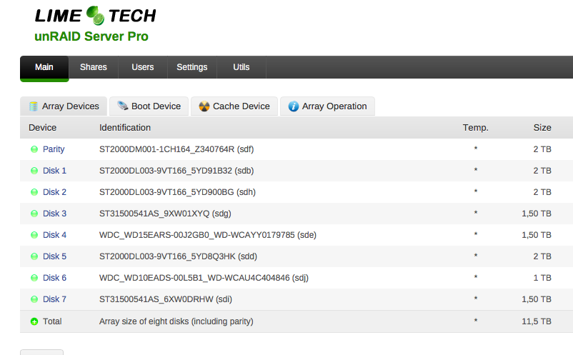

Hello,
I´m not a linux expert but I notice the %cpu increase in the stats plugin. It shows min 20% and peaks about 40% in User %CPU. Then I unraid first (Top info) and telnet later and begin tests. If I´m not wrong its not a 1% (I don't spend two hours testing for that  ;D). In top we have the 1-5-15 min average CPU use, what I wrote in bold in my previous post and as I understand (and read) Active values are not really ok. I have a dual core so 100% CPU load its 2.00, 1.00 its 50% CPU load and as you can see TOP values are in line with it was shown by Stats plugin 0.70 average in 5 minutes  its a 35% CPU load in my dual core.
But I might be wrong.  ;)
Other is that I notice a not usual behavior or my parity drive. It keeps spinning. If I push "spin down" button parity spin down but return up in about 20-30 minutes (testing now).
I am investigating this as well, because I have never seen or heard about this before (SF uses the same mechanism).
The disk health plugin does a background status check every 10 seconds and polls all available disks sequentially, there isn't really a difference between first and last disk (at least there shouldn't be).
The background health check is only active when the health page is open, moving to another page view will stop the background health checking. Any disks which are spun down are not health checked unless the option "Enable background polling for spun-down disks" is set to yes.
Now a couple of questions:
1. The interval after which the parity disk goes "on" is 20-30 minutes ?
2. You observe this while looking at the disk health page (which is opened for the duration you mentioned) ?
3. What setting is "Enable background polling for spun-down disks" ?
4. What is the spin down time of your parity disk ?
5. What brand/model is your parity disk, is it different from your data disks ?
6. Does the parity disk connect directly to the MB or do you use a separate controller card ?
Since last night I delete disk health parity behavior its correct, no spin-up of any drive itself. I´ll try do more test tonight.
To your questions:
I think so, sure more than 10 minutes
No, main page or stats page.
off
same than all array. 30 minutes.
I attach a picture 1 seagate parity, 5 seagate data, 2 WD data, 1 seagate cache
MB
And this maybe its important: Even with "Enable background polling for spun-down disks" disabled in Health tab if I click in seagate drives that drive spin-up. If a click in a WD drive, that drive show information but stay spin-down.
If you want I do some test please ask for it  :)
best regards

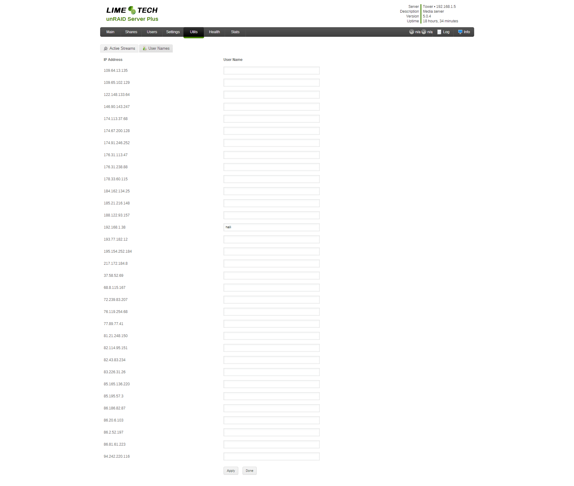

Hey, I installed this last night and noticed something weird today.. I installed a bunch of the plugins, and when I was checking the User Names in Active Streams I can see a bunch of WAN IP's in the list. I don't know what to make of this.. Are a bunch of people from around the world trying to access my server?
The server is connected 24/7 to a vpn with the OpenVPN plugin, if that makes any difference. Also I have utserver installed for torrenting.
**EDIT**: okay, I figured it out. I reinstalled the active streams so the user names table would be reset. Then it only showed my local ip's who were accessing the server. Then as soon as I started a torrent on the utserver the table got flooded with peer IP's from that torrent. No hazard in that, but a weird bug.
The current implementation isn't selective enough, it takes all established sessions to create the users list, including non-relevant ones (like utorrent). Next version will have this corrected. Thanks for testing.

To solve the issue with the stats tables I had to move away from a min-max width setting. It used to be between 960 to 1240, but now is fixed to 1240. Will do some tinkering to see what can be done.

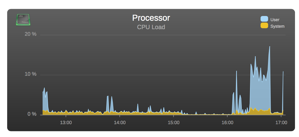

back to topic  ::) today I reinstall Stats to be sure that plugin wasn't responsable of the always spin-up parity and it doesn´t  :). All drives works as they should be. Spin-up/down same way than stock GUI. Disk health guilty¡¡¡ Seagate and their crappy firms more guilty¡¡¡ (I´ll do another test to be 100% sure)
Speaking again about active/disable mode  :) a picture better than one thousand words.
To understand the graph:
From 12:30 to 15:10 "Disable" mode on. Unraid was "streaming" to Raspberry two animation films, average 6 Mbps nitrate, only 1 connection to the server.
From 15:10 to 16:05 Unraid was in a no task mode. All disk spun-down.
From 16:05 to 16:25 In XBMC Rpi I did first a clean video database then a update library. Unraid spin up 4 drives.
From 16:25 to 16:45 I turn on "Active" mode and stream again an animation film, same 6 avg bitrate to Rpi. Same task than 12:30 but now USR %CPU is lot higher. Webgui webpage is open.
From 16:45 to 17:00 Webgui closed.
17:00 Open webgui - go to stats - get picture
So:
Active mode has about 10% CPU use in a Intel Dual core G1610. Yesterday test shown about 20% but maybe was due to Disk health plugin, not installed today.
There is no difference if your are in main page or stats tab.
Active mode only increase CPU if webgui is open.
