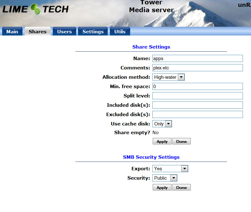

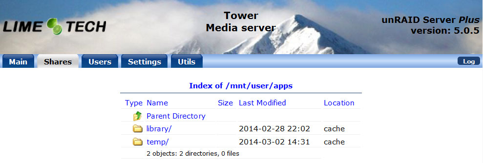

New user, new install of 5.0.5 plus.
Do I miss some essential files/packages to perform this script?
Tried to run it manually, and it gives me this error:
root@Tower:/boot/custom# cache_backup.sh
-bash: ./cache_backup.sh: /bin/bash^M: bad interpreter: No such file or directory
I have not edited the script, and I have Plex in my cache drive, at /mnt/cache/apps
I also have a share at mnt/backup
terminal:
root@Tower:/mnt/cache/apps# ls
library/  temp/
cache_backup.sh
#Backup cache via rsync
date >/var/log/cache_backup.log
/usr/bin/rsync -avrtH --delete /mnt/cache/apps/ /mnt/user/backup/unRAID_cache >>/var/log/cache_backup.log
I even tried to change /mnt/cache/apps/ to /mnt/user/apps/ since this is what it show inside unRAID? This confuses me a bit :)
Happy for any hint or sollution :)
