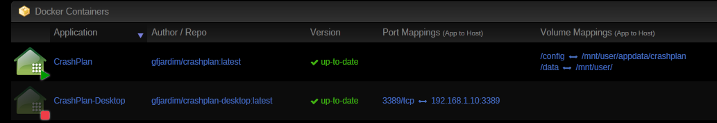

You do not need the 3389 port mapping for the CrashPlan Engine, just the desktop docker.  Get rid of that mapping as it is causing you problems.
You should also get rid of the /config mapping on the CrashPlan-Desktop as --volumes-from CrashPlan (looks like you may have something extra there as well) is all you need.
See my examples below:

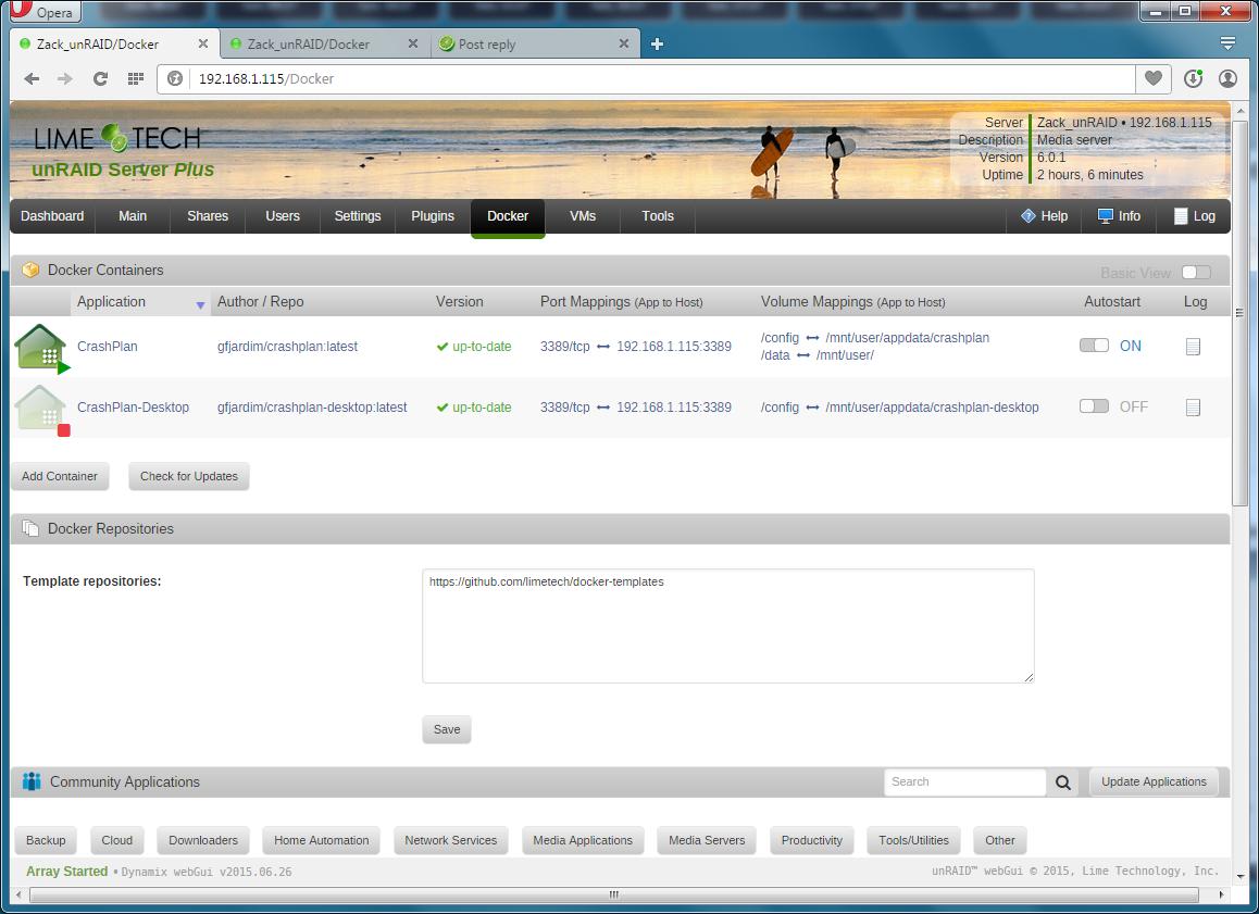

I cannot seem to get CrashPlan-Desktop to install.
When I first added the container I was thinking that I needed to do volume mapping.  Then I saw ljm42 post
I don't think there is a one-size-fits-all configuration for CrashPlan server or desktop.  I guess that is what makes troubleshooting the problem a bit different for everyone.  Some combination of the solutions mentioned is this thread will likely help most, but, there does not seem to be one config to rule them all.
My config is working fine without the disks mapping but needed the .ui_info fix:
Remove the volume mapping for /config -> /mnt/cache/appdata/crashplan-desktop.  that conflicts with  --volumes-from CrashPlan
After removing the container and the image I tried again.
This time I I did not change anything after hitting add.  I left the volume mapping empty I left the port mapping the way it was (Container 3389 > host 3389) and I had left the --volumes-from CrashPlan in the Extra Parameters section.
After hitting add I get the following:
Command:
root@localhost:# /usr/bin/docker run -d --name="CrashPlan-Desktop" --net="bridge" -e TZ="America/New_York" -p 3389:3389/tcp --volumes-from CrashPlan gfjardim/crashplan-desktop
time="2015-07-30T17:01:23-04:00" level=fatal msg="Error response from daemon: Could not apply volumes of non-existent container "CrashPlan"."
The command failed.
I am not sure what I am doing wrong.  Are there unRaid settings that I need to change.
I am running 6.0.1
This is a fresh install of 6.0.1
My docker image is at the root of my cache drive mnt/cache/docker.img
I have my appdata on the cache drive as a cache only share mnt/usr/appdata
I deleted any share that I created specifically for crash plan during my first attempts.
Thanks for any advice.

Have you installed the CrashPlan docker (Not the Desktop version) You need both, CrashPlan is the service and the Desktop is just a conduit to configuring the CrashPlan docker.
Command:
The command failed.
I am running 6.0.1
Albin
Thanks for pointing me in the correct direction.  I installed the crashplan service.  Looks like things are working now.  Thanks for your help!

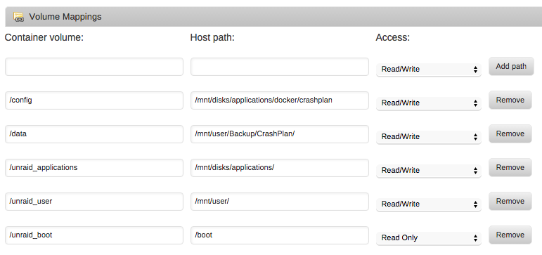

Is there a way to backup the flash share using Crashplan docker?  I figured out that in the Crashplan Desktop docker app, all of the user shares are listed under the "data" folder, including the the appdata, docker.img and other contents of the cache drive... however I have searched through the folder tree and cannot find the flash drive anywhere.
Flash is probably the most important content to back up... how can this be done with the Crashplan docker?
Interesting question - I like and am also keen on this.
I tried creating a volume mapping to /boot, but that didn't want to work (/boot doesn't even show up in the host path drop down).
I created a soft link from /cache/boot to /boot (ln -s /cache/boot /boot). But this, to me at least, is quite a large security risk. It could inadvertently give access to the flash files where you don't want it, especially if /cache is shared.
Another option that springs to mind... create a backup folder on either the cache or a disk / user drive. Don't export it and create a cron job to copy all files periodically. Or do this manually each time you upgrade or change anything (which is what I do - each time I upgrade I backup the entire flash drive to my windows file server which is subsequently backed up to CrashPlan anyhow :)).
UPDATE
Seems you can do this:
[*]Create a mapping in the advanced settings. I did /boot to /boot, and made it read only.
[*]Open the CrashPlan client and click the Change button on the backup tab
[*]Check the "show hidden files" checkbox in the client (I'm using the CrashPlan-client via RDP from the host).
[*]Once you've done this, all sorts of wonderful folders spring to life. Including /boot.
[*]Select it and ok away, presto it is backing up (238 files for 700 MB in my case)
Currently backing up boot > bzroot (7.59% @ 2.6Mbps)

This "mapping"... do I do this under the Environment Variables heading and put "/boot" in both the variable name and variable value fields?  That doesn't seem right..
Or do I put /boot under both corresponding container volume and host path fields under the volume mappings heading (which does not require advanced settings slider to be toggled)?
Ok I found the advanced settings slider...
Shouldn't need to.  I just did the following in the volume mappings with no further changes.  I called mine "/unraid_boot" in the CrashPlan docker, set it to map to Unraid's /boot mount point as Read Only, and then used the CrashPlan UI to select and backup that entire directory.  Mine didn't show up as a hidden folder, so it was all pretty straightforward.
Thanks... I just realized something when I tried this:
1) If you do a /boot to /boot mapping, then when you select show hidden files, your unraid flash shows up in the boot folder.
2) If you do any other mapping to the host /boot (e.g. /unraid_flash to /boot) then you will see that volume mapping in the crashplan desktop app without having to turn on show hidden files... but in this case, if you turn on show hidden files, then the /boot folder appears empty.
So, you can do it either way I guess.  I went with option 2 only because if I am viewing my crashplan backup from the website or say an iPhone app, it will be easier for me to recognize that the folder contains the unraid flash contents vs a "boot" folder which could seem ambiguous among all of the other folders being backed up.
