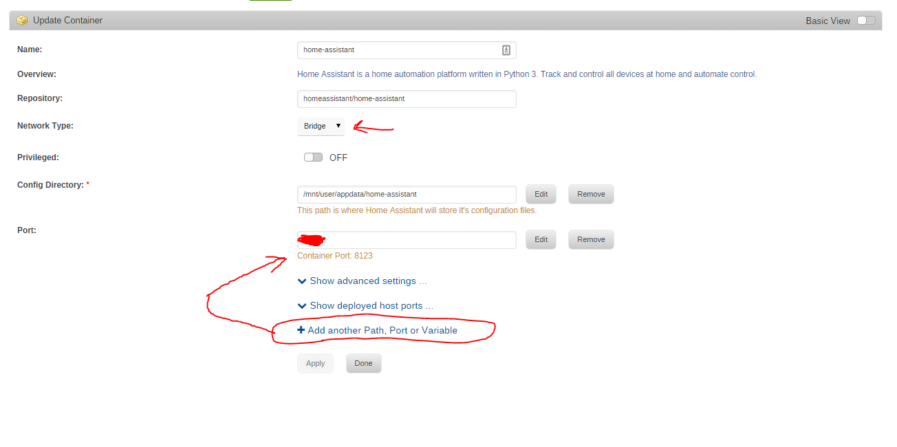

When you are about to install it (or after you have done so), you just need to make 2 changes to the config:
1. Change "Network Type" to "Bridge"
2. Add a port that points to 8123 in the container
Thanks for this tip. Installed with no issues and could load Web UI.
Scratch my last comment. If i set network type to "Bridge" instead of "Host", Home Assistant "Discovery" does not work for some reason.  None of my devices cannot be discovered like sonos.
I had to also remove the port mapping since it's in host mode since it's not necessary. Default port of 8123 works fine to load webui
