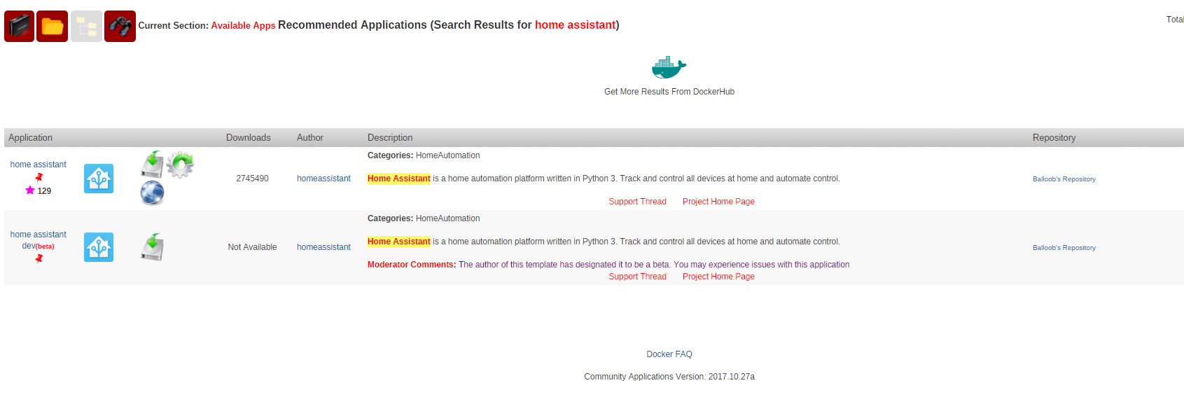

I'm curious.  I'm running home-assistant by adding the docker that comes up when you search in CA:
59fb41cb1185d_FireShotCapture55-Highlander_Apps-http___172_30_12.2_Apps.thumb.png.dc6cc558fcf289db6f6ee72210287206.png
What's the difference between that version and this one?  Thanks
