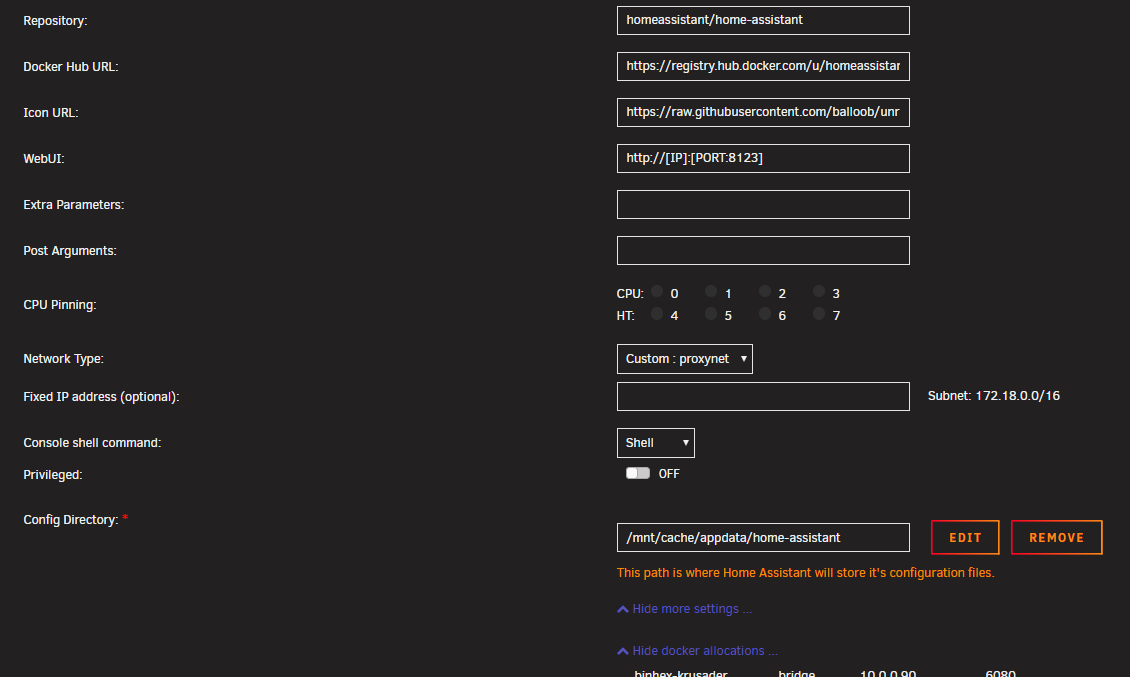

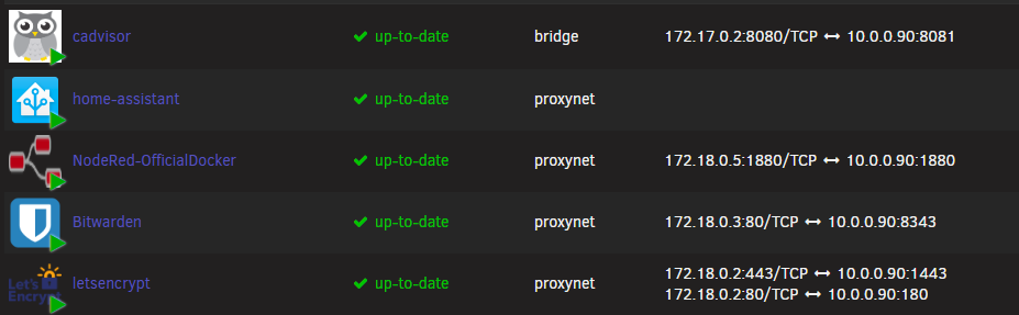

My HA container started acting weird after one of the recent updates.  I have it so I can access it through nginix and letsencrypt as detailed by SpaceInvaderOne.  For some reason the Port Mapping and port config went missing:
The other containers in the "proxynet" network, NodeRed & Bitwarden, are working as intended.
I've tried uninstalling, removing, re-installing the HA container multiple times.  Any ideas?
Edited by kimocal
image update

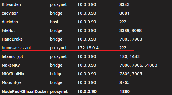

Just FYI what I discovered as I switched from HASS in a VM to just the main container using a fixed IP in bridge mode:
1) HASS removed the docker port mapping, so Unraid will not show ports, and the web UI link will not work. I could not find a way to make Unraid do explicit port mappings or how to make the web ui link work, e.g. like I would manually do using docker compose when adding ports.
2) HASS runs as root, workaround is to use this solution, such that appdata permissions work as expected. Copy the run script to appdata folder and add execute permissions (or git clone and copy run file to correct folder). Edit docker config in advanced mode and add "--user 99:100" in extra parameters section. Add env UMASK and set value to 007. Make sure all config files in appdata are deleted, other than run, start container, and permissions will be correct.
Hope this help somebody.
You won't.  As soon as an app is on its own separate IP address, all port mappings are meaningless as the container will utilize whatever ports that it chooses (ie: the default ones)
IIRC there is an issue with the webUI entry when using an app on it's own IP.  Either bookmark the appropriate URL in your browser, or try enabling authoring mode in settings - docker (you have to stop the service first), and explicitly specify the appropriate URL in the webUI entry (advanced view)
Yep, I understand the meaninglessness of mapping ports in bridge mode, but without it the web UI link does not work.
Of all my containers running in bridge mode, home assistant is the only container where the launch web ui link does not appear.
Most other other containers do list port mappings such that they work correctly in host or bridge mode.
Would be great if the web ui link always works, maybe use port mapping, or use IP address assigned in bridge setup.

I have Home Assistant docker installed.
I noticed that when I go to the webgui, it now shows it's deprecated.
when I click on the button, i get
I read something about lovelace being the new ui.
https://www.home-assistant.io/blog/2019/01/23/lovelace-released/

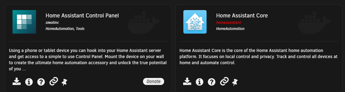

When I search in unraid Apps for home assistant, I get the following
So is this docker going to be updated, or should I remove the docker I have installed and install the above Control Panel or Core dockers?
Just trying to figure out how to get the on latest docker for Home Assistant.  I don't like the Deprecated flag, as that means this version should be replced.
Thanks!
