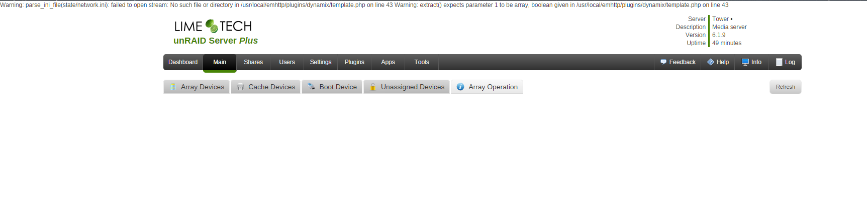

Hi Bonienl,
Seems to be this specific update caused my 6.1.9 webGUI to be unusable, the PLG seems to be have been intended for 6.2 and not 6.1.9
Any ideas on how can I roll back?
Error: Warning: parse_ini_file(state/network.ini): failed to open stream: No such file or directory in /usr/local/emhttp/plugins/dynamix/template.php on line 43 Warning: extract() expects parameter 1 to be array, boolean given in /usr/local/emhttp/plugins/dynamix/template.php on line 43

Hi Bonienl,
Which plugin are you talking about?
The plugin Dynamix SCSI devices is/was for unRAID 6.2 only and shouldn't install on 6.1.9.

Hi Bonienl,

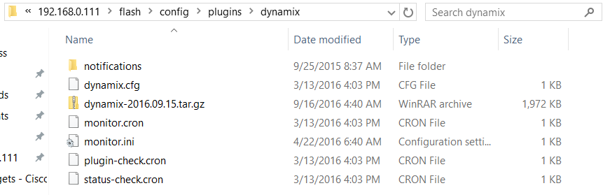

Hi
Its the webGUI plugin itself.
As can be seen below, there was an update yesterday which was pushed automatically(not sure if I chose auto update, or thats just the way it is) and before that I was happily using the webGUI for various operations. This morning, hen I went in to activate a VM,I was greeted with that error and have not been able to use the webGUI ever since. It responds to my clicks, but doesn't load properly. It seems to be trying to find files which are not supposed to be there, as if the dynamix made for 6.2 was somehow pushed to my 6.1.9 build (or something like that)
thanks
Right, I needed some time to this after 6.2 stable became available. Latest version is 2016.09.15.
Corrected typo
Hi Bonienl,
Hi
thanks
I responded to your other post on this as well.
- Delete the file /config/plugins/dynamix.plg on your flash and reboot
- There is no auto-update in stock unRAID, my guess is it was auto updated by CA, but the 6.2 GUI shouldn't have been available for 6.1.9 in the first place...

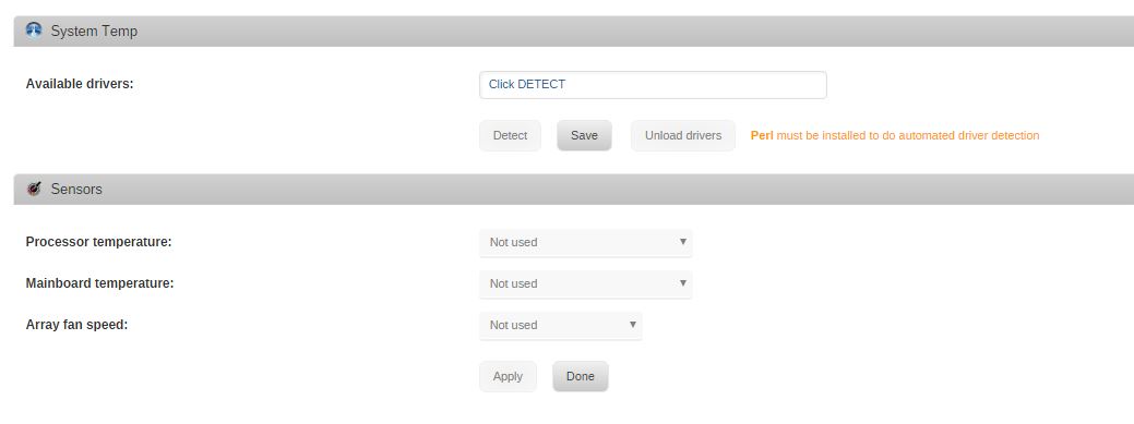

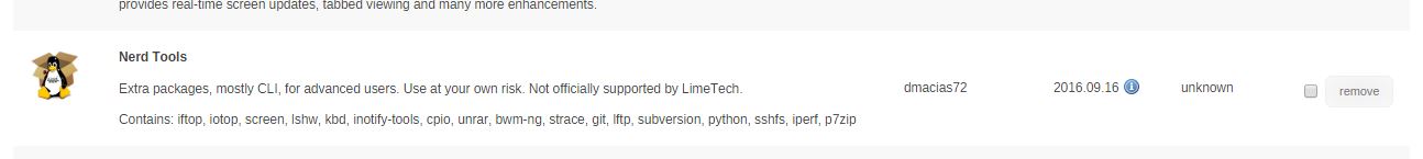

I installed the Nerdpack to get PERL so I could use Dynamix System Temp.  I rebooted, but it still grays out the "detect" button uner the System Temp screen and says "Perl must be installed to do automated driver detection"
I noted PERL is in the list at the begining of the sticky for Nerdpack.  However it doesn't appear in the list under "Nerdpack" on the plugins tab.
See attached images and diagnostics file (just in case). My configuration below is current.
todd-svr-diagnostics-20160916-1622.zip
Goto settings, nerdpack and install perl there..
Hi
Dang... same issue here.  Anyway to do this via SSH?  The Flash drive is not set as a share and the ability to physically remove the computer is very difficult (well above head level, lots of back twisting, very very limited maneuver room.
Yes, telnet or SSH into your system and type
rm /boot/config/plugins/dynamix.plg
That did the trick!  Fantastic :)  Many thanks!
