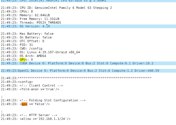

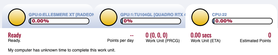

yesterday had the GPU Folding, but now stay on "ready" in the Advanced Config tool (on a Windows PC connected to the Unraid Docker).   Also, get a lot of those :
12:10:55:WU01:FS01:Connecting to 65.254.110.245:8080
[93m12:10:55:WARNING:WU01:FS01:Failed to get assignment from '65.254.110.245:8080': No WUs available for this configuration[0m
12:10:55:WU01:FS01:Connecting to 18.218.241.186:80
[93m12:10:56:WARNING:WU01:FS01:Failed to get assignment from '18.218.241.186:80': No WUs available for this configuration[0m
[91m12:10:56:ERROR:WU01:FS01:Exception: Could not get an assignment[0m
Do you guys know if it's because F@H doesn't have anything work for GPU ??  I doubt it, but maybe it's why it doesn't fold ?

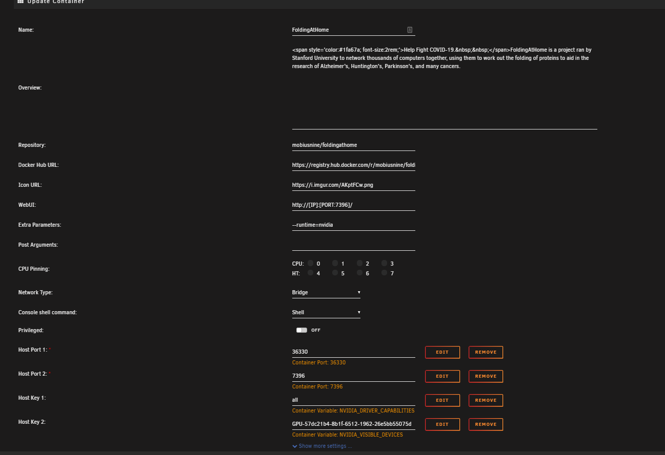

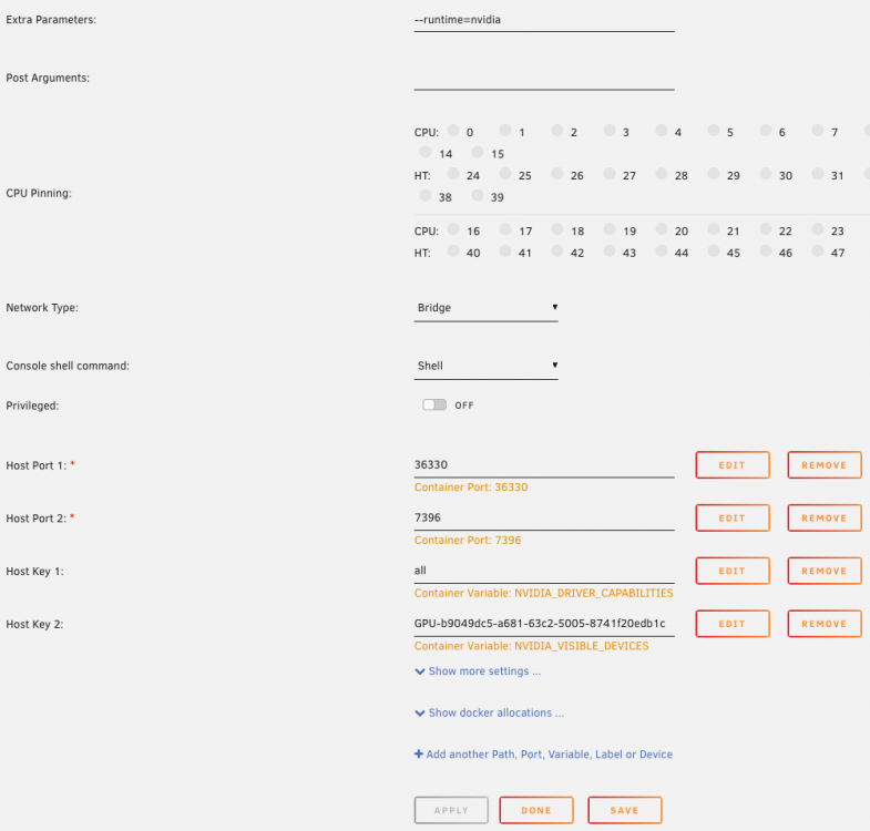

Still can't get gpu encoding to work - added the uuid to it plus all under nvidia driver capabilities and i added extra parameters - in logs it doesn't detect gpu - i'm using the p2000 right now in other containers
picture of your docker setup?
