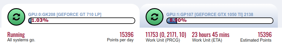

1420911743_Schermafdrukvan2020-03-2122-11-26.png.95f7ae21bc41c6f1cd9ab22220b033fe.png
2 GPU's assign to FaH, bold are working, no cpu slot enabled (it still use some cpu cores to pass work to the gpu's, for my setup its using 4 cores +/-75%)
config.xml:
  <slot id='0' type='GPU'/>
  <slot id='1' type='GPU'/>

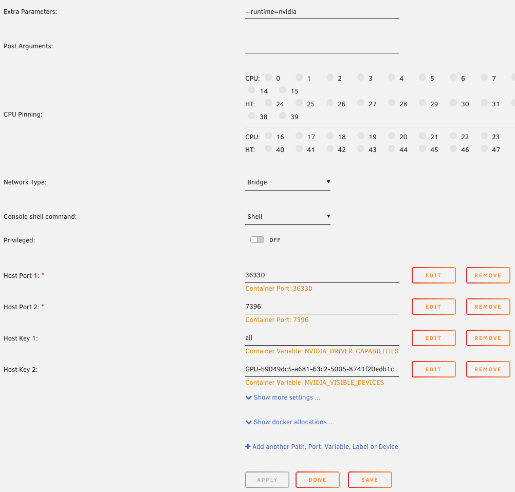

Docker setting, NVIDIA_VISIBLE_DEVICES:
all
if you have a nvidia gpu assign to a VM make it disabled for FaH! or the system will crash.
I'm not really sure how to do that (i have an AMD card) but if i understand it correct you can change the syslinux configuration:
pci-stub.ids=xxxx:xxxx,xxxx:xxxx (IOMMU id, graphic/vga and sound of it!), after change reboot system.

I've been using the docker container to fold with 4 GPUs / no CPU. Everything seem to be working well but I've noticed that the container seems to use a CPU core for each GPU slot, and each CPU core it uses is pinned at 100% utilization. Is anyone else getting similar behavior?
I realize the GPUs have to be fed data to fold, but it seems like that shouldn't take up 100% of a core. The CPUs are Xeon x5690s, so not exactly new, but not slouches either. Can anyone offer any thoughts? Am I misunderstanding something in how all this works?
That's normal. The CPU thread is used to load data to and from the GPU and it's a substantial amount of data to load.
That's why it's important to ensure you pin the right cores for the F@H docker to prevent lag to the important stuff.
