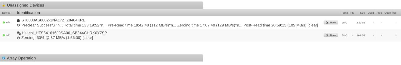

I can also confirm this issue. See attached - my 8TB Seagate drive is showing as 2.2TB and that is sitting on an ASRock C2550 board. In fact it has 3 of these plugged into the array and both Unraid, the core system and the pre_clear script recognize the the drive as 8TB and run fine with these drives. So it must be a little issue with the plugin.
I have also noticed that plugin does not interact with the GUI perfectly (I have checked this on Chrome, IE and Safari IOS and OSX). The columns extend beyond the other columns which makes the page look weird. We don't have to make this an issue - id accept this behavior for the functionality of this great plugin any day!
