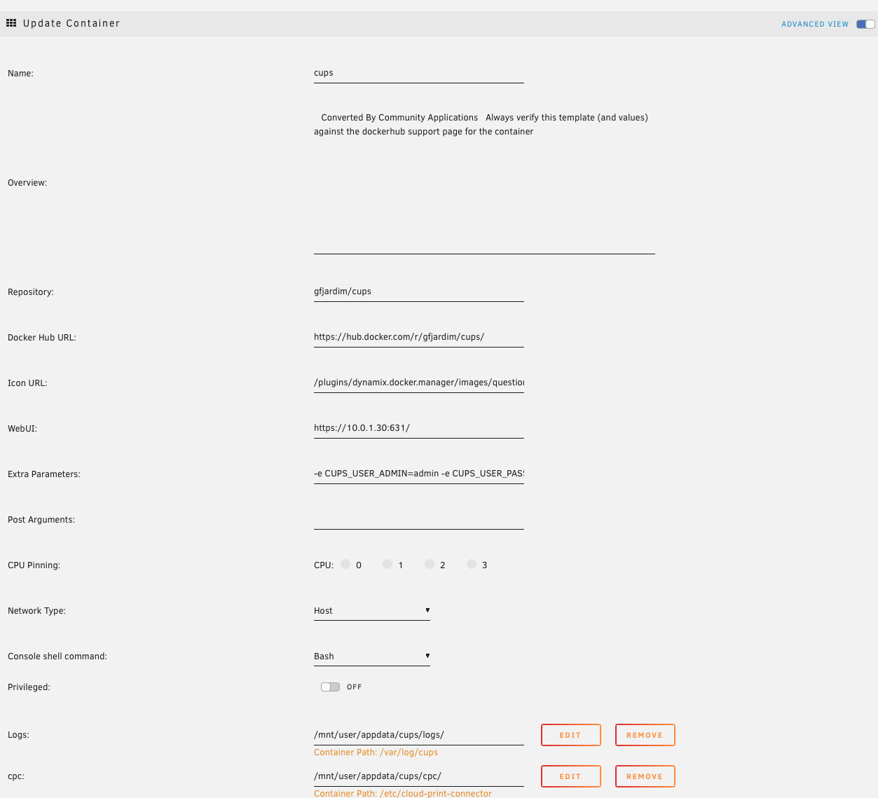

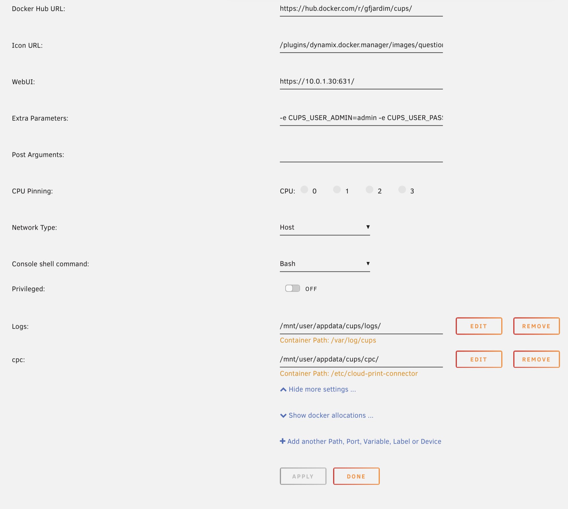

Got it started
Under the Extra Parameters in advanced view I added "-e CUPS_USER_ADMIN=admin -e CUPS_USER_PASSWORD=password"

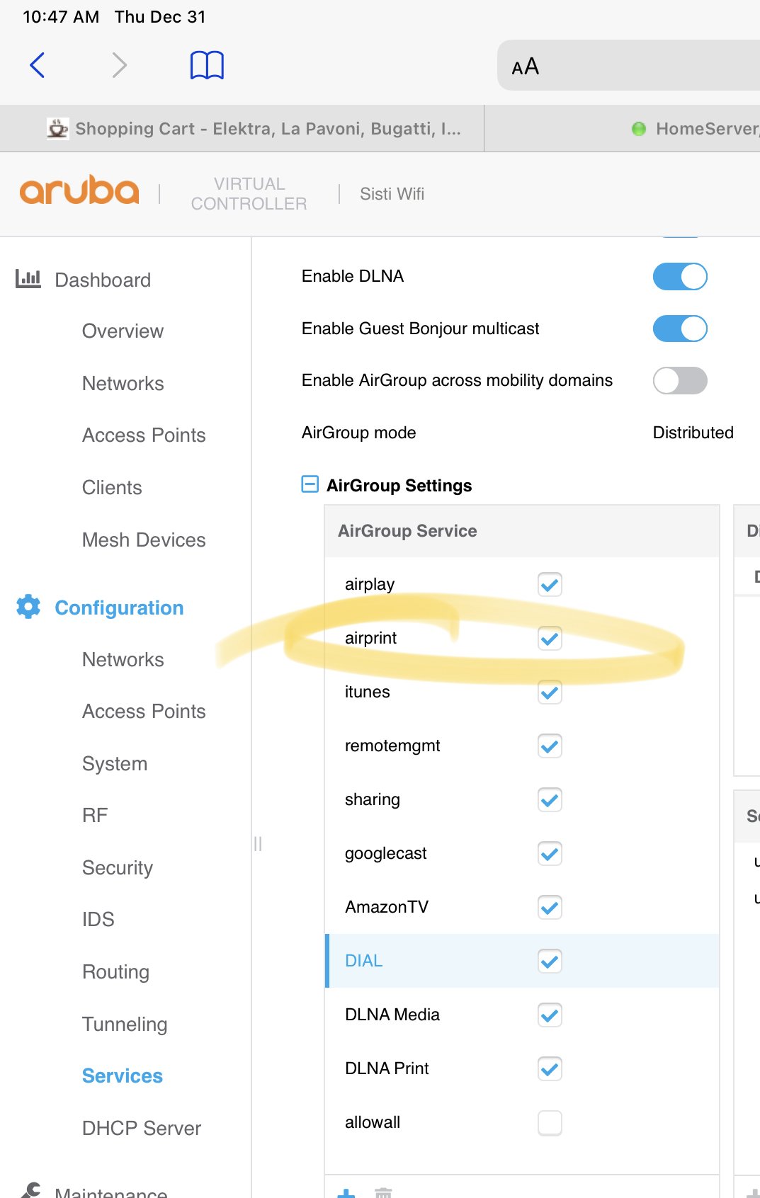

Know what helps a lot?  Making sure that your wireless access points are not blocking AirPrint.....
Yep I guess that helps! 🤣
