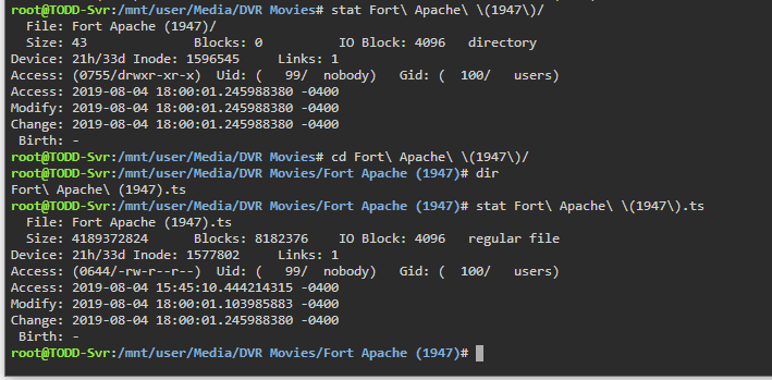

August 5, 20197 yr I've had some earlier posts, about the permissions granted for files that are generated by the Plex DVR using the LinuxServer.io docker. I started a new thread in the general forum looking for more help on the subject : https://forums.unraid.net/topic/82188-file-permissions-issue-with-plex-docker-linuxserverio/?tab=comments#comment-763917 I've had some help there and the most likely issue is the UMASK variable and I'm posting the basic info here so someone can look into a permanent fix. This would only be a problem for someone using the Plex DVR feature and then also wanted to be able to move or delete files that have been created by Plex. I know you can delete files from inside Plex, but 1. I dont want anyone logged in on a TV in my house to be able to make that mistake, and 2. There would still be a host of files and directories that can only be modified by plex, unless the "new permissions" utility is run. There is a lot more information if you go follow the thread in that link, but here are the highlights: Here are the permissions shown using the ls -al /mnt/user0 command: This folder was created using the Plex DVR drwxr-xr-x 1 nobody users 33 Jul 30 20:05 Bxxxxxg\ (2019)/ a similar folder that was created from the old plex (Limetech docker) DVR reads like this drwxrwxrwx 1 nobody users 52 Mayt 15 22:31 Bxxxxxxx\ (2017)/ His comment was: The umask 0000 needs to be called in the docker after the filesystems are created - in whatever entrypoint script is being used. I'd file this as a bug with the LS.IO guys on github or in their support thread. You can readily prove that the UMASK isn't being set properly; EDIT: attached is a screenshot of the file/folder stats created by the Plex DVR. I hope this is enough to get something going. If this is incorrect and the UMASK setting is correct already please let me know. Edited August 5, 20197 yr by TODDLT
August 5, 20197 yr 10 hours ago, TODDLT said: *snip* To back this up; I note that the umask is never being set by this docker. I think there was an assumption made that plex doesn't really "make" a lot of files not inherently used by itself. His use case is that the DVR functionality of plex does create files. Standard linux umask is 0022 which would create perms of 0644 on files and 0755 on directories. That allows the owner to read/write but not other users (such as SMB users, or anonymous SMB). The "normal" umask on unraid is 0000 which results in 0666 and 0777 for files and directories, respectively. I provided him a script that adds "umask 0000" after line 3 of the /etc/services.d/plex/run script of this docker. I believe this should be sufficient to resolve.

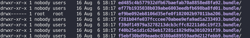

August 6, 20197 yr So I'm attempting to move from binhex-plexpass docker to the linuxserver.io plex docker. I made sure to map the media in the same place as it was on my old docker and transferred the Plex Media Server folder from the old dockers appdata folder to the new one. All seems well until I try and play something. Every video I've tried just sits there like it's loading but never actually loads. I just get the spinning circle indefinitely. I'm wondering if it's a permission issue of some kind but I've made sure I can access all the files from the terminal for the docker once started and everything looks fine from there. I've also tried chmod 777 to the media and config folders. Does anybody have an idea of what could be causing this. I don't want to wipe my database and start from scratch as I have a good number of users and would prefer to keep all my watched data. Edit: Also I have tried with the version variable set to Latest, Public and Docker and the issue happens on both the current public and the latest plexpass version. Edited August 6, 20197 yr by Reallango typo and extra info
August 6, 20197 yr 20 minutes ago, Reallango said: So I'm attempting to move from binhex-plexpass docker to the linuxserver.io plex docker. I made sure to map the media in the same place as it was on my old docker and transferred the Plex Media Server folder from the old dockers appdata folder to the new one. All seems well until I try and play something. Every video I've tried just sits there like it's loading but never actually loads. I just get the spinning circle indefinitely. I'm wondering if it's a permission issue of some kind but I've made sure I can access all the files from the terminal for the docker once started and everything looks fine from there. I've also tried chmod 777 to the media and config folders. Does anybody have an idea of what could be causing this. I don't want to wipe my database and start from scratch as I have a good number of users and would prefer to keep all my watched data. Edit: Also I have tried with the version variable set to Latest, Public and Docker and the issue happens on both the current public and the latest plexpass version. Looks like I figured it out. While it was attempting to load the video I tried clicking 10 sec back button and it threw a transcode error. So I went to the settings for the docker and pointed it at /appdata/plex/transcode/ and when it started back up my videos are playing again. So guess it was a permission issue for wherever it was trying to transcode to.

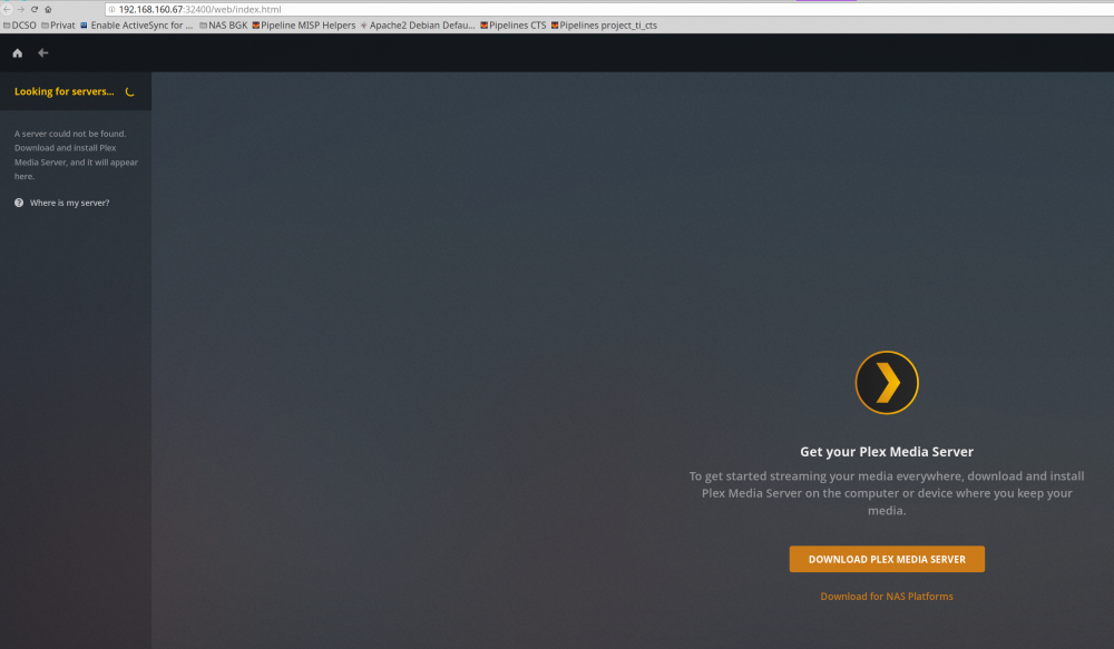

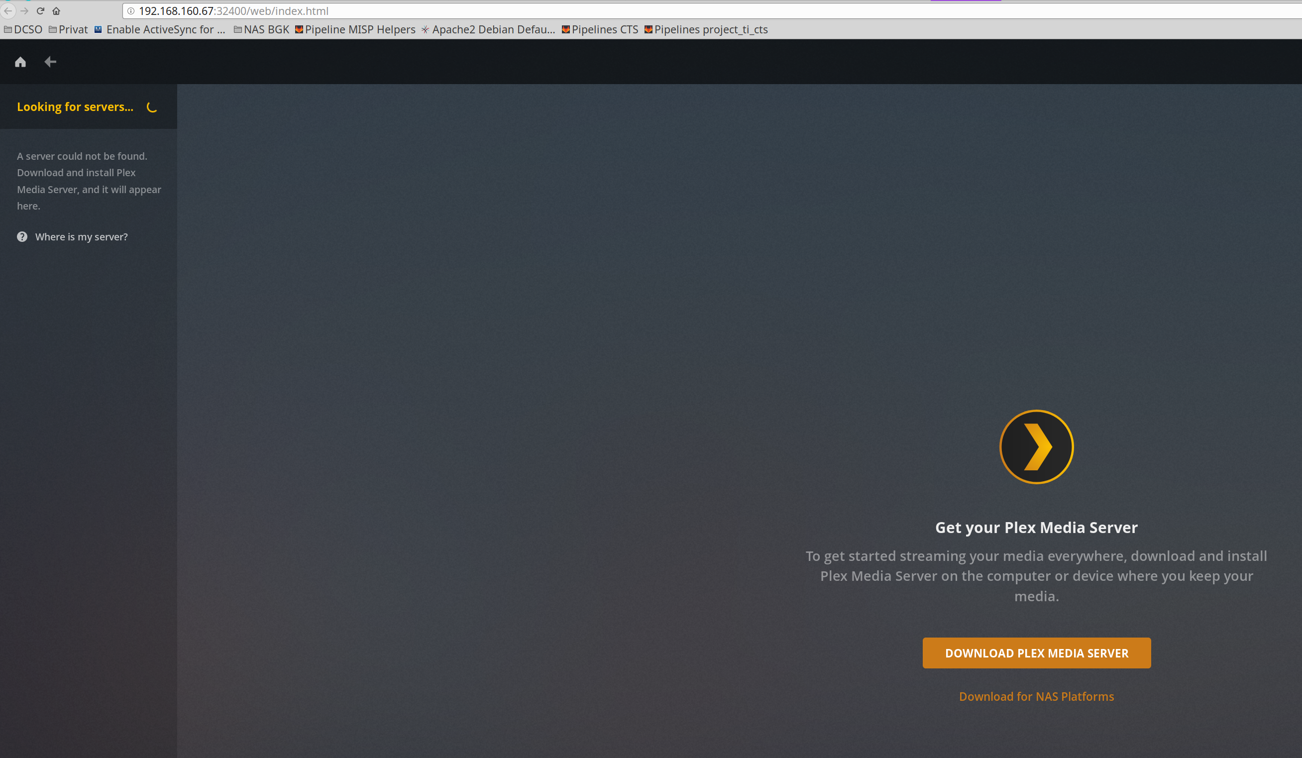

August 7, 20197 yr He Guys, I started the plex ctonainer, but if I access <myhost>:32400 I see the web view of Plex but the "server" is not available.
August 7, 20197 yr 14 minutes ago, 8ear said: He Guys, I started the plex ctonainer, but if I access <myhost>:32400 I see the web view of Plex but the "server" is not available. Is this a new install? Not entirely clear what you mean. Post a screenshot.
August 7, 20197 yr On 8/5/2019 at 5:39 AM, TODDLT said: I've had some earlier posts, about the permissions granted for files that are generated by the Plex DVR using the LinuxServer.io docker. I started a new thread in the general forum looking for more help on the subject : https://forums.unraid.net/topic/82188-file-permissions-issue-with-plex-docker-linuxserverio/?tab=comments#comment-763917 I've had some help there and the most likely issue is the UMASK variable and I'm posting the basic info here so someone can look into a permanent fix. This would only be a problem for someone using the Plex DVR feature and then also wanted to be able to move or delete files that have been created by Plex. I know you can delete files from inside Plex, but 1. I dont want anyone logged in on a TV in my house to be able to make that mistake, and 2. There would still be a host of files and directories that can only be modified by plex, unless the "new permissions" utility is run. There is a lot more information if you go follow the thread in that link, but here are the highlights: Here are the permissions shown using the ls -al /mnt/user0 command: This folder was created using the Plex DVR drwxr-xr-x 1 nobody users 33 Jul 30 20:05 Bxxxxxg\ (2019)/ a similar folder that was created from the old plex (Limetech docker) DVR reads like this drwxrwxrwx 1 nobody users 52 Mayt 15 22:31 Bxxxxxxx\ (2017)/ His comment was: The umask 0000 needs to be called in the docker after the filesystems are created - in whatever entrypoint script is being used. I'd file this as a bug with the LS.IO guys on github or in their support thread. You can readily prove that the UMASK isn't being set properly; EDIT: attached is a screenshot of the file/folder stats created by the Plex DVR. I hope this is enough to get something going. If this is incorrect and the UMASK setting is correct already please let me know. You can set it now with the variable UMASK_SET. The default is 022 if not set.
August 8, 20197 yr 1 minute ago, walterg74 said: Thanks guys, so how hard would it be to migrate to this one? Read back a few pages, there have been a bunch of people migrating in the past few weeks.
August 9, 20197 yr On 8/7/2019 at 1:26 PM, saarg said: You can set it now with the variable UMASK_SET. The default is 022 if not set. Thanks for this. I set it tonight and now recording.. Hopefully its resolved.
August 10, 20197 yr On 8/7/2019 at 1:26 PM, saarg said: You can set it now with the variable UMASK_SET. The default is 022 if not set. Worked! Thanks

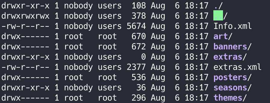

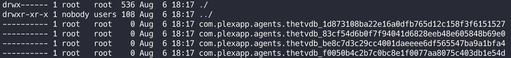

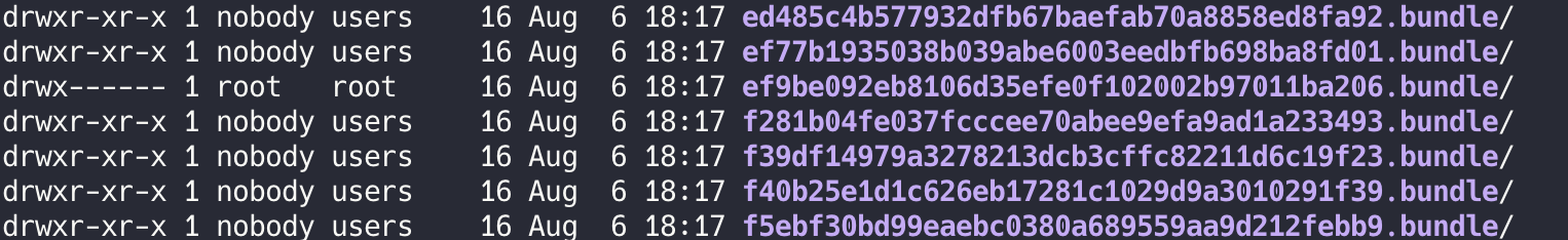

August 12, 20197 yr I looked through my logs and noticed 2 issues I'd love to get help on: First, I'm noticing a permissioning error throughout logs complaining about access to some files in the appdata. e.g. Quote Aug 12, 2019 14:44:27.230 [0x14eb429f4700] ERROR - Couldn't check for the existence of file "/config/Library/Application Support/Plex Media Server/Metadata/TV Shows/3/994bcc630ebaa1adc9d5f673061e4bc6908fdb0.bundle/Contents/_combined/posters/com.plexapp.agents.thetvdb_f0050b4c2b7c0bc8e1f0077aa8075c403db1e54d": boost::filesystem::status: Permission denied: "/config/Library/Application Support/Plex Media Server/Metadata/TV Shows/3/994bcc630ebaa1adc9d5f673061e4bc6908fdb0.bundle/Contents/_combined/posters/com.plexapp.agents.thetvdb_f0050b4c2b7c0bc8e1f0077aa8075c403db1e54d" If I cruise through the folders and file permissions in /Library/ I'm seeing most stuff owned by nobody:users which I thnk is correct. However, I do see some files owned by root:root with 700 permissions. eg. Inside the one of the _content directories, these are the permissions: THen in the offending posters directory, I see these weird permissions: So something seems wrong that those files are owned by root:root, but have 000? 1. How do I fix these permissions safely? 2. How did this even happen to begin with? ----- UPDATE: I ended up just brute forcing this by fixing permissions on every file and dir in appdata: chown -R nobody:users followed by find . -type f -perm 000 -exec chmod 644 {} \; find . -type d -exec chmod 755 {} \; Edited August 13, 20197 yr by tmchow

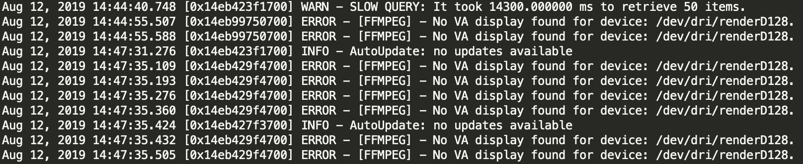

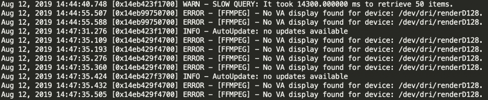

August 12, 20197 yr My second issue is an error I'm seeing in logs related to ffmpeg where I'm seeing this errror: No VA display found for device: /dev/dri/renderD128. e.g. screenshot of logs: I'm not sure if this is always been happening, but recently I added a Nvidia P2000 to my system to get HW transcoding to work (which seems to work since when I'm transcodoing, plex dashboard reports "(hw)" suffix and "watch nvidia-smi" shows the GPU is sued. I also at that time replaced my CPU to an Intel Xeon that supports QuickSync, but not because I wanted to use it for transcoding, just because the CPU was free. I'm NOT passing "--device=/dev/dri" in as extra params since I don't want to use the CPU, but i AM passing in "--runtime=nvidia" since I'm using the GPU. Admittedly I don't' know if these things are related to the error logs. Any ideas what's going on?
