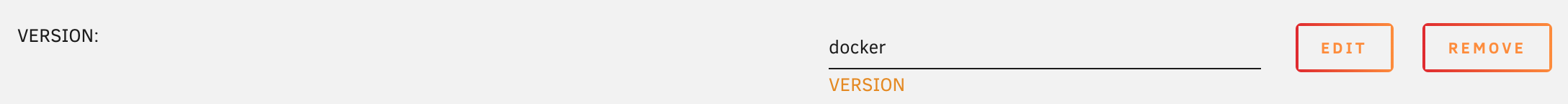

July 24, 20197 yr Just wanted to double check, the version in the settings for this should be set to "docker" right to get the latest?
July 25, 20197 yr 3 minutes ago, yanksno1 said: Just wanted to double check, the version in the settings for this should be set to "docker" right to get the latest? From the docs linked in the first post here are the VERSION options: docker: Let Docker handle the Plex Version, we keep our Dockerhub Endpoint up to date with the latest public builds. This is the same as leaving this setting out of your create command. latest: will update plex to the latest version available that you are entitled to. public: will update plexpass users to the latest public version, useful for plexpass users that don't want to be on the bleeding edge but still want the latest public updates. specific-version: will select a specific version (eg 0.9.12.4.1192-9a47d21) of plex to install, note you cannot use this to access plexpass versions if you do not have plexpass.

July 25, 20197 yr 5 hours ago, yanksno1 said: Just wanted to double check, the version in the settings for this should be set to "docker" right to get the latest? I don't have this option in my docker container, how do i add this
