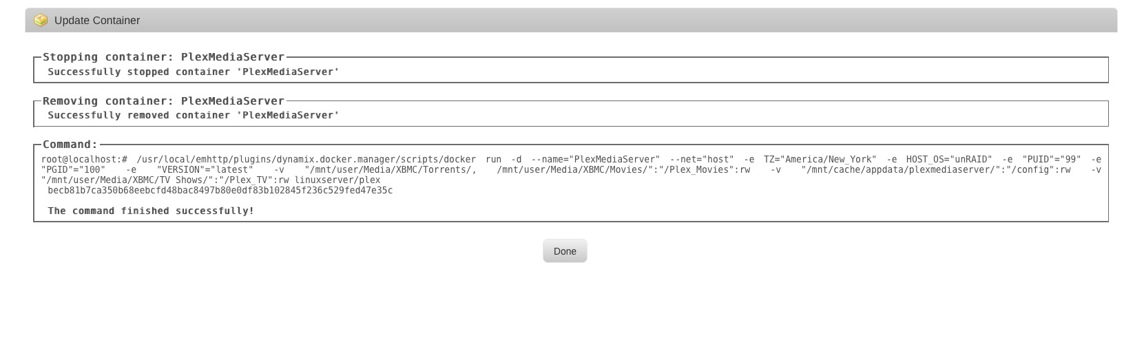

Trying to add a second folder for plex_movies. The gothic readme shows a comma separated list so I used-
/mnt/user/Media/XBMC/Torrents/,/mnt/user/Media/XBMC/Movies/
This isn't working though. Plex is only picking up files from the Movies folder. A syntax error maybe?
Not looking at the readme, but you can't do that.
Every additional folder requires an additional mount point.  IE:  Add another volume mount mapped to the additional host mount.
So add something like plex_movies_2 mapped to /mnt/user/Media/XBMC/Movies/
And then add plex_movies_2 as a second "movies" folder in Plex?
Worked. Thanks.
I see where you got the comma from, but that was only for explaining the media volume mapping, not showing the correct syntax. The correct usage is always in the usage section.
And that is for the command line only. Forgot unraid use a template :)
