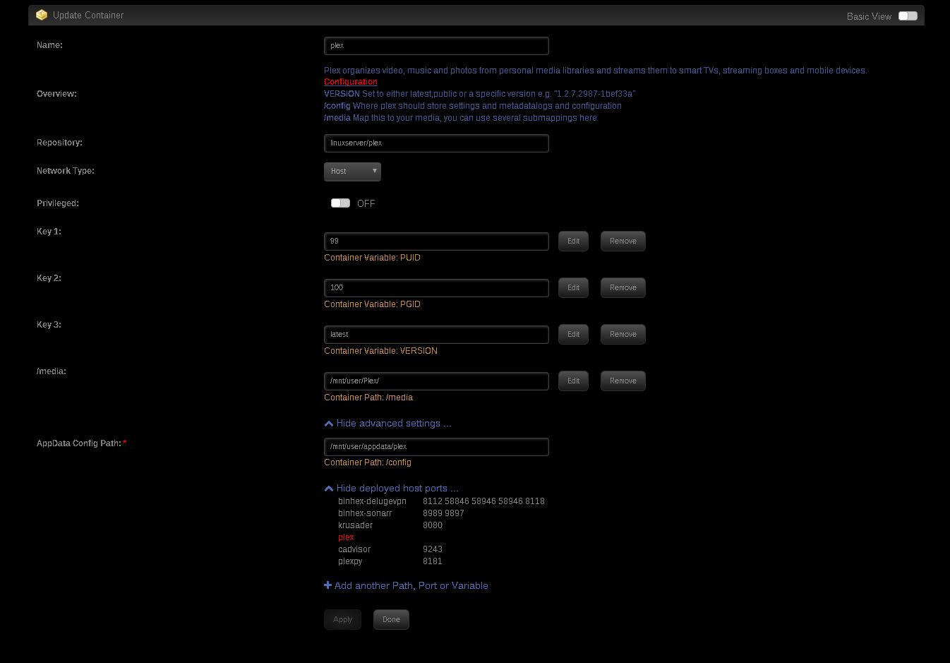

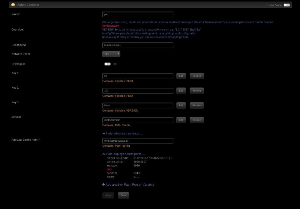

July 22, 20179 yr I am attempting to switch from using a needo template to the lsio plex. I am using the CA interface to generate a "clean" template for lsio plex, and then add my customizations. I want to attempt to use my existing Plex database, so I have added a path that maps container path /config to host path /mnt/user/App/Plex/ . The problem is that when I attempt to add the container, it fails and I get a "Error response from daemon: Duplicate mount point '/config'." message. Apparently "under the covers" a mapping of /config to /mnt/user/appdata/plex is occurring, so the mapping that I am explicitly adding is seen as a duplicate mount point. Is there a way to work around this, or am I forced to use the /mnt/user/appdata/plex mapping?
July 22, 20179 yr Turn on show advanced settings and you can change the built in Sent from my LG-D852 using Tapatalk
July 22, 20179 yr 5 hours ago, Squid said: Turn on show advanced settings and you can change the built in Sent from my LG-D852 using Tapatalk Thanks Squid! I haven't been using the new GUI very long, and I had the meaning of the advanced settings reversed in my head, so I mistakenly thought they were being displayed and that there weren't any..... I'm up and running now.
