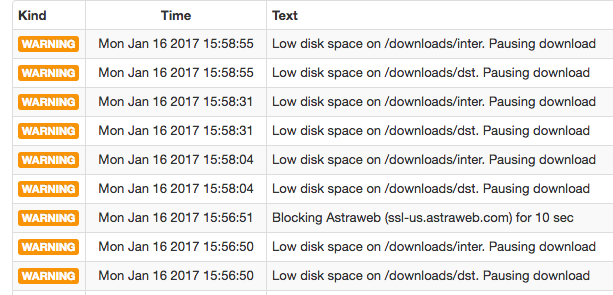

As of the last few days, I keep getting an error "Low disk space on /downloads/dst. Pausing download" and "Low disk space on /downloads/inter. Pausing download" and the downloads keep pausing.
My docker container is located on a cache drive and I do have a lot of space left on it.
In the docker container log, I see this error:
[ERROR] Error saving diskstate: Could not rename file /config/queue/stats.new to /config/queue/stats: No space left on device
Thank you in advance!

Your previous diagnostics was showing lots of cache drive full messages in syslog. Also df was showing it 100% used. You may have to reformat it.
How do I go about doing that? Would I lose the docker configurations?
Should I keep using btrfs for the cache or change it to xfs? What would you recommend?
You can just use the replace cache drive procedure from the FAQ:
How do I replace/upgrade my single cache device? (unRAID v6.2 and above only)
except instead of replacing the drive you can change its filesystem to get it formatted.
If you expect to add additional cache drives in the future then btrfs is the only choice. If you will only use a single cache drive then many people here think XFS is more reliable.
