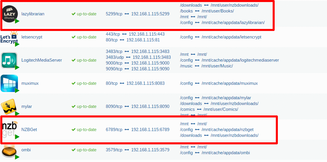

I am having issues getting LazyLibrarian (and Mylar) to play nice with NZBGet.
Books and comics are downloaded fine but just sit in the "completed" folder and are never moved to my library.
Sonarr and Couchpotato are working fine.
Permissions look fine - standard nobody/user. Directories are 777.
I attach my docker setup and logs from NZBGet and LazyLibrarian. Can anyone see anything wrong? I am not seeing anything. I suspect it is some kind of permission thing....

OK - have been on the GitHub site for LL and for LL to work, it has to point to the final destintion. In my case, this is:
/mnt/user/nzbdownloads/completed. This is different than most Dockers? You do not do this for Sonarr or CP....
So now it finds the download. But now I get the following error:
05-Apr-2017 15:36:08 - DEBUG :: POSTPROCESS : Found match (100%): /downloads/Stephen King - The Shining LL.(762530) for Stephen King - The Shining LL.(762530)
05-Apr-2017 15:36:08 - DEBUG :: POSTPROCESS : Processing book 762530
05-Apr-2017 15:36:08 - WARNING :: POSTPROCESS : Destination dir [/Books] not found, using /var/run/s6/services/lazylibrarian
05-Apr-2017 15:36:08 - DEBUG :: POSTPROCESS : /var/run/s6/services/lazylibrarian/Stephen King does not exist, so it's safe to create it
05-Apr-2017 15:36:08 - ERROR :: POSTPROCESS : Postprocessing for The Shining has failed: Unable to create directory /var/run/s6/services/lazylibrarian/Stephen King: Permission denied
05-Apr-2017 15:36:08 - ERROR :: POSTPROCESS : Warning - Residual files remain in /downloads/Stephen King - The Shining LL.(762530).fail
05-Apr-2017 15:36:08 - INFO :: POSTPROCESS : No snatched books/mags have been found
05-Apr-2017 15:36:08 - INFO :: POSTPROCESS : Nothing marked as snatched.
05-Apr-2017 15:36:08 - DEBUG :: POSTPROCESS : Stop processDir job
It cannot find and/or write to the "Books" library. as far as I can see, all permissions are correct....same permissions as Sonarr and CP
drwxrwxrwx 1 nobody users          17 Jan 14 19:34 Books/
Very puzzled. Ideas anyone?
Thanks!
Edited by TexasDave
Very puzzled. Iswas anyone? Thanks!
Looks like you have configured it within the application to use the folder /Books, but your docker has it mapped to /books.
