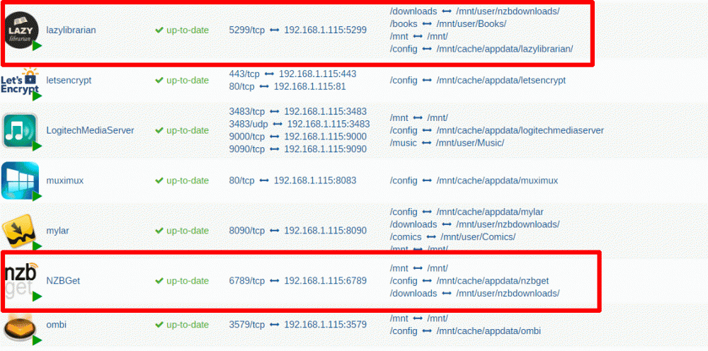

@trurl - Thanks! I am still a bit confused as I thought I had LL to use /books in the docker which points to /mnt/user/Books? And /mnt/user/Books does exist?
I do not see how LL is getting "Books" as it should be using "books" internally? See my screenshot a few posts ago? I attach it here as well.
Mylar is working fine (and is in the screenshot too) and I do the same thing there. The docker has a directory called /comics while the "real" directory is /mnt/user/Books.
I also do this for Sonarr and CouchPotato....
But I may be (and am likely) wrong on this? Thanks!!
Since I don't use this application I have no way of knowing how it is getting Books. The application itself doesn't actually know anything about volume mappings. Indeed, it doesn't even know that it is running in a docker.
I had already seen your docker mappings and that is why I said
2 hours ago, trurl said:
Looks like you have configured it within the application to use the folder /Books, but your docker has it mapped to /books.
What you haven't shown us is anything from the application itself that tells it what folder to use. The log seems to indicate it is using /Books instead of /books.
@trurl - many thanks! I went back through everything and now it works. There were two issues:
  • LazyLibrarian wants to be pointed at the "completed" directory for NZBGet. (Same with Mylar). This is not the same as Sonarr or CP. I confirmed this on the Github issue page.
  • I then DID have a typo in my Mylar settings. You were right, :-) I accidently had it as "Books". I had it right in the unRAID page but made a typo in the app settings. I find it a bit weird that LL (and Mylar) ask for this (again) when the Docker specifies it? But in the end, it was a typo by me.
Sounds like you don't really "get" dockers. As I said
The application has no way of knowing anything about how the docker container it is living in is configured.
3 minutes ago, TexasDave said:
One of the unRAID "elders" advised me to do the /mnt <--> /mnt/ mapping while debugging another issue.
That is just a cheap and easy (and insecure) way of getting things figured out. It shouldn't be considered a permanent solution. You have basically given those docker applications complete access to all of your files, even the files that it doesn't need to work with. And it makes it easier for you to misconfigure one of the applications so it does something to some file or folder that it shouldn't have access to.
I will delete the /mnt <--> /mnt/ stuff. Someone told me it was a "best practice". Apparently it is not. :-)
And you are right, I am still getting my head around dockers. I think I mostly "get" it (but am still learning).
I guess what I got / get confused about is that when I configure things in the "Docker Page" in unRAID (like where to store your books) I thought that every place LL used "/books" it was actually using "/mnt/user/Books".  Kind of like a #define in my old, old, old life as a C coder. I guess not.
I think part of the issue was my typo as well. I thought the log was somehow saying that "Books" did not exist not realizing I had a typo.
Anyways - it is sorted as usual thanks to help from the community. Many thanks again!
Definitely not best practice.   It's an approach to use with people who can't get their head around docker mappings, and I know you can. :D
The mapping happens at the level of the docker engine. The docker container has the mapping between container volumes and host volumes. The application living inside the container only knows about things inside the container, such as the container volume. It doesn't know anything at all about the host volume, or even that it exists.
