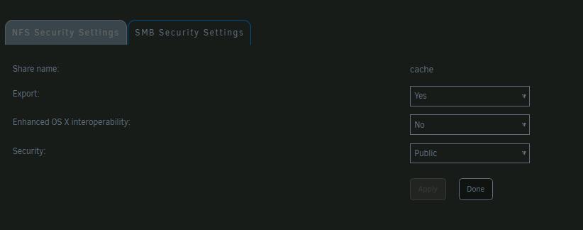

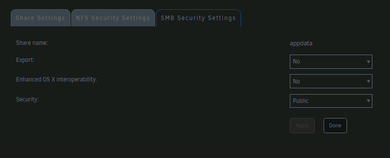

that looks ok, so check your Shares/Security, ensure 'User Shares' and/or 'Disk Shares' are set to 'Public', examples from my setup:-
and:-
and:-
