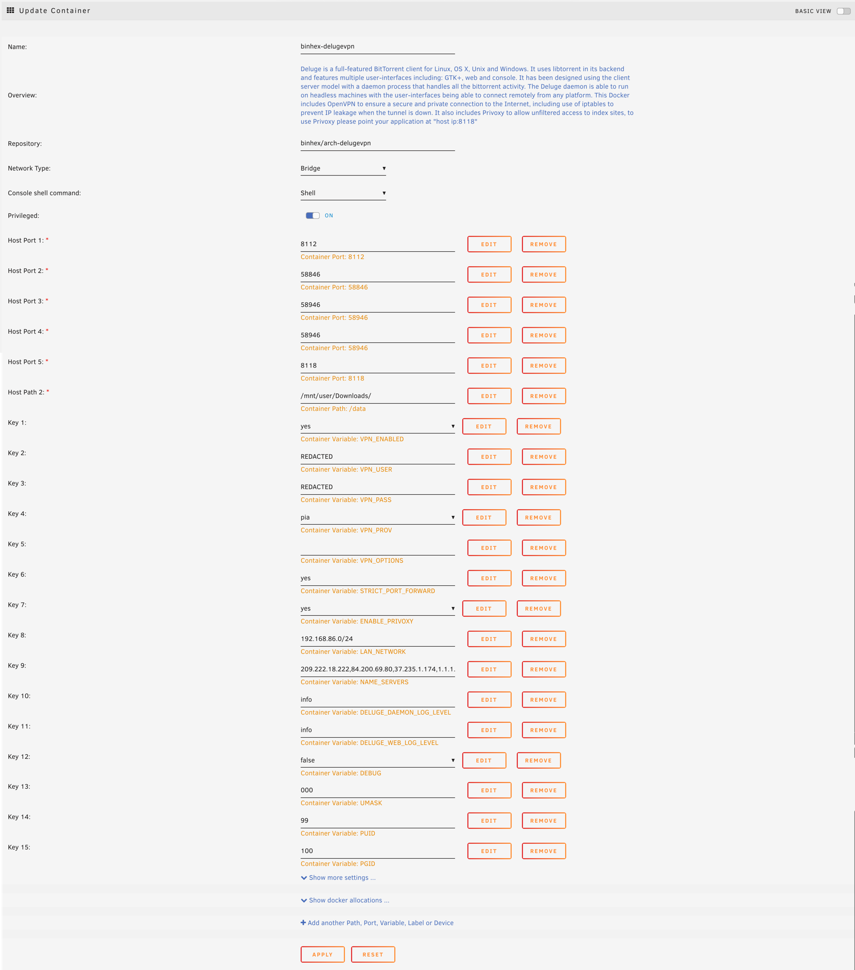

I have been sailing with Deluge for some time now without issue.  I have VPN enabled in Deluge routing thru Toronto.
I rebooted my unraid server today. I am not able to open the Deluge WEBUI without first disabling the VPN.
What is the issue?  This was working fine before I did the re-boot.  I just get the "site cannot be reached" error. Using port 8112.
Here is my log:
2020-02-19 20:39:33,304 INFO success: start-script entered RUNNING state, process has stayed up for > than 0 seconds (startsecs)
2020-02-19 20:39:33,305 INFO success: watchdog-script entered RUNNING state, process has stayed up for > than 0 seconds (startsecs)
2020-02-19 20:39:33,425 DEBG 'start-script' stdout output:
[info] Default route for container is 172.17.0.1
2020-02-19 20:39:33,431 DEBG 'start-script' stdout output:
[info] Adding 209.222.18.222 to /etc/resolv.conf
2020-02-19 20:39:33,436 DEBG 'start-script' stdout output:
[info] Adding 84.200.69.80 to /etc/resolv.conf
2020-02-19 20:39:33,442 DEBG 'start-script' stdout output:
[info] Adding 37.235.1.174 to /etc/resolv.conf
2020-02-19 20:39:33,448 DEBG 'start-script' stdout output:
[info] Adding 1.1.1.1 to /etc/resolv.conf
2020-02-19 20:39:33,454 DEBG 'start-script' stdout output:
[info] Adding 209.222.18.218 to /etc/resolv.conf
2020-02-19 20:39:33,459 DEBG 'start-script' stdout output:
[info] Adding 37.235.1.177 to /etc/resolv.conf
2020-02-19 20:39:33,465 DEBG 'start-script' stdout output:
[info] Adding 84.200.70.40 to /etc/resolv.conf
2020-02-19 20:39:33,471 DEBG 'start-script' stdout output:
[info] Adding 1.0.0.1 to /etc/resolv.conf
2020-02-19 20:41:33,599 DEBG 'start-script' stderr output:
Error: error sending query: Could not send or receive, because of network error
2020-02-19 20:43:33,724 DEBG 'start-script' stderr output:
2020-02-19 20:45:38,847 DEBG 'start-script' stderr output:
2020-02-19 20:47:43,970 DEBG 'start-script' stderr output:
2020-02-19 20:49:49,092 DEBG 'start-script' stderr output:
2020-02-19 20:51:54,221 DEBG 'start-script' stderr output:
Then I shut down the Docker and deleted the Config Files in OpenVPN.  Copied the original certificates
back and changed my end point from Toronto to France. Same results in the logfile.

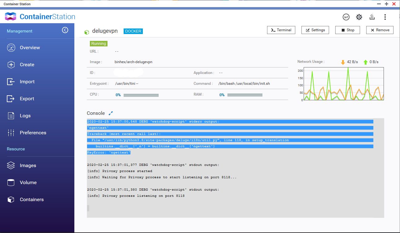

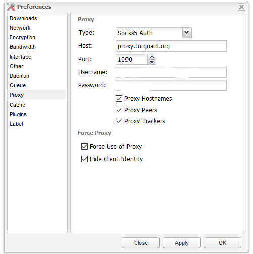

I have a question about my current configuration – I’m not having a issue with connectivity and I’m not overly concerned about speed but more hoping for a definitive answer if I have done enough to keep off the radar of my ISP and away from threating letters.
Currently I’m using:
AirVPN for the Docker container
TORGuard for Socks5 proxy
Image: https://ibb.co/jw31t7D
The WebUI parked behind a Reverse Proxy (apache / Lets encrypt)
The Docker container is on a QNAP NAS and sits behind an ASUS RT-AC5300 router.
When I check my configuration with IPLeak It shows that the IP has been obfuscated, I have also checked with TORGuard to verify the IP has been obfuscated and both tests prove positive that the IP is being changed/masked/obfuscated
The only “Error” in the log that is visible when launching the container is:
Image: https://ibb.co/gwRm8h0
DEBG 'watchdog-script' stderr output:
'ngettext'
Traceback (most recent call last):
  File "/usr/lib/python3.8/site-packages/deluge/i18n/util.py", line 118, in setup_translation
    builtins.__dict__['_n'] = builtins.__dict__['ngettext']
KeyError: 'ngettext'
I have tested some small torrents to verify connectivity and all seems to work just fine. I do take a substantial hit on speed with the layers of security but I would rather be safe and slower than unsecure and shutdown.
My question is how do I prove that I’m secure enough to use this set up full time without bleeding/leaking and getting into trouble. I am aware this solely depends on the sustained connection of the VPN / Socks5 proxy but hypothetically if there were no fear of the VPN dropping how can I test that this setup is a ready to go to work.
Thank you for any comments, help, support and ideas.
- Usual-Noob
Edited by Usual-Noob
added images
