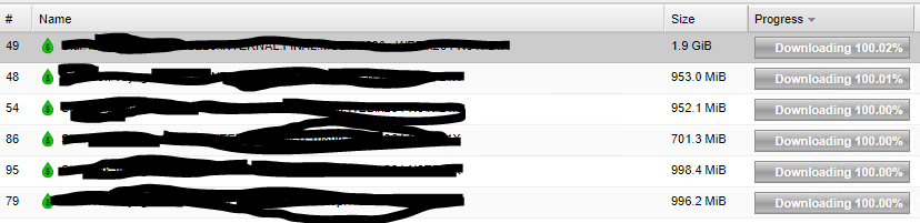

Attached is the screenshot of the deluge settings.
I'm using NORDVpn. If I turn off STRICT_PORT_FORWARD it doesn't change, however if I turn off the VPN in the deluge container then I can connect.
Any ideas?
