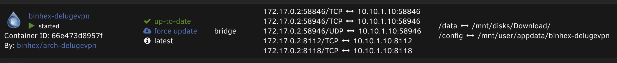

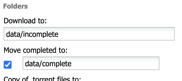

Started having a strange issue out of the blue, the docker seems to no longer be respecting the set /data path, which I've had mapped to an unassigned disk for ever. Now downloads are downloading into the appdata folder for the docker??  Any ideas?
There have been a lot of changes for mount points in the UD plugin recently (especially remote mount points). Are you sure the path you set is still valid?
data is not the same path as /data. Add the leading slash and you should be fine.
Thank you both, A I feel like an idiot removing that leading slash, been fighting with the latest Radarr dockers complaining about the mappings... Well based off the suggestion to look at UD, I found it out dated, updated and all is back to normal!
