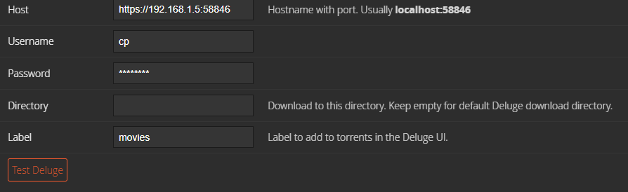

I've been at a loss at trying to get Couch Potato to talk to binhex-delugevpn container.  For the past couple of years, I've been using this container, a variant of binhex's for the longest time but just recently started running into issues and had to abandon this container. The error I'm getting while testing the connection in CouchPotato is "Connection failed. Check logs for details." with the following from the log:
[o.core.downloaders.deluge] Failed to get all torrents: [Errno 104] Connection reset by peer Traceback (most recent call last): File "/app/couchpotato/couchpotato/core/downloaders/deluge.py", line 274, in get_alltorrents self.connect() File "/app/couchpotato/couchpotato/core/downloaders/deluge.py", line 226, in connect self.client.connect() File "/app/couchpotato/libs/deluge_client/client.py", line 78, in connect self._connect() File "/app/couchpotato/libs/deluge_client/client.py", line 92, in _connect self._socket.connect((self.host, self.port)) File "/usr/lib/python2.7/ssl.py", line 864, in connect self._real_connect(addr, False) File "/usr/lib/python2.7/ssl.py", line 855, in _real_connect self.do_handshake() File "/usr/lib/python2.7/ssl.py", line 828, in do_handshake self._sslobj.do_handshake() error: [Errno 104] Connection reset by peer
I've gone through the steps of adding a user to the authentication file as mentioned here and in preferences, set Daemon>Connections to allow remote connections.  I then referenced the new user in the download settings in CouchPotato.image.png.59f26445557de863d0a24088f50a929a.png
Here are some other resources I've referenced:
Any help is appreciated!
