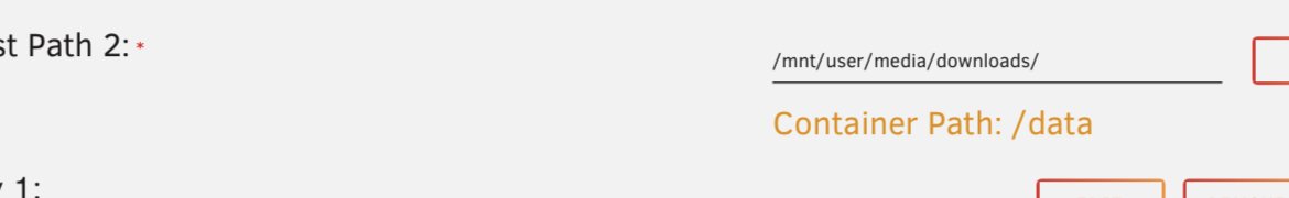

6 minutes ago, ShadyDeth said:
So in the config you have "Host Path 2" set to /mnt/user/media/downloads/ and in deluge you have set like this image.
Yes exactly like that. It’s still downloading to mnt/user/media/downloads not an /incomplete folder in downloads and then it moves them to the app data folder for deluge…
Make a Screenshot from your Host Path set in the docker container settings.
3 minutes ago, Tenno said:
remove the last "/" so it is /mnt/user/media/downloads
didit fix it and also /data/incomplete/completed makes it so the files don’t download at all I found. Only reason they did before is because they were added under /incomplete which still downloads to the …/media/downloads folder. Should I have it set to /downloads/incomplete?

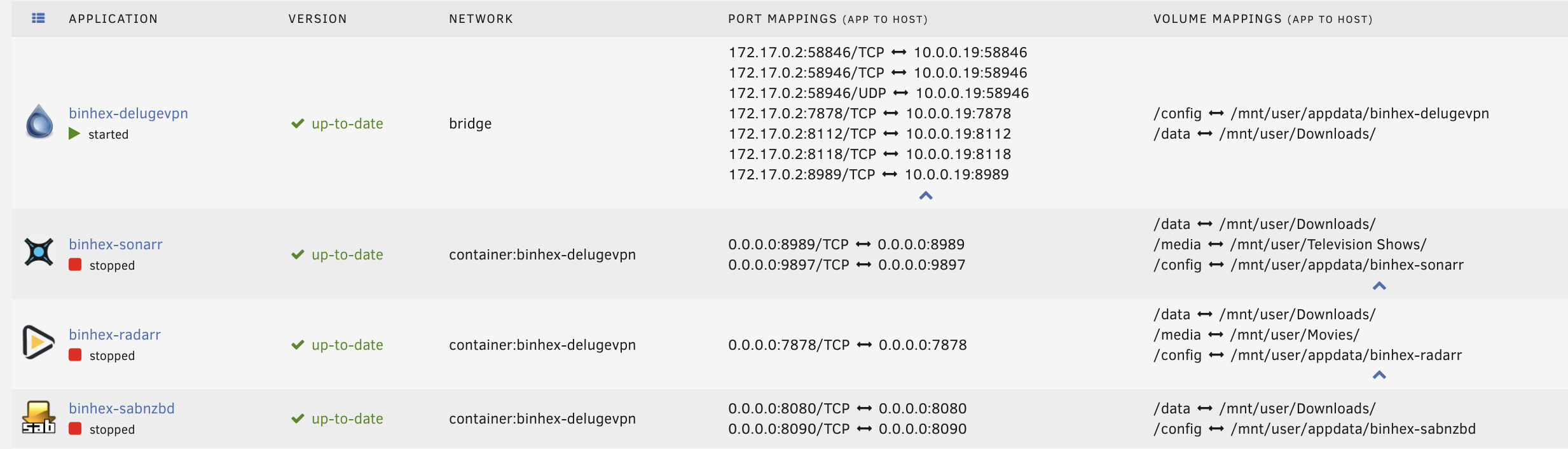

Can't seem to access the Web UI after switching to Wireguard. Using Mullvad as my VPN, and I can't see any errors or anything in my logs. I can connect with VPN disabled. I am accessing the network from a tunneled Wireguard connection into unraid if that matters, and I added the /sbin/modules iptable_mangle from my unraid console to my gofile.  supervisord.log

@binhex how do I access the webui of a Docker that is using the network of -net=container:binhex-delugevpn ?
Edit: I solved with question Q24 from VPN FAQ, all working as needed   https://github.com/binhex/documentation/blob/master/docker/faq/vpn.md

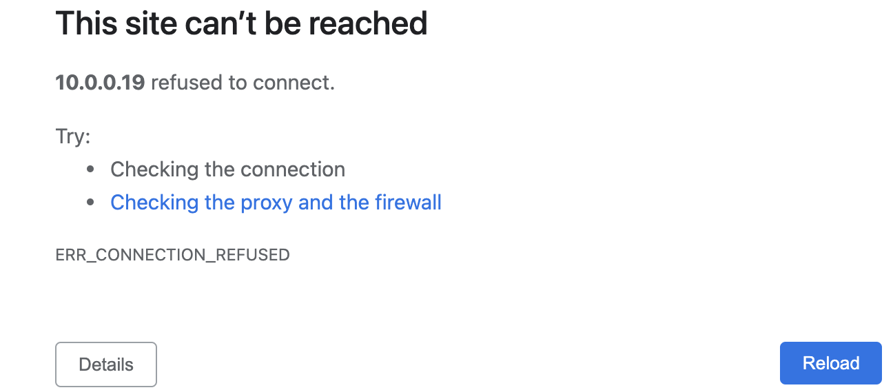

Hi, I am having trouble accessing Deluge webUI (through firefox giving "problem loading page") whether VPN_ENABLED is on or off.
I do not have a proxy and the IP address of the device that I'm trying to access Web UI is 192.168.1.2, an internal IP.
Any help is greatly appreciated.
supervisord.txt
Edited by InerrantEye
no obvious issues there, so i suspect you have misconfigured the LAN_NETWORK, from your log:-
LAN_NETWORK defined as '192.168.1.0/24'
see Q4 :- https://github.com/binhex/documentation/blob/master/docker/faq/vpn.md
edit - if your lan is correct (sounds like it maybe ok from the ip you listed above) then attempt access from another device on your network, also try a different browser to ensure your issue isnt browser related.
Hi, I've recalculated the LAN_NETWORK and still got the same result. I've port forwarded port 8112 and DMZ'd to no luck. I've tried a different device and used 2 other browsers.
Not sure what else to try.
It is a local network, so you don't need port forwarding. Do you maybe have VLAN enabled and your unraid machine is in a different VLAN? Maybe install and try firefox inside unraid from the Apps tab.

I've been trying to get this setup all day, and followed several guides. Can't seem to find a problem, even the log to me looks good and doesnt show any errors, but when I try to launch the webUI it just cant be reached. Could anyone take a look at my settings and see if anything stands out? or point out an error i am missing, or misunderstanding.
Im using Unraid 6.8.2 with the binhex-delugevpn container.
My deluge settings screen can be seen here, and my docker settings here
No matter what I try to do opening the WebUI results in :  "This site can’t be reached, 192.168.2.200 refused to connect."
Can anyone offer any guidance at all? Doesnt seem to work even if I turn off the VPN option either...
Ive added the montreal server, and certs from : https://www.privateinternetaccess.com/openvpn/openvpn.zip

Hi there, a big NOOB here. I have just set up my first UNRAID, and installed binhex (delugevpn, sonarr, radarr, sabnsbd) with the intention of running sonarr/radarr/sab via delugevpn. I followed videos (the most recent ones) from https://www.youtube.com/c/SpaceinvaderOne/
Delugevpn works but regardless of how many times i redo this i can never get sonarr or radarr webUI to run,. I understand it won't be available via the unraid interface and i have to type the IP in (for me an example is 10.0.0.19:7878) however I receive this error
the site can't be reached....
My delugevpn template has been updated and when i download ubintu via torrent it seems to work. I use the curl command to confirm my IP is running via my PIA vpn, but it appears I can't run anything other container through it. I also include a screenshot of (1 - deluge, 2 - Sonarr,)
Any advice or assistance would be great. If I need logs, please let me know specifically what i need and where from and I will upload them.
Cheers!
Cheers!

Your containers for Sonarr, Radarr & sabnzbd are showing as stopped? Are they failing to start?
